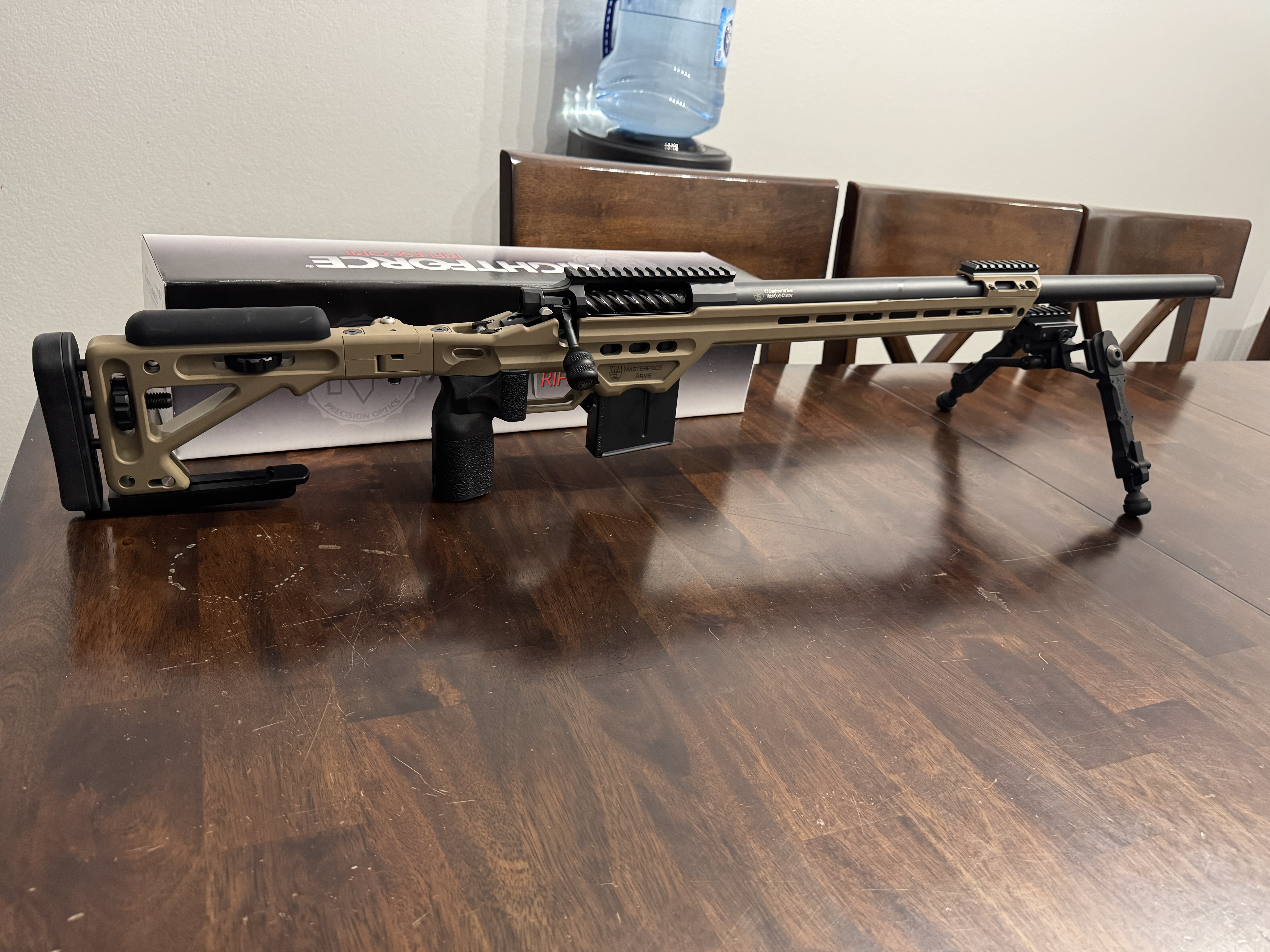

Got a new MPA BA PMR PRO II in 6.5 Creedmoor with a 26" barrel coming in a couple days and I'm looking for some ammo to start with.
Thoughts?
Hornady 140G ELD-M $1.70 a round
Federal Gold Metal Berger 140G $1.67 a round
Federal Gold Metal SMK 140G $1.55 a round
I'd prefer just buy a bunch of ammo to save on shipping and call it a day is there a consensus on what would be best?
Thanks!

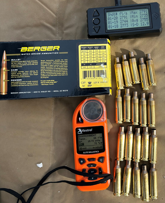

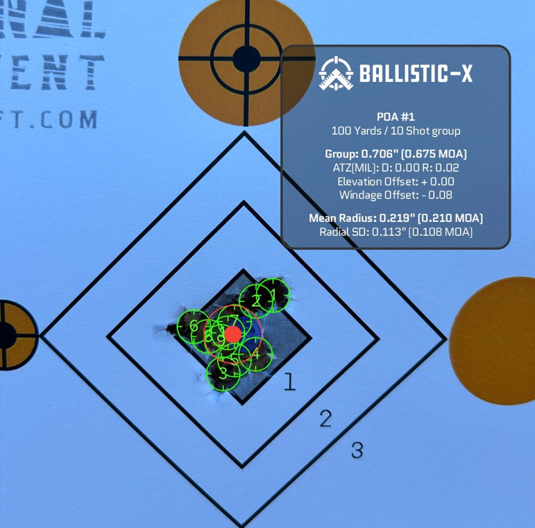

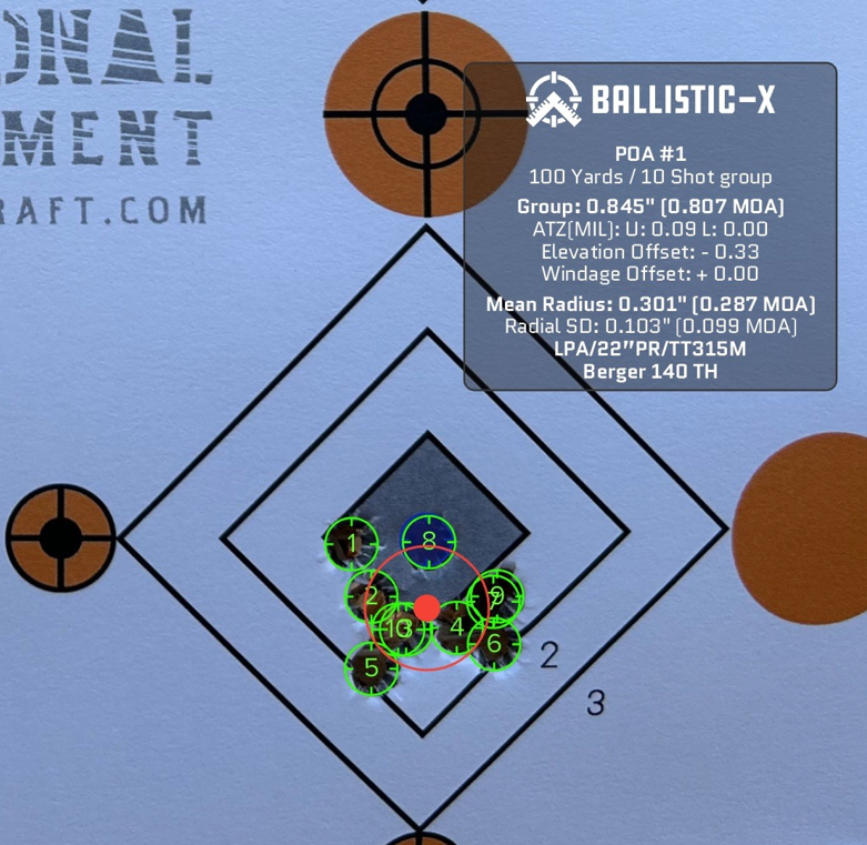

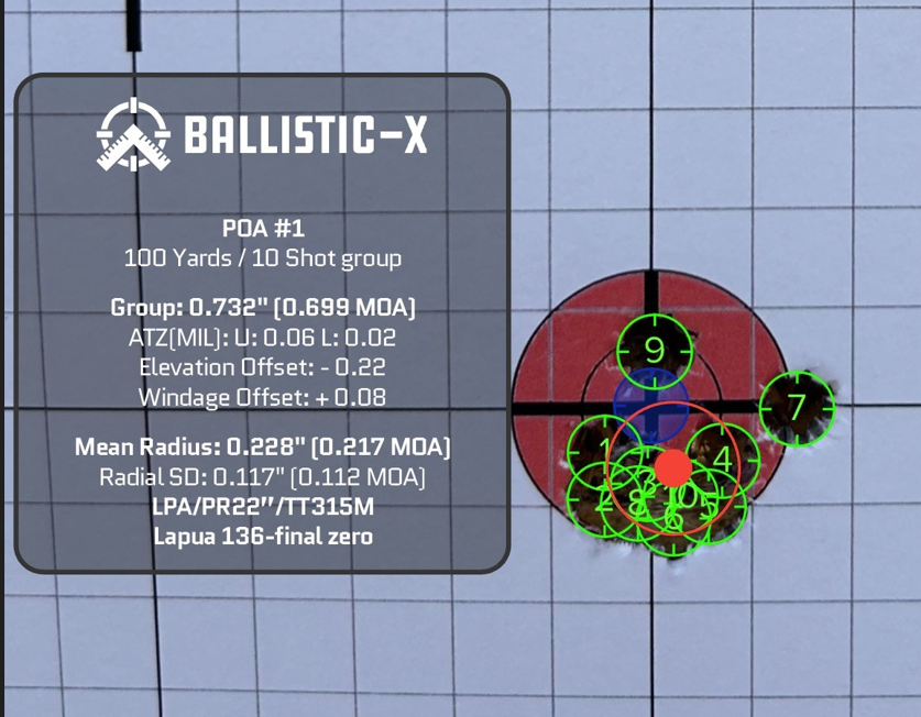

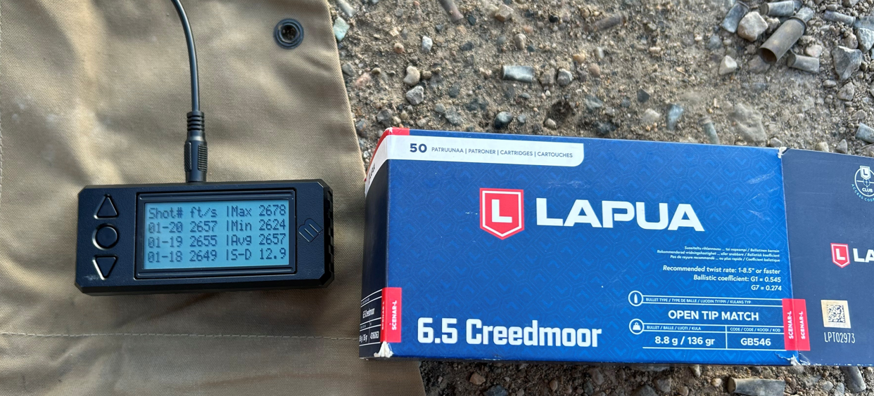

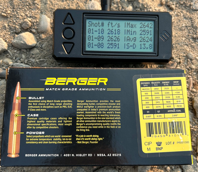

In my experience, factory Hornady used to be the easy button, and I've previously bought 1,000+ rounds of factory Hornady ammo even before receiving a barrel because I knew it would just work. But post covid, my experience with Hornady white box factory ammo is that precision is sub-par and SDs are pretty big (20-30 fps) for 6 and 6.5 CM. Hornady Black and Hunter has been better for me more recently. Federal Gold loaded Bergers and SMK tend to be more precise and have about half as large of SDs (10-15 fps). Berger loaded ammo has been a mixed bag for me. Sierra competition has been good in 6CM but VERY slow in 6.5CM. Norma hasn't been good in any of my 6 or 6.5 CM barrels, but it's cheap. Nosler, Black Hills, Sig, and HSM has been bad too. Lapua loaded 136 scenars have been good out of multiple barrels.

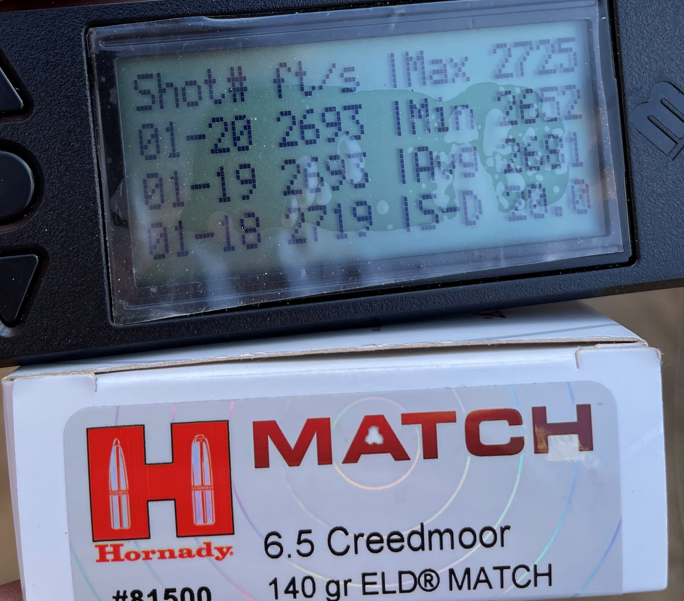

Never got any 20-30 SDs with Hornady 140 ELD ammo even during and after covid. The worse I got is in the 12-15fps over 20 shots.
Yeah, I'm averaging 15 over a quite large data set collected over the last 3-4 years.
Wow, you guys have unicorn dust it seems like. With numbers like that, I wouldn't mind just outright using factory ammo and stop reloading altogether.
I may have to try a box just to see but I can almost guarantee it's gonna have crazy numbers.

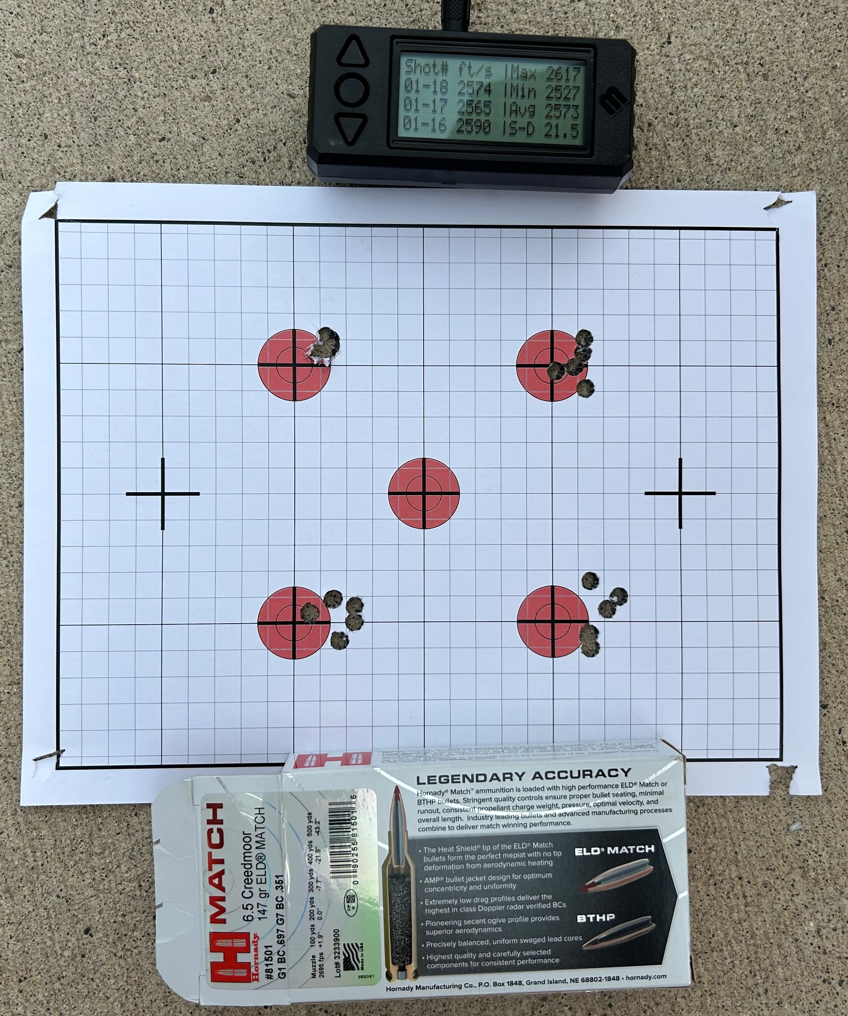

Last 2 boxes of white box Hornady that I've tried in 6.5CM.
Compared to
Berger in Barrel #1
Berger in barrel #2
Lapua in Barrel #1
Lapua in barrel #2
Obviously lot variations, variations in barrels, blah blah blah. I've also had single digit 20-shot SDs from Hornady black and ELDX. SDs are only one thing to consider, as is BC, as is avg MV, and avg precision, and temp sensitivity (spoiler, berger ammo is pretty temp sensitive IME), etc. OP should try out a few to see what works best for him.

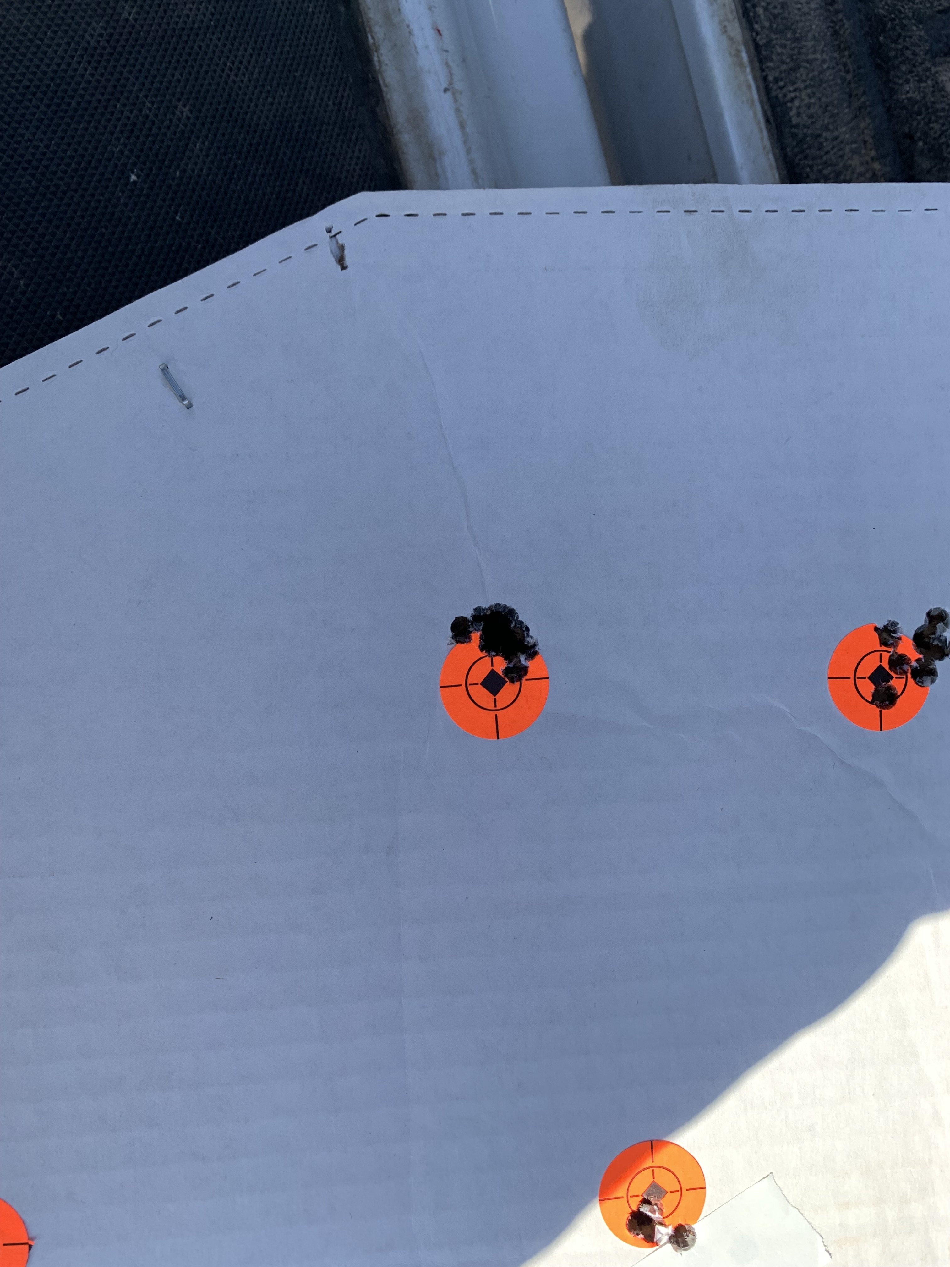

For shits and gigs I took the 6.5 out with some factory hornady American Gunnef 140 hpbt. It's the one that comes in the big black plastic boxes in 200 round quantities.
While it was only 10 shots, I gotta say I'm still a bit surprised. The numbers were good and the group was fairly small.
Group is on the top left.
Both my 6.5cm gasser and Origin/proof build shoot 140gr AG way better than they should. 140gr ELDM edges it out, but not by mutch.
