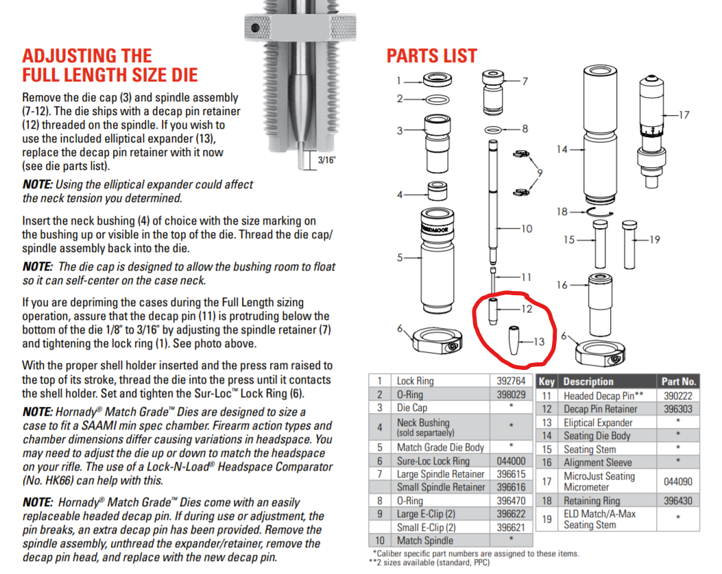

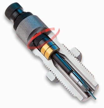

If you removed the whole decapping rod/button sizing mandrel, & forgot to throw the black lock nut that secures the decapping rod to the stem back into the top of the stem, so it could serve as a space occupier, whereby it sits on top of the bushing, you may’ve gotten only a fraction of the neck resized by the bushing. If that lock nut isn’t there, there’s nothing to prevent the bushing inside the stem from raising up, even if the stem was tightened all the way down. That could potentially account for the loose bullet fit.
Reactions: Baron23 and rady
If you removed the whole decapping rod/button sizing mandrel, & forgot to throw the black lock nut that secures the decapping rod to the stem back into the top of the stem, so it could serve as a space occupier, whereby it sits on top of the bushing, you may’ve gotten only a fraction of the neck resized by the bushing. If that lock nut isn’t there, there’s nothing to prevent the bushing inside the stem from raising up, even if the stem was tightened all the way down. That could potentially account for the loose bullet fit. View attachment 7648182
This may explain what you are seeing. I've also read where the top locking ring and knurled spindle body can allow a small amount (1/4 to1/2 turn) of bushing float in redding s type dies. Not sure how your Hornady dies are set up. If there isn't a lock nut for your spindle, then you may be able to adjust the spindle to allow for the bushing to achieve close to full neck sizing. It could be something as simple as adjusting that spindle down. Worth trying as opposed to buying additional bushings.
Sounds like the hornady dies are set up a little different than the dies you are referencing.
I was unclear in my previous posts. I am using the dies with the decap pin retainer (part 12 in image below) instead if the expander (part 13 in image below).

On a separate note, do most use the bushing dies without the expander stem installed?

By the way, I do have the expander in the Redding Type S neck sizing die, and it does NOT result in "undoing" the .290" OD created by the bushing. On GOOD brass (like the Lapua), the expander does NOT make the OD larger UNLESS that is required in order to correct a too small neck ID and / or non-concentric neck ID, created by inconsistent non-concentric neck wall thickness. Sure, in this case, yes, the .290" OD would be violated, bu that's better than a too small ID or non-concentric ID.

I use a Redding Type-S Bushing Die to size-down (decapping pin/expander ball removed), and then a 21st Century Expander Mandrel to size back up to the proper neck tension. The .2645 mandrel is giving me solid results in 6.5-CM. Oh ... and I anneal after every firing to ensure good brass elasticity.

I run fls with expanders sanded to yield - 0.004 on average.
Then everything gets the Sinclair mandrell - 0.002 treatment.
As long as you don't have a neck turn chamber situation every piece of brass is consistant.

I think he misspoke. If you run a .2645” mandrel through a 6.5 neck you will not have enough grip on the bullet. I don’t think anyone makes a .2645” mandrel. The biggest expander I am aware of is RCBS (meant for oversized lead projectiles) which mics .2640”
21st does. If you buy one of their Sets you get the following:
"Our caliber specific expander mandrels are available in .0005” increments in calibers 22 to 338 and will range from .001” above bullet diameter to at least .003” below bullet diameter depending on caliber."
But they also make a 0.2645 mandrel, if you so desire, and many other in-between mandrels. I can see why so many like the 21st stuff.
