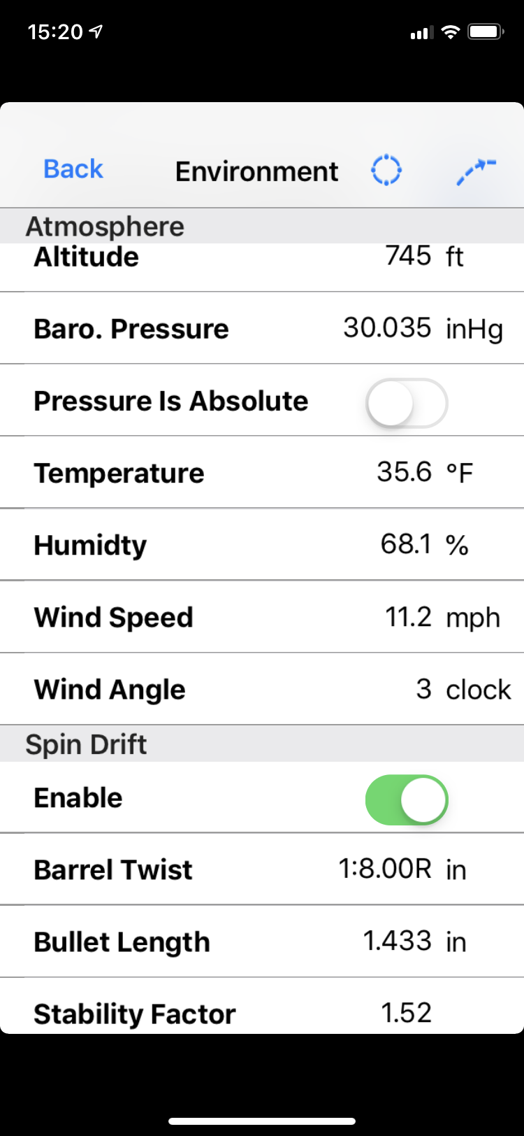

Temperature/Density Altitude is the big problem here. At 0 ft ASL (and with the humidity here, that’s not a stretch for DA and might even be conservative), the Berger calculator tells me I’d need 2950 fps to get full stability at 32F. If I saw above 2600 it would be good improvement from my first results out of a new barrel...obviously, 2950 isn’t in the cards. However, at 72F, the 147 ELD-M stabilizes at modest/obtainable MV.

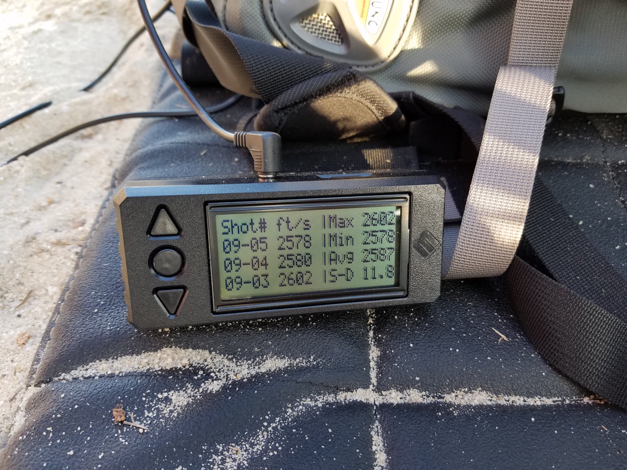

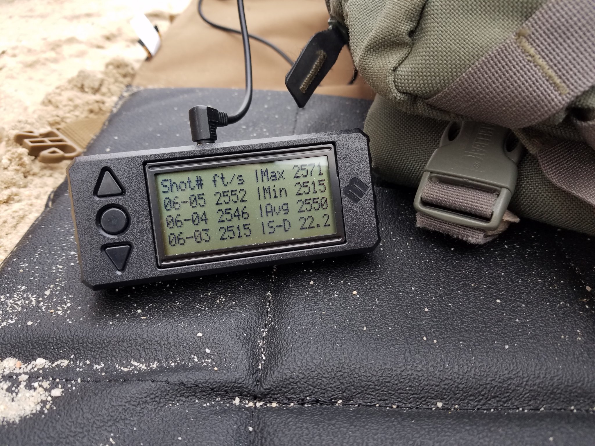

As to pushing the 140 ELD-M faster...maybe so, but the advantage it enjoys isn’t meaningful when loaded by the factory. When I get a chance, I’ll edit in my chrono data and the theory crafting I did in the Hornady 4DOF calculator.
The 2550 is a 40 deg day, the 2587 is a 65 deg day and a warmer barrel, if that's of interest.
