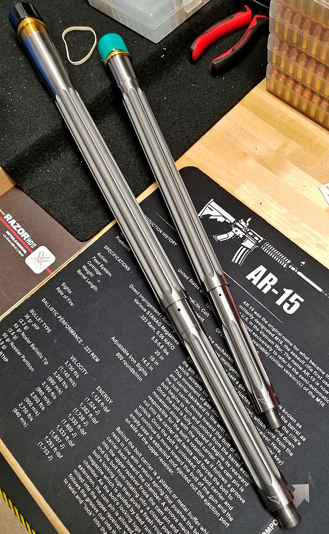

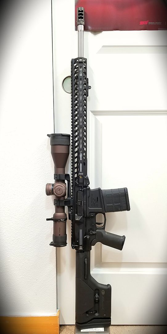

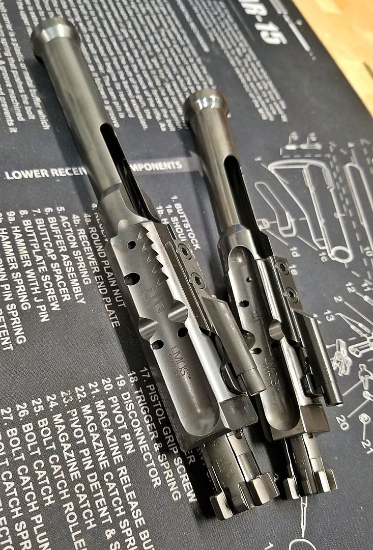

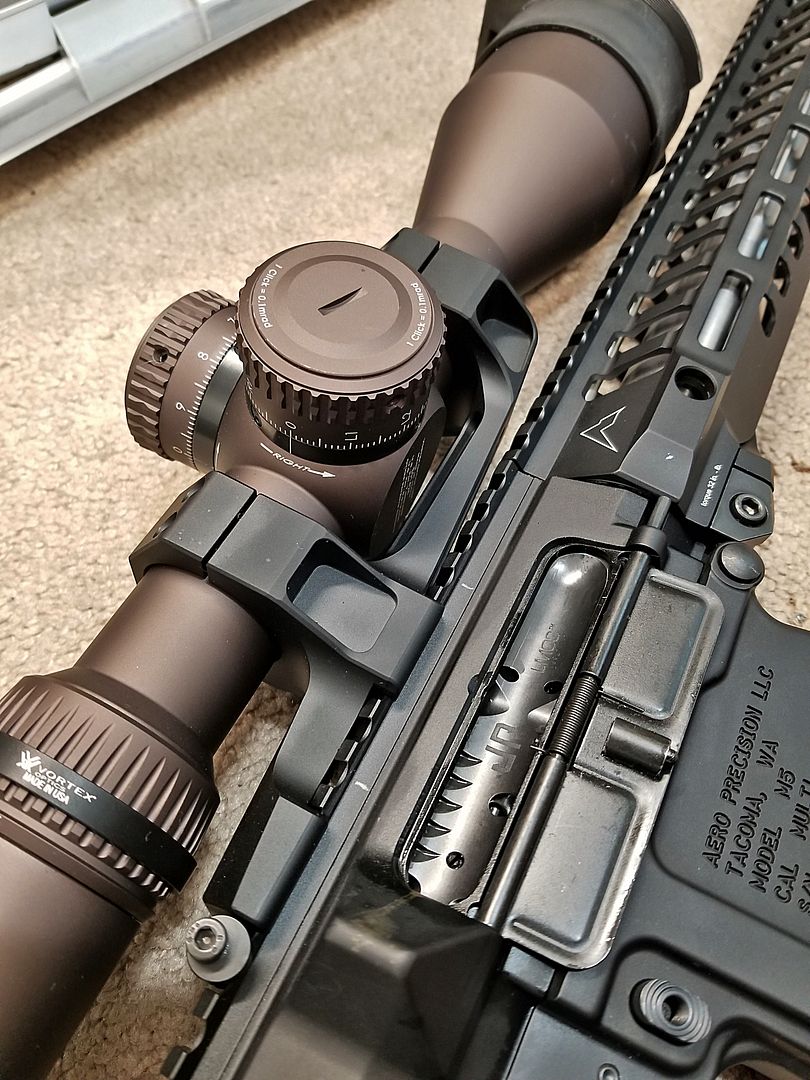

What slowly started and was planned "budget" build..... quickly got out of control and into full on awesome build. I just love good parts. :D:D:D
It all started with Aero Precision M5E1 upper and lower set. These guys are local to me and I like to support local business. These receivers are beautiful! .... and here is a rest of the build.
Rainier Arms UltraMatch Mod2 Fluted 22” +2 Rifle Gas 6.5CM
Rainier Arms Switch M-Lok 17” Rail
Rainier Arms Avalanche Mod2 Large Frame Charging Handle
APA Little Bastard 6.5 Brake
Superlative Arms ADJ Gas Block .875
JP Enterprises LMOS Large Frame BCG with HP Enhanced Bolt
JP Enterprises Gen 2 AR-10 SCS Builder Kit with Spring Pack
Aero Precision M5E1 Upper/Lower Receiver Set
Battle Arms Safety Selector Switch
Magpul PRS Gen 2 Stock
Magpul MOE+ K2 Grip
Giessele SD-E Two Stage Trigger
Vortex Razor Gen II 4.5-27x56 EBR-2C MRAD
Vortex Precision Extended Cantilever 34mm 20 MOA Scope Mount
Spent a day at the range and rifle shoots beautiful and has great potential. Hornady American Gunner 140gr turned in about 3/4-1 MOA (not very impressive, but will do for a cheap ammo and steel banging at distance) and 41.8gr of H4350 under 140gr ELD-m at 2.800 .060 jump to lands turned in 1/2 MOA group and with little more load tweaking and time behind a rifle I have no doubt it will be under 1/2 moa all day long.
This weekend it will be going with me to Parma ID Multigun Team Match with targets out to 1000yards. Cant wait to stretch her legs.
Here is couple quick pics.
20180905_172932.jpg~original
20180826_004139.jpg~original
20180827_105652.jpg~original
20180905_172505.jpg~original
Reactions: beaverpelt
