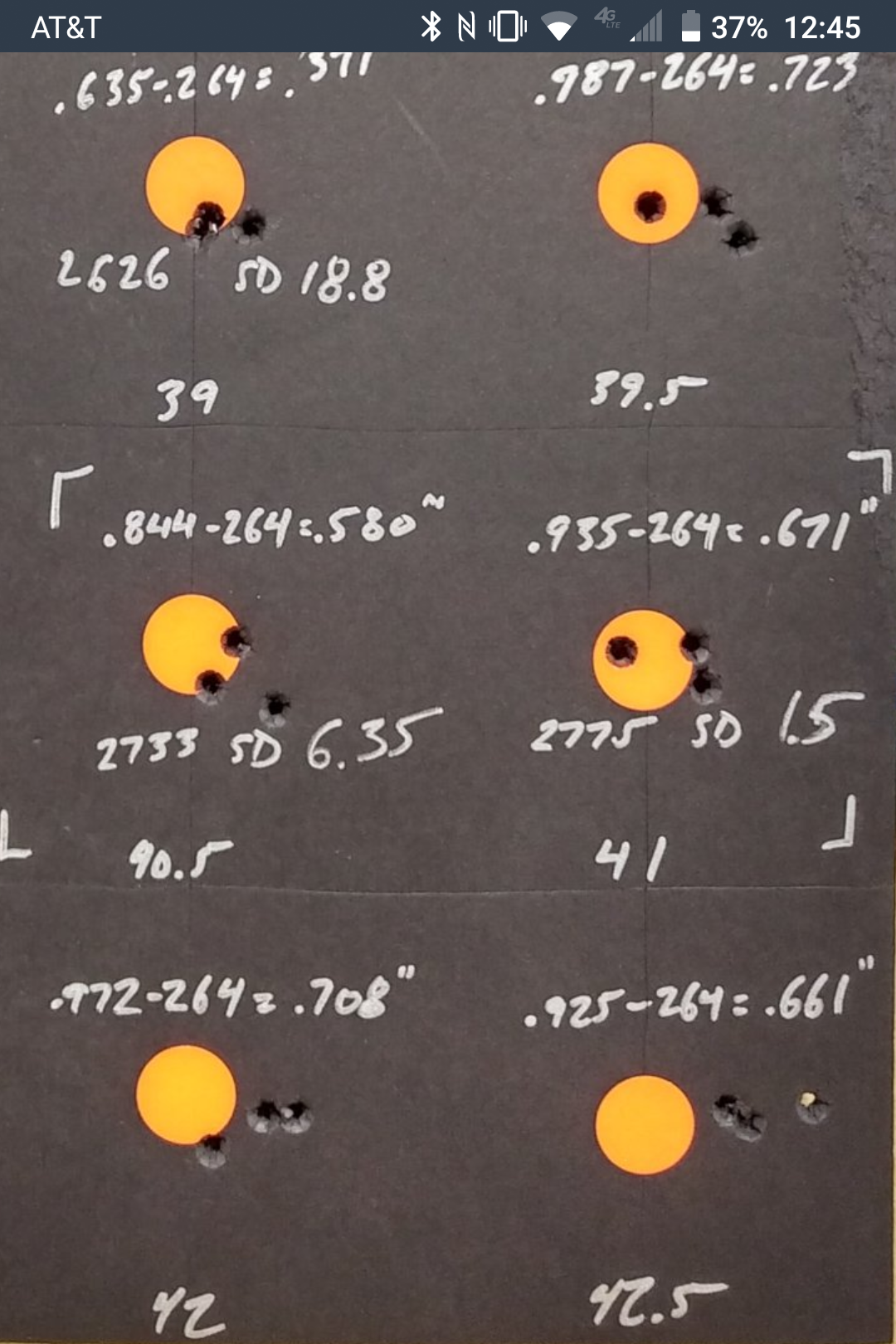

There are several variables: are you using same lot of bullets. Even my 140 elds can vary lot to lot. Are u chasing the lans. Throat might have some erosion. Also there’s much better brass and primers.

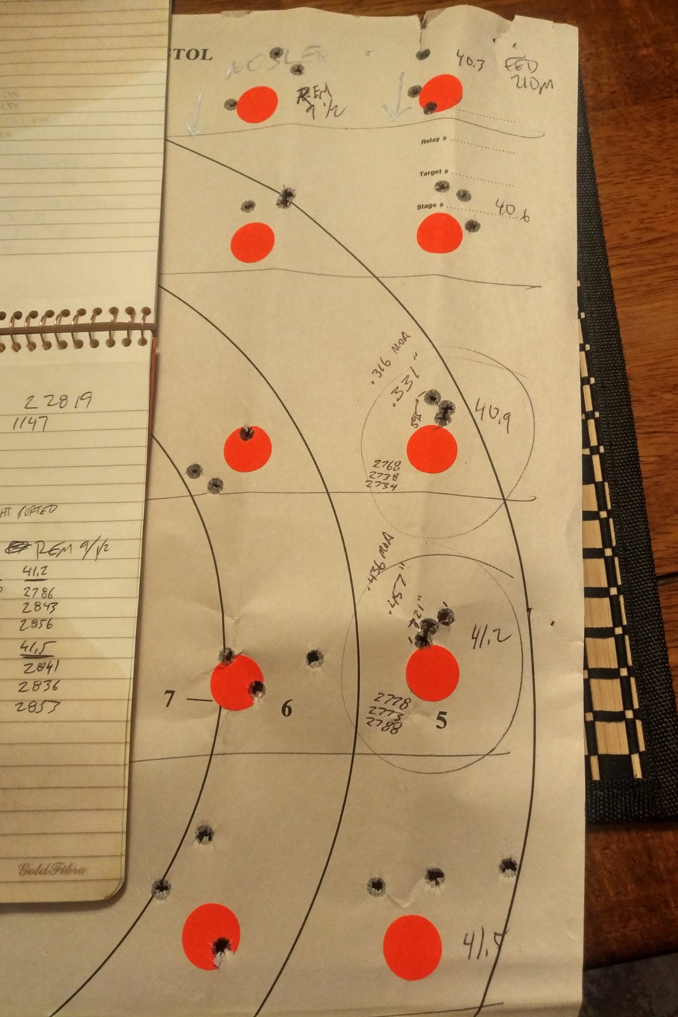

Primer change..... Makes a HUGE difference sometimes.
Same brass, same bullet, same charge, different primer:
Remington 9 1/2 on left column, Federal 210M right column
7034763
Thanks for all the info y’all. I think I’ll mess with the primers, prolly switch back to the cci br’s. Also, I’m going to try some Berger 130 hybrids with h4350 and see what THAT load gets me. If I can’t get anything to tighten up, I’ll shoot the piss out of the gun to get trigger time out to 600 (longest range I have regular access too), while I’m saving up for a Bartlein and smith fees.

Depending on velocity you go between 39.6 and 42 in .2 grain increments. You'll very likely find 2-3 loads your rifle likes.

Wasn’t sure where to post this.... but figured this wouldn’t be a bad spot...
So 6-9 months ago I picked up my first bolt gun (Howa bravo in 6.5cm w 26” bbl). Took it to the range with some Hornady American Gunner 140’s, and shot .5-.75 moa. I was happy with the groups and the rifle, but decided to reload for it to see what I could wring out of it.
At the time, h4350 was nowhere to be found in my area, so I looked around and decided I would try Reloder 26 with some 143 ELD-X’s. Average groups were sub half moa, with a best of sub .25 moa. Fast forward to now, roughly 1000 rounds later, and I’m seeing mostly .75 moa with a best of .5 moa.
My question: Has anyone here reloaded with RL26 and noticed significantly short(er) barrel life?
I have since switched to h4350 w/ the 143’s, and those groups don’t seem to be any better, although the SD and ES are better.
I may be a little freaked out about nothing, and if that’s the case let me know. I’d just like to put a plan together if something is wrong. I’m planning on having a gunsmith check out the barrel and let me know what he thinks, but I’d be interested to hear y’alls experiences with RL26.

When I am doing load dev, I usually run everything over the Magnetospeed and look for the nodes as well as the pressure signs.
After I find the node then I load to verify node.
Then to refine accuracy I adjust jump to improve precision.
So I went to the range today with the 130 Berger Hybrid/H4350 loads to see what the deal was with those. I still plan on loading up the 143 ELDX/RL26 loads and retesting those.... but I may not need to.
The results:
Called fliers will be pointed out. I will include group sizes with and without fliers.
41.5 and 41.8 were fired into the same target, because I’m a dumb ass, so they are both in 1 x 10 shot group.
130 Berger Hybrid OTM
H4350
Starline brass
Fed AR-M primers
2.820” COAL
Powder weight / velocity / group size
40.6 / 2659 / .683”
40.9 / 2713 / .436”
41.2 / 2722 / .659”
41.5 / 2751 / .779” (.568” w/o flier)
41.8 / 2755 / .779” (.568” w/o flier)
42.1 / 2768 / .585”
42.4 / 2792 / .806” (.296” w/o flier)
42.7 / 2795 / .948” (.353” w/o flier)
43.0 / 2853 / .704” (.551” w/o flier)
I know, I know, those are a lot of fliers. There’s some stuff that I need to tighten up on my end, and I def. need to stop shooting next to doods with brakes when I’m shooting for groups.
Excuses aside, what are y’alls thoughts?
Should hit the range later this week or next week with the RL26, and will post results then.

What temp was it and did you see any pressure signs? Id prolly load 42.5 and play with seating depth.
59 degrees
No pressure signs at all on any of the loads.
I was thinking of loading 10 each from 42.4-42.7. Shoot 5 each for groups, and 5 each for speedo data.
Your take on it may be better though. Less time chasing the dragon, more time shooting something you know will work.
Would you bother messing with anything over 43, or stay in the 42.5 range being that the speed is near 2800 with good accuracy?
If it was me, I would load some up at 20 thou off and shoot a couple groups at 300 yds. If they group, then i would chrono them. Velocity is the last thing I worry about.
Damn, then I would shoot what you can at 300 for group. The hybrids can take some jump as well. Im a Hornady fan but the 130 berger is a fantastic projo.

I would not about above your 2800 FPS node. That is a typical node and looks like you are right there. My next step would be to clarify and refine the node, which is what you are doing. Then refine the precision with adjusting jump.
Happy Loading
