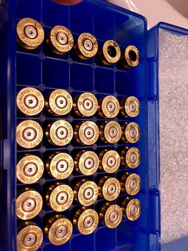

Ok guys I'm having a problem with my newly built 6.5 Creedmoor gasser. Little info on it, 22" Bartlein w/ +2 gas, SLR AGB, JP High Pressure Bolt, JP SCS Heavy. On my first string (3-5 rounds) of my range trip the last 2 times I have went I am getting a blown primer on one round on that string (assuming round #1). Also every round has slight swipe marks, this is on every round not just the first string of rounds. I am shooting Prime 6.5 Creedmoor. I built this with the +2 gas and JP HP bolt hoping to avoid this as I am planning on reloading. Thoughts?

Sounds like pressure could be the culprit. Are the non blown primers flattened? pics of brass?
Regardless; swipes and blown primers usually means pressure problems. Pics would tell a little more of the story.

I’ll gets some pics posted today, I’ve tried the Norma Ammo which was my break in ammo and it did the same thing. I’ve also got a some rounds from Cooper Creek using Alpha Munitions brass. These are getting primer swipes as well. If I remember right on break in I had a blown primer or 2 with the Norma. Craddock Precision cut my chamber. I’ve got a Hornady COAL gauge, I’ll measure today and post what length my chamber is cut to. Thanks!!

Left hand side is the Prime. Grouped rounds are from Copper Creek they get “hotter” from left to right. My OAL measured 2.835” with a 130gr Norma Golden Target. 2.832” with the Berger 130gr AR Hybrid which is what was shot out of the Alpha brass

You are going to get some case head swipes with a large frame semi. Minimizing it with proper gas tuning and buffer weight/spring is key. Prime is known to be very hot and that is evident in the brass pics you posted above. The brass on the right (CC Alpha) likes normal for a semi. Your best bet is to handload if you really want to minimize those swipes. While the 140 Amax / ELD-M shoot great in my rifle, I get more swipe with them. The sweet spot is 123 Scenars, 130 AR Hybrids and 130 ELD-M's. I love the 130 ELD-M's because they are the cheapest of the bunch, have a good BC and are extremely accurate. Im also shooting Hornady brass which is thinner than the brass you are shooting. And if you had a case get stuck it sounds like your chamber was not cut with a reamer favoring a semi meaning its tight.
