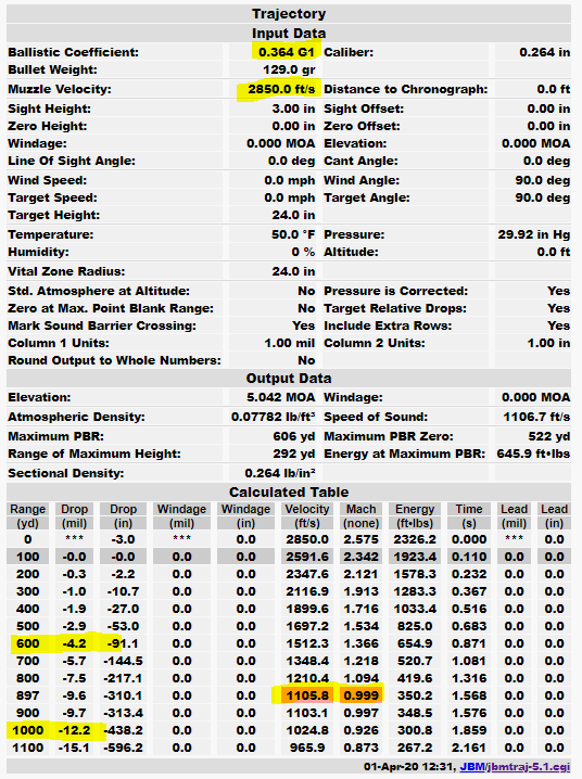

So I decided to check Hornady's solver and played with JBM. (Looking to match up 600yds = 4.2 and 1000 yds = 12.1)
This is n't too far off using the chronograph speed and the standard bullet information. 600 lines right up.
This tells me 12.1 is not out of the question for 1000yd drop. @Skookum - Would you agree its feasible?
Playing with the BC to true 1000yds, then Velocity for 600, then BC for 1000, then velocity for 600 (rinse and repeat 13 times) to get this:
Final BC is 0.364 and final Velocity is 2850
This tells me the Hornady app is doing this pretty well. No reason to 2nd guess it.
I am very surprised to be getting about the same data as Hornady and the BC has to drop this low. (believe the bullet...)
Plus I am seeing this is dropping into the transonic and sub sonic range (879yds). Maybe that is what's giving me weird results too.

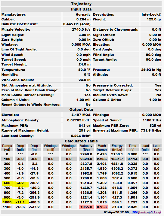

Forgive the dumb question, but is this an 129 SST, or 129 Interlock? You used the interlock name and interlock BC of G1 .445 in your JBM sheet above, but said SST in the OP.
The speed and BC (G1 .445) for the interlock almost matches the drop you are seeing, while getting the 129 SST to match requires a 25% BC reduction.
I just can't see anyway to justify that. You would literally need to shed the polymer tip in flight to make the SST perform that badly, maybe not even then.
The 129 Interlock using your numbers needs 11.5 mils according to Strelok.

Thanks for pointing that out. My original post is incorrect. The JBM information is correct. Below if the bullet he is using. 129 Interlock. Its more on the hunting side than the long range side.
From Hornday website -
This is still a 20% reduction.
Do you think the its possible the bullet is slowing down to a tran-sonic flight that is giving the 12.1 result and this much reduction on BC?

In Strelok, you get the multi-BC option to adjust BC's as the velocity slows. So you basically get to do your own BC banding.
I typically allow for a 5% decrease in BC once the velocity drops below 1900-2000fps with boat tail bullets. This about 25% velocity loss from the muzzle velocity.
For flat base bullets like the 129 Interlock, I typically double the BC loss to 10% and start that BC once the bullet drops 20% in velocity because of course faster velocity loss also means sooner velocity loss ...so in this case I would start at 2200fps.
So I used G1 .445 BC from 2741-2200fps, and G1 .400 BC from 2200-0fps.
Doing this, I get 4.4mils at 600 yards and 12mils at 1014 yards with your combo.
This is very close to what you are seeing.
Edit: even using the original 2000fps you get 4.4mils at 600 yards and 11.9 at 1014 yards.
