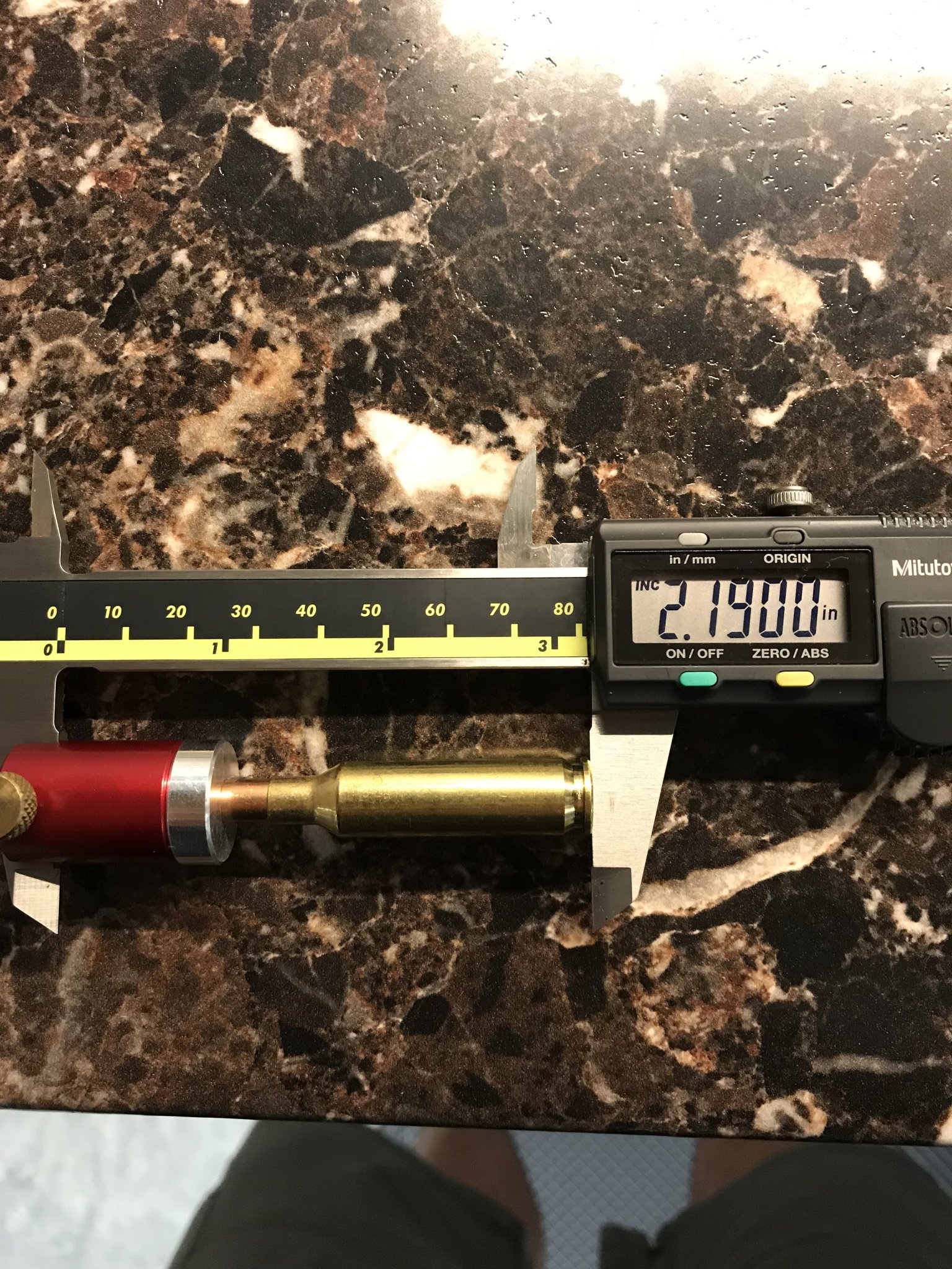

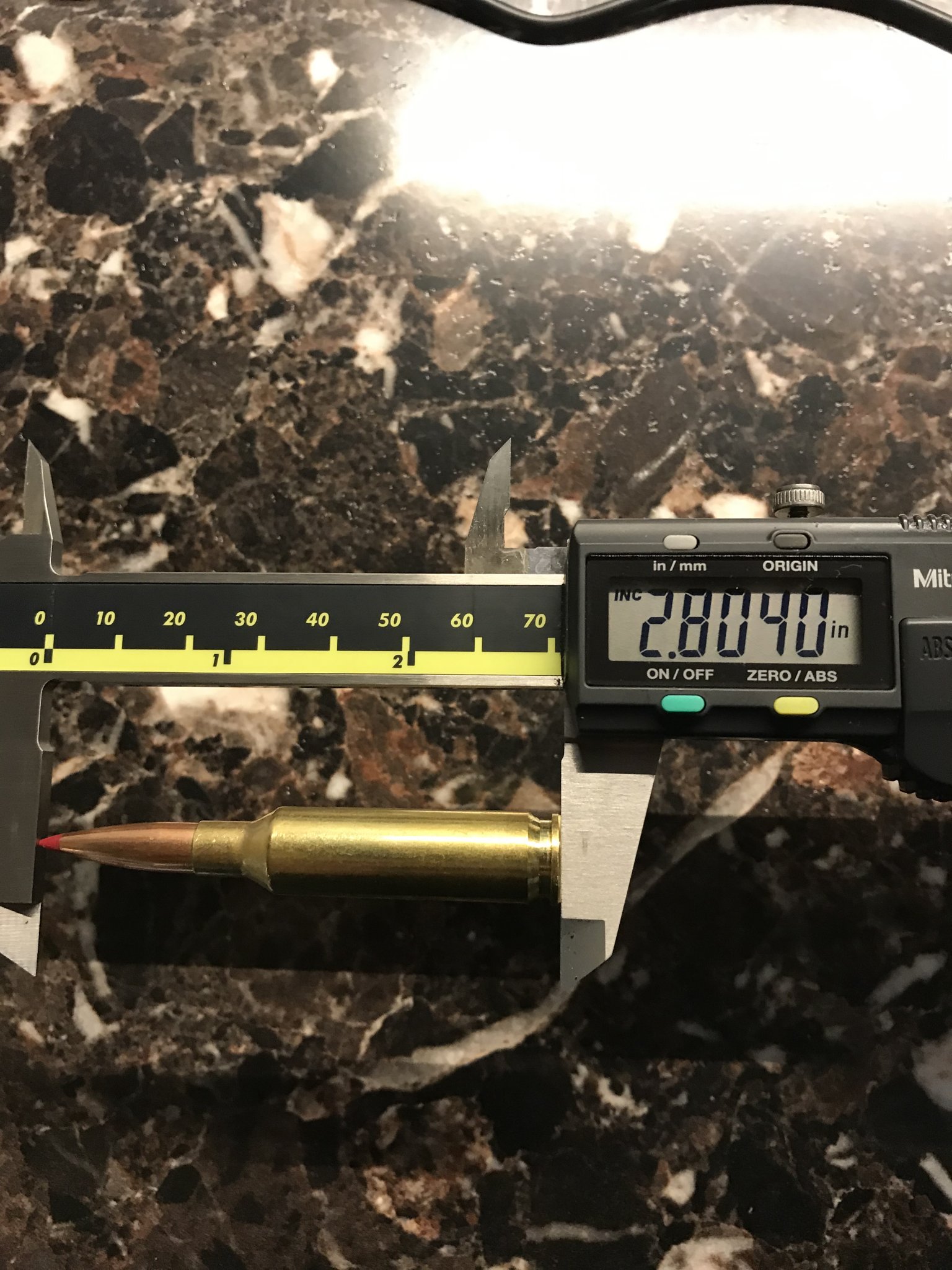

Here is the CBTO and the COAL of the 140 ELD-M.

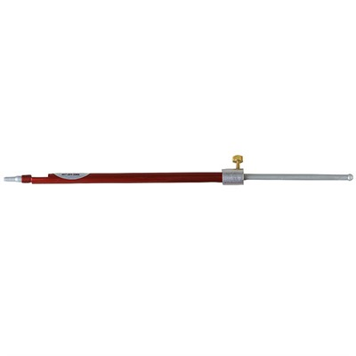

Like you said, every rifle is different, even between various RPR's. Heres a way to measure you COL without a comparator, if you don't wanna use one. It's worked well for me through the years, though a comparator is a lot easier.
IMO - I believe the method above to find the landes and then measuring the base-to-ogive with a (Hornady) comparator lends itself to a higher level of consistency (or accuracy???). When using just the (Hornady) comparator you push the special cartridge case until the special cartridge case shoulder is stopped by the chamber's shoulder. There probably is a small space between the base of the special cartridge case and where the bolt face would have been, resulting in a shorter measurement (.0005-.002). Turning a fired case into a special cartridge case for a comparator may improve (?) the accuracy of the measurement but springback of the brass still introduces a degree of inaccuracy because of measurements impacted (?) by the shoulder locations. If I competed or did ELR shooting/hunting I would use the first method I mentioned.

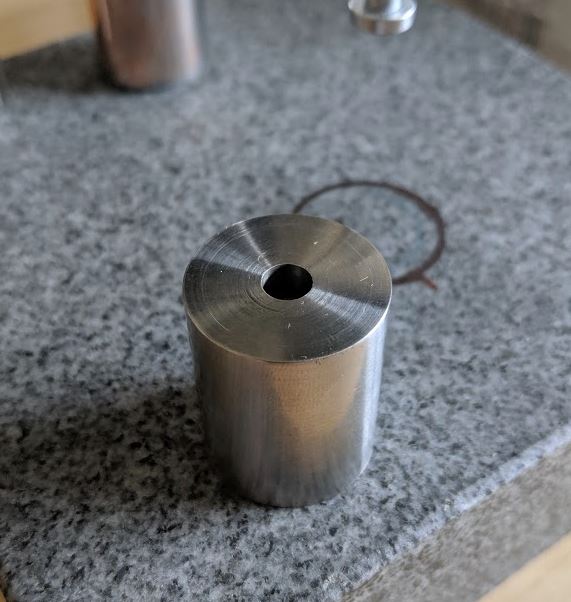

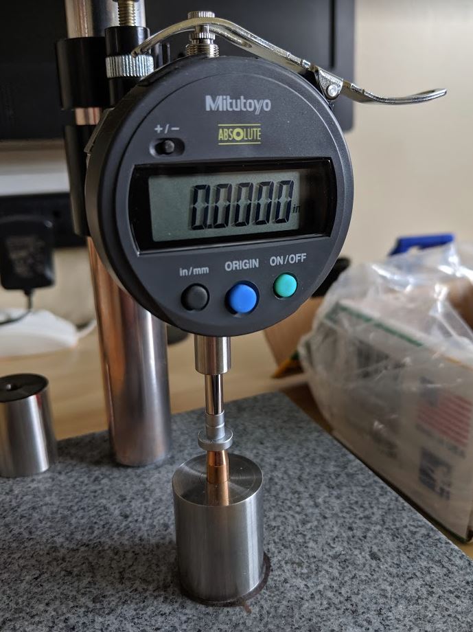

Not all cases, or in this case modified cases, have the same dimension from base to shoulder datum line, and not all bullets, even from the same lot, have the same base to ogive dimension either. Not all comparators are going to measure the ogive at the same spot on the bullets as well. So when you take the reading with a specific modified case, bullet, comparator, and barrel, it’s a measurement that is unique to what you used to measure it with.

I have a jag that is cut flat on the face (no tip). I slide that jag on a rod down the bore on a closed bolt and put a ring of tape on the muzzle end. Then use a bullet (usually with a case behind it just so I can touch/move the bullet) and can push back and forth between the case and the rod to find where the bullet just touches the rifling, then ring another piece of tape around the rod on the muzzle.
Measure from tape ring to tape ring. That gives COAL for THAT bullet to touch lands. Seat to that COAL and measure ogive for head-to-ogive dimension. Method is probably +/- .005ish. I usually subtract .025 from my COAL and run with it.
