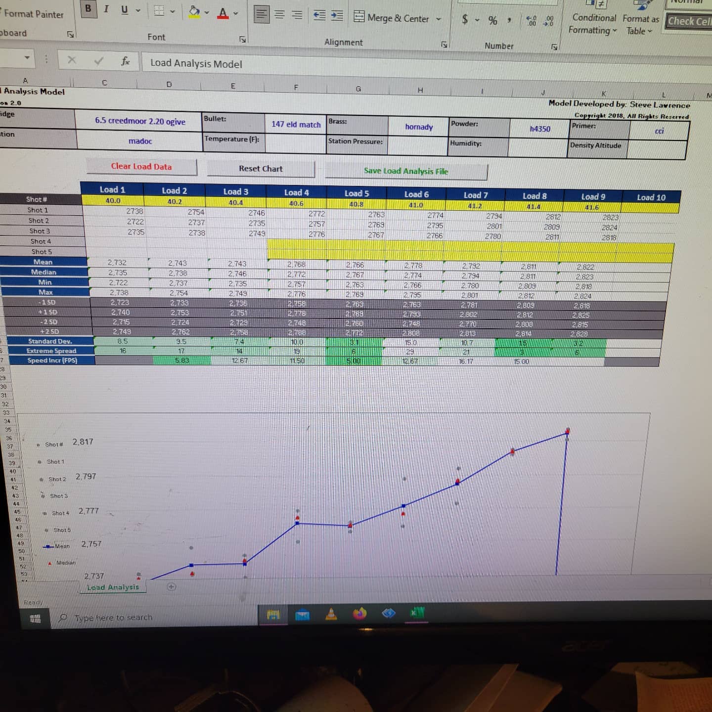

heres a quick question for you all been working up a load for my 147eld match 6.5 creedmoor been using my copy of hornady reloading for it. h4350 powder federal match primers and starline brass. the book says 40.3grains max load at 2600 ftp but when i look at hodgons site it say 41.8grains at 2680 ftp. which ones would you guys use. i'am thinking more of the hodgons site but not sure
thanks for the help in advance
Start low and work up, watching for pressure signs. Nobody will be able to tell you what load is plug and play with your setup.
One thing to keep in mind, I know starlines 223 has less case capacity that other brands. Not sure if that's the case in 6.5 as well.
Reactions: Baron23
he goes up to 42. something I am sure you could go faster if that is what you wanted but his results will vary from yours there are tons of video's showing different people running the 147gr bullet best of luck finding results you like in your gun .

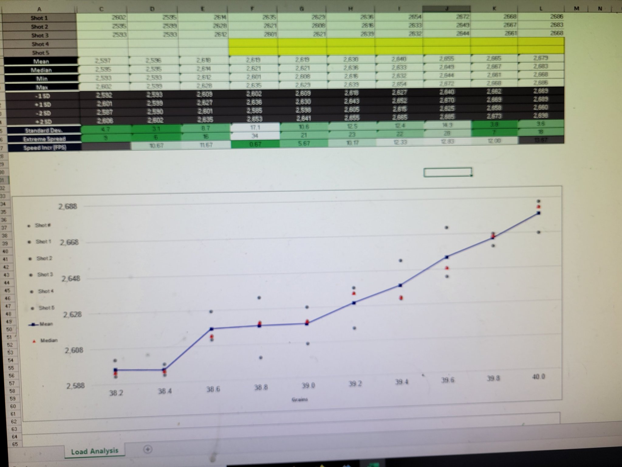

this is what i have so far. trying to get it to around 2700 number if i can
It all depends on your particular set of variables: chamber size, freebore length, powder burning rate, primer, etc. Some people are able to load a lot more powder without pressure signs. Others blow primers with lesser loads. You have to understand how your rifle behaves.

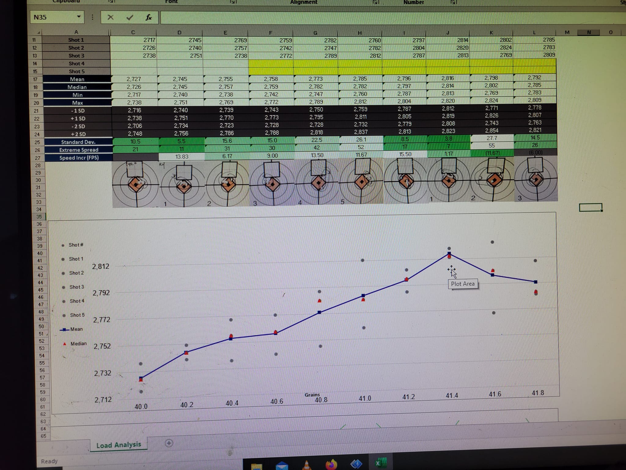

well i settled on 41.4gr of h4350. 2812 average. so i'am going with that. 147 grain eld match IBI 26 inch barrel
i then did my buddys cadex 26inch barrel rifle, 20thou off the lands and we are at almost the same number. so we are at the sweet spot now
