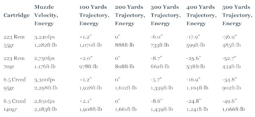

Objective: mid/long range (200-600yds) steel/paper work in prone; shorter ranges off-hand/kneeling/sitting; potential for future hunting nuisance species; prospect for future thermal sight and OGL integration. Primarily suppressed use case across the board.
Commentary: first gas gun; experienced handloader and TRG 42 300WM driver. Weapon selection and caliber decided (ie, GAP-10 Gen 2, 6.5CM). Trending to a 20in barrel to facilitate accuracy in both suppressed and unsupressed states. Aware that the EOTech is based on 5.56 ballistics: however, the trajectories between 5.56 and 6.5CM match closely out to 500yds. See inset graphic from BHG blog. Will be targeting to a 1423gr Hornady A-MAX with H4350 for handloads.
Appreciate tech consult on barrel length and addl build specs from current/former GAP-10 Gen 2 users in 6.5CM. Note, the TBAC assy will be used on both the 6.5CM and 300WM platforms.
