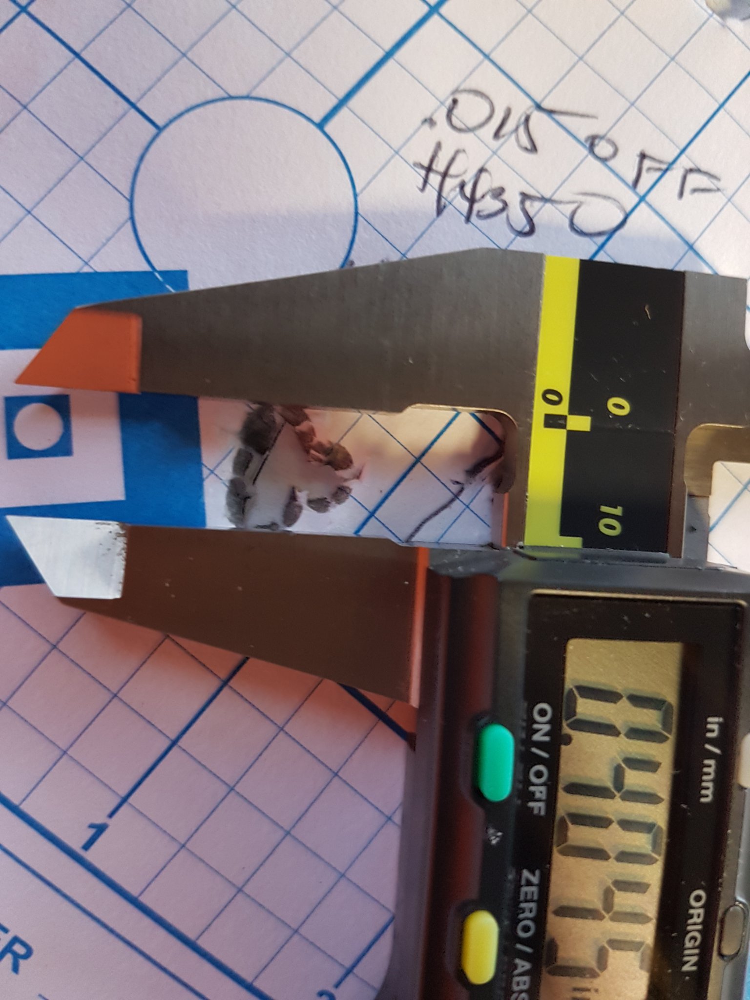

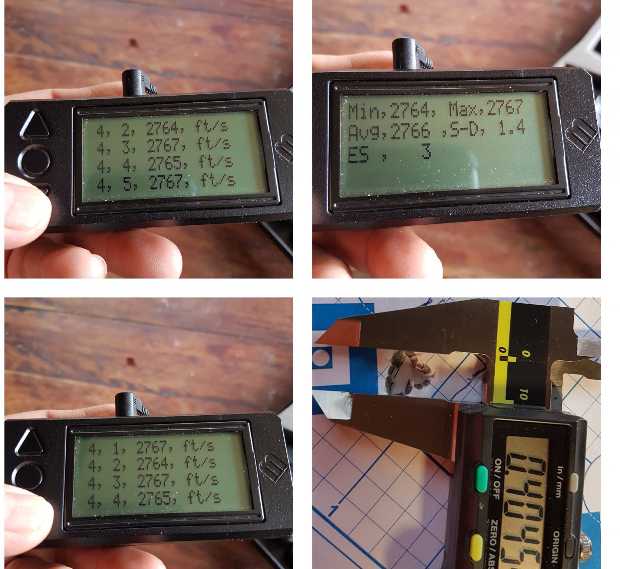

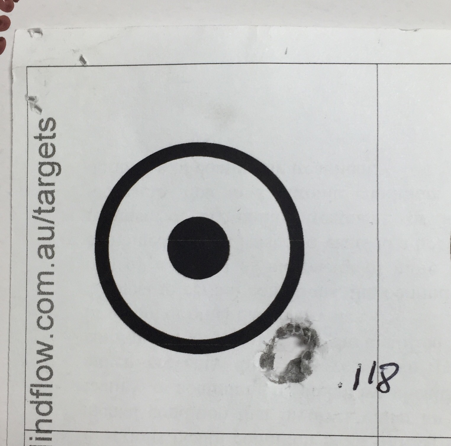

It seemed most any bullet I tried would shoot .5 moa or better with a baseline load.
After tuning they'd stack like the photos seen above.
