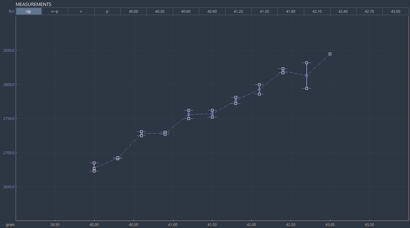

    These were not fast fired and barrel was warm but not hot throughout test. The graph below is a screenshot from Gordon's reloading tool (similar to QL). And for what its worth, after inputting these charges and speeds, GRT calibrated the burn rate for my batch of H4350 and told me the low/med/high nodes were supposed to be at 40.7 gr ( 2692 fps, 52335 psi), 41.8 gr ( 2769 fps, 57202 psi), and 43.6 gr (2883 fps, 65672 psi) - so the speed on the middle node correlates to my speed, but not for the lower node and not data for the high one. Also max pressure was defined as 63091 psi so high node should be out.

    2.) Are there 2 nodes near the bottom side (40.6-40.9 and 41.2-41.5) or is that 1 wide node?
    3.) Should I concentrate down here or is there another one up near 2820ish? Is 2820 too hot?

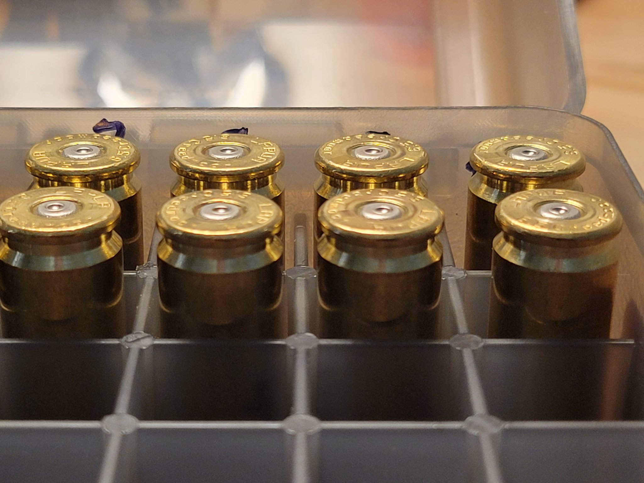

    Here is a picture of the primers for the highest 4 charges if that helps anyone (I dont see a problem but interested in others opinions). From left to right: 42.1, 42.4, 42.7, 43.0.
    There is slight ejector slot flow, but that is seen even on the lowest 40 gr charges (a little more pronounced I guess on the high charges). Same for the craters - I can feel a slight crater with my fingernail on the 40 gr but more pronounced on the 43 gr. Other thing I noticed is that at 42.1 (far left in this picture), the primers started to have a flatten top with being the most flat at 43gr. They still look to me like there is plenty of roundness on the edges of the primers though.

    Yes the ones with ejector marks {2820} are likely way too hot. 2873 is way over 65k if you are getting brass extruding into the ejector hole. I believe that is more like 80k with most brass. Some really hard brass wont show ejector makes even at 80k.

    Idk, I never let it get high enough for my primers to be an issue like that which I took note of using cci200s. Primers aren’t a great indicator until they are beyond ignoring imo. Yours don’t look too bad.

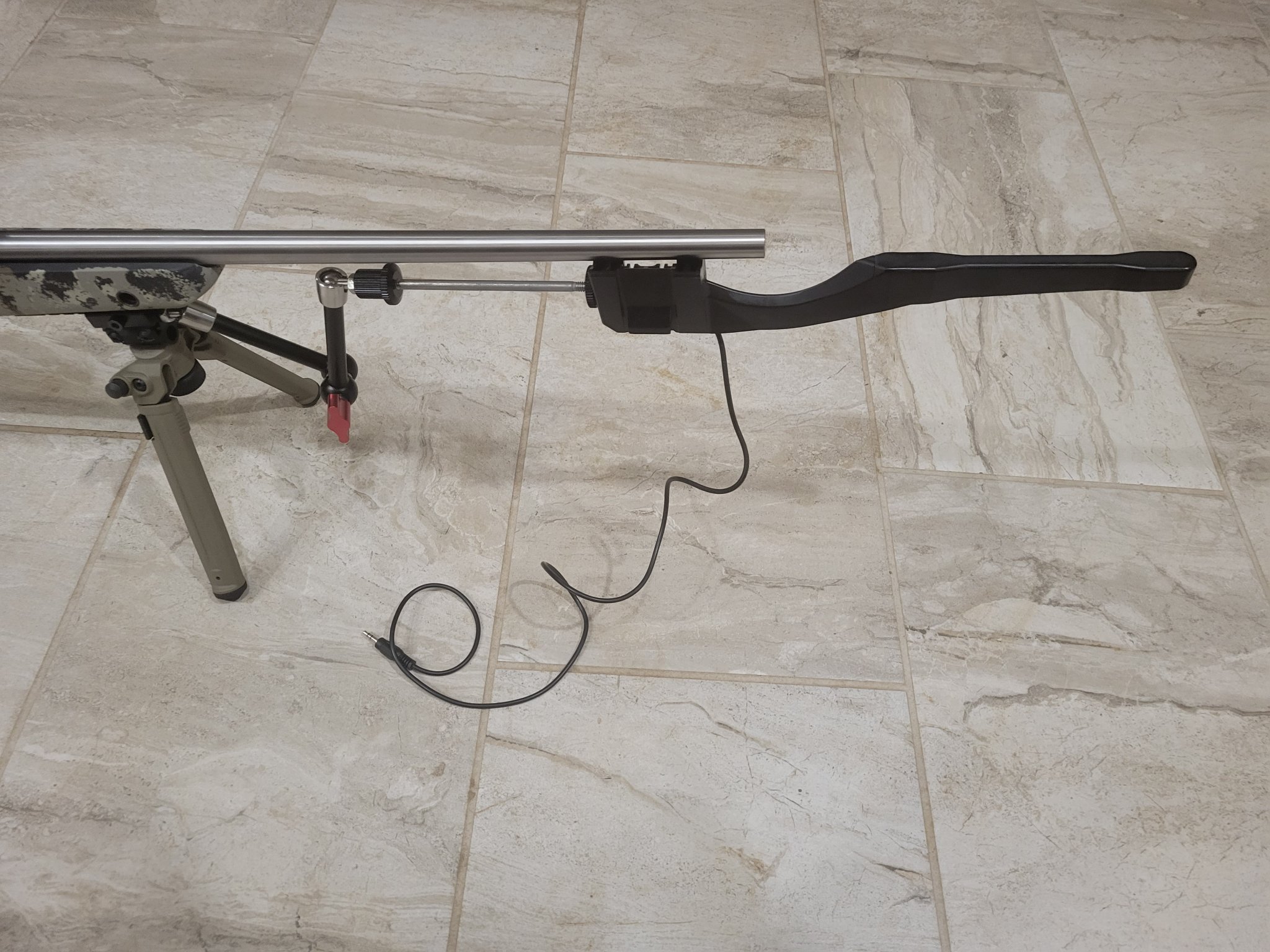

    Have you determined whether the magnetospeed attached to your bbl moves poi or changes group size ? Sportier bbl, so is likely. What did the groups look like re: vertical placement from POA? Chrono data points to a 0.1 grain incremental ladder 41.2-42.0, on paper, using a single POA for all, carefully marking impact of each shot on an identical target at the firing line, without the magnetospeed.

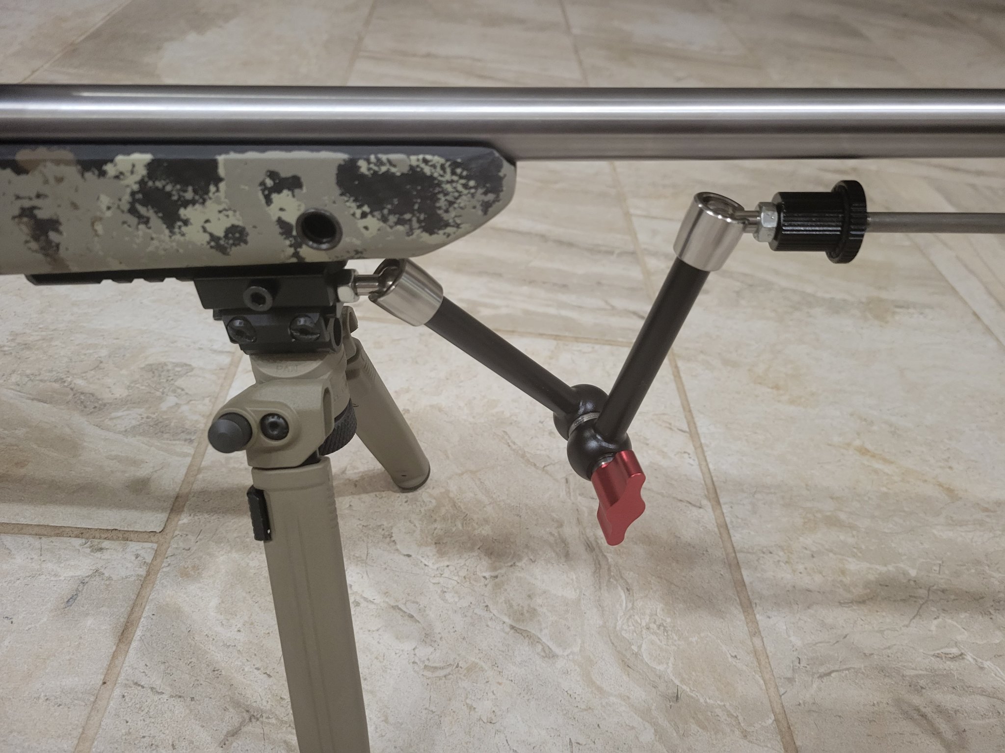

    So I use a $30 hack for a $150 MK machining mount so I get poi and velocity on the same shot.
    Seems like others have nodes at the 2750 and 2830 areas (assuming 30 fps gain once broken in). If the node moves with velocity then the lower node at 2780 would be a solid final spot or if the node stays at the same speed then a reduced charge (lower pressure) version of the 2830 node should be well away from pressure problems (haven't seen anyone concerned with my brass pic).
    Sounds like I need to just keep getting data and wait for it to settle out. I think I'm going to do 0.1 gr increments around both nodes with 3-5 shots each. Haven't got to stretch it's legs as my range only has gongs (no personal targets) past 200 and I didn't think that was too helpful early on, but have some decent blm spots once the drive is worth it.
