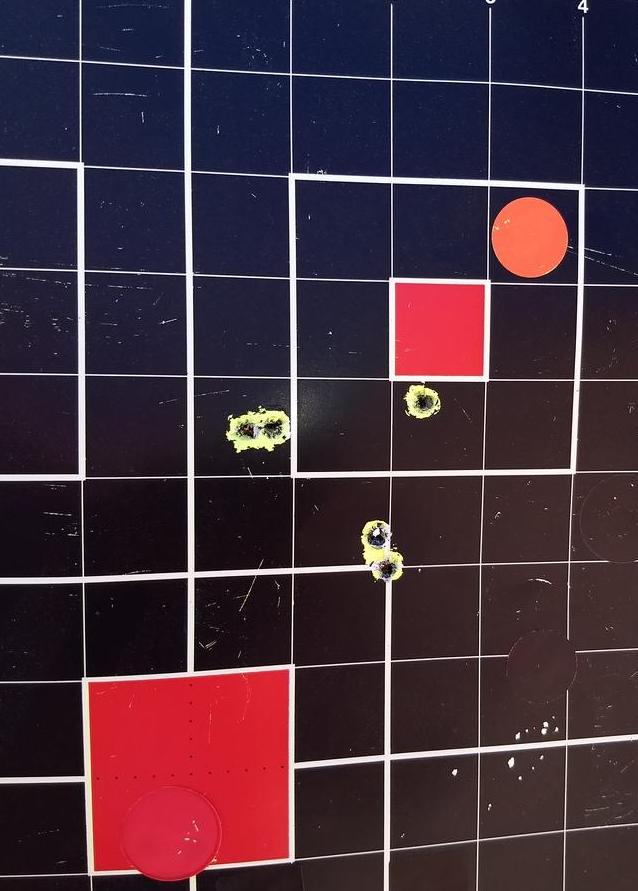

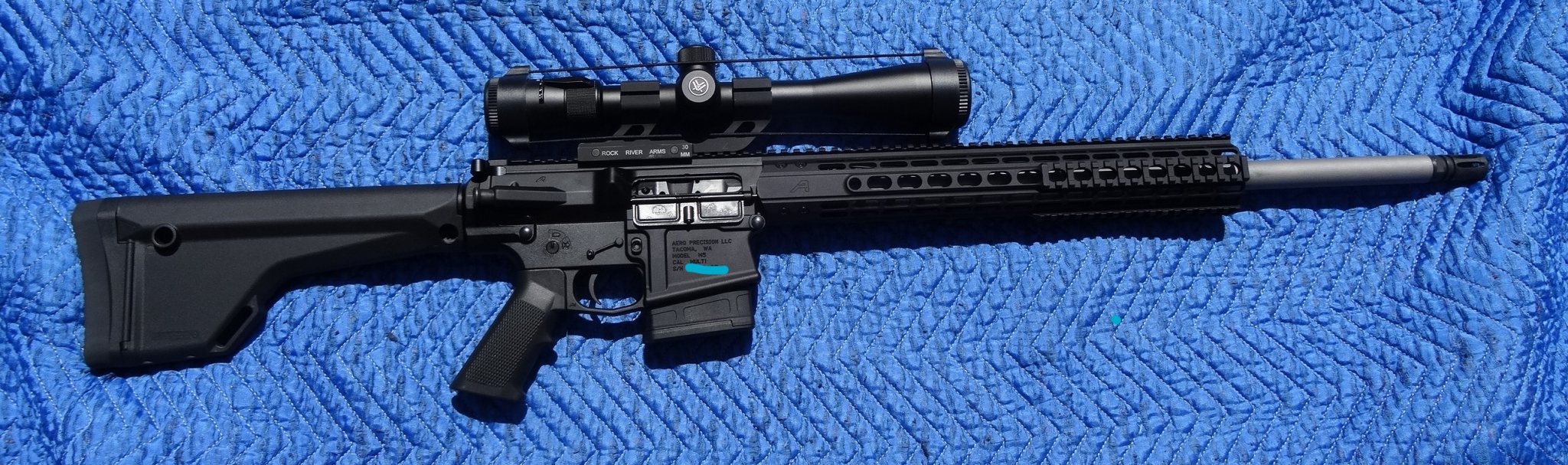

My Aero Precision came with the Ballistic Advantage 22". Shoots pretty well.
@ 100 yards Hornady about .75 MOA

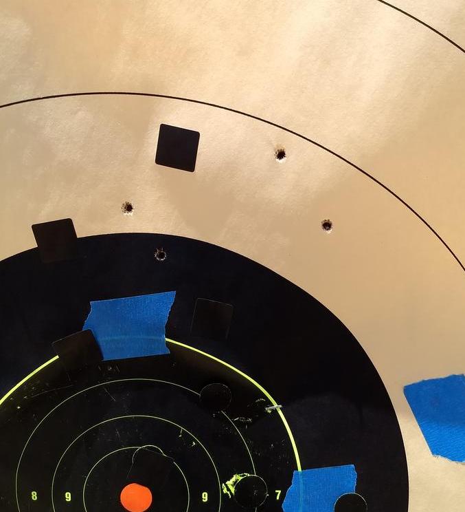

@300 yards with Hornady 140 gr American Gunner ...almost exactly 2" or 2/3 MOA

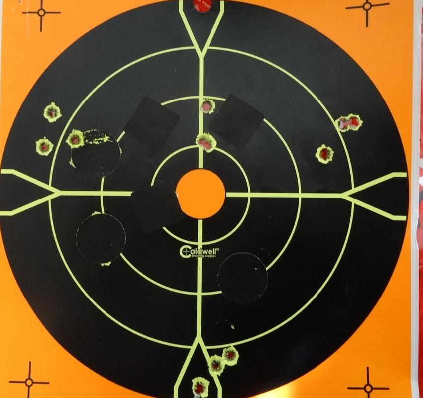

Didn't care too much for the SIG ammo....4" or about 1and 1/3 MOA

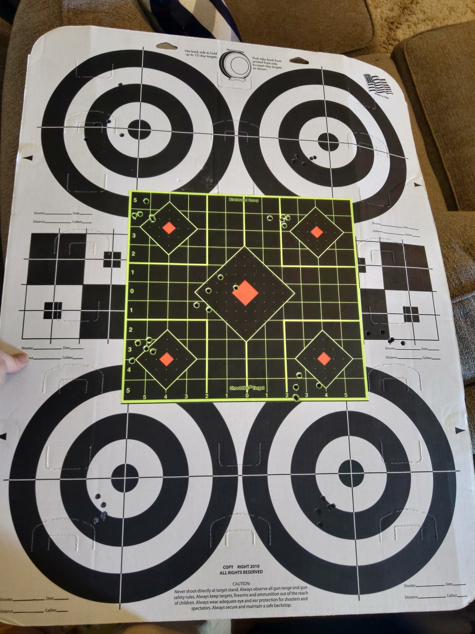

Here is an update with accuracy for the 20" barrel on my Mossberg MVP LC 6.5 Creedmoor at 100 yards doing a load development. Top right on the colored target is .358" grouping, I pulled the last shot.
Reactions: Calfed
