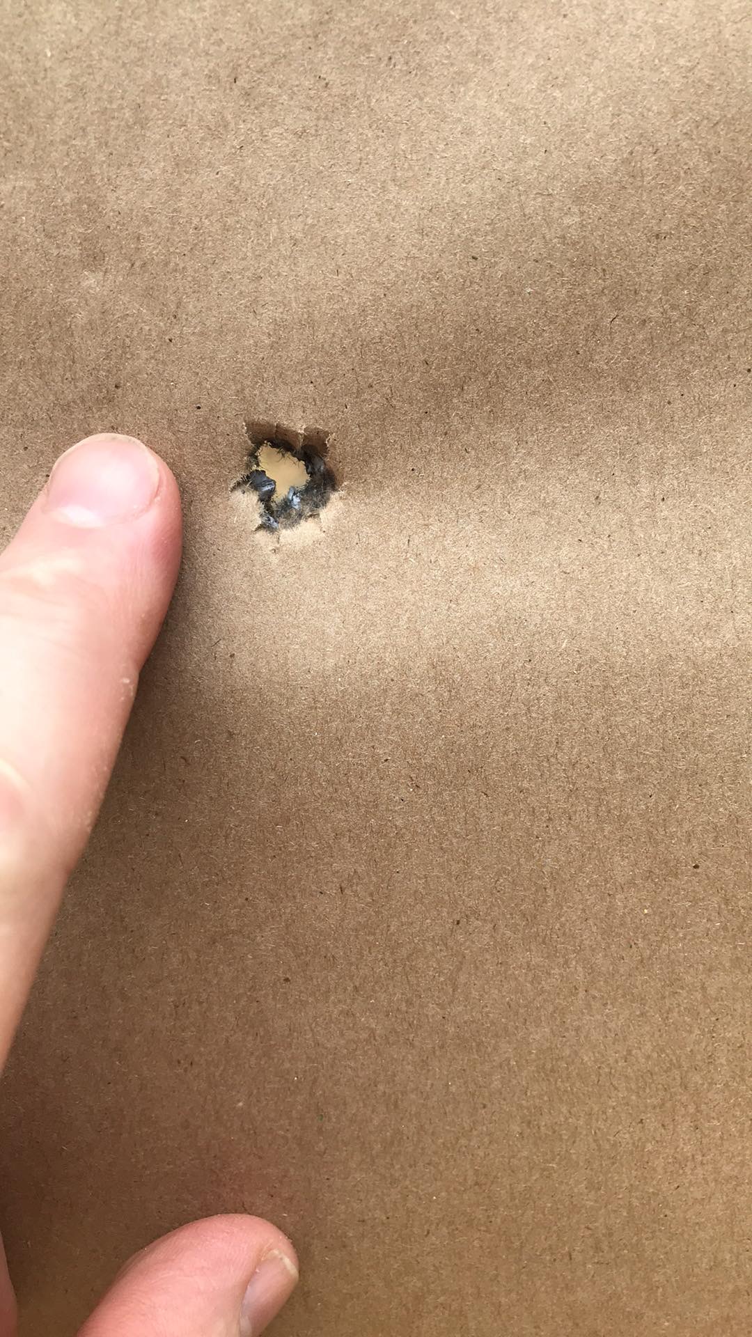

LOL Yeah you can do that with the chrono but I wouldn't. I have had barrels go out around 2300 rounds and some go in the 3000 range. The barrel I have now that I am selling with the 6 Creed barrels on the GAP Templar has a little over 2600 rounds. I put 3 Tubb TMS rounds, which work great to smooth the throat, through it at about 2200 rounds and shot mostly factory ammo through it in matches and when I put the tuner on it to test it shot that lot of factory ammo like the 5 shots at 100 below. Did up until I took the tuner off and placed it for sale with the others. I would bet that barrel will easily make 3000 rounds if not 3500 with factory ammo.
So to answer the question, it's tough to say but I would plan on replacing it around 2500 and have a barrel ready to go but wouldn;t pull the barrel that's on there until you see it go south. A lot of the answer though depends on what people consider "precision". Someone happy with 1 MOA can probably get close to 4000 rounds. Someone wanting sub half moa would be lower in the 2500-3000.
