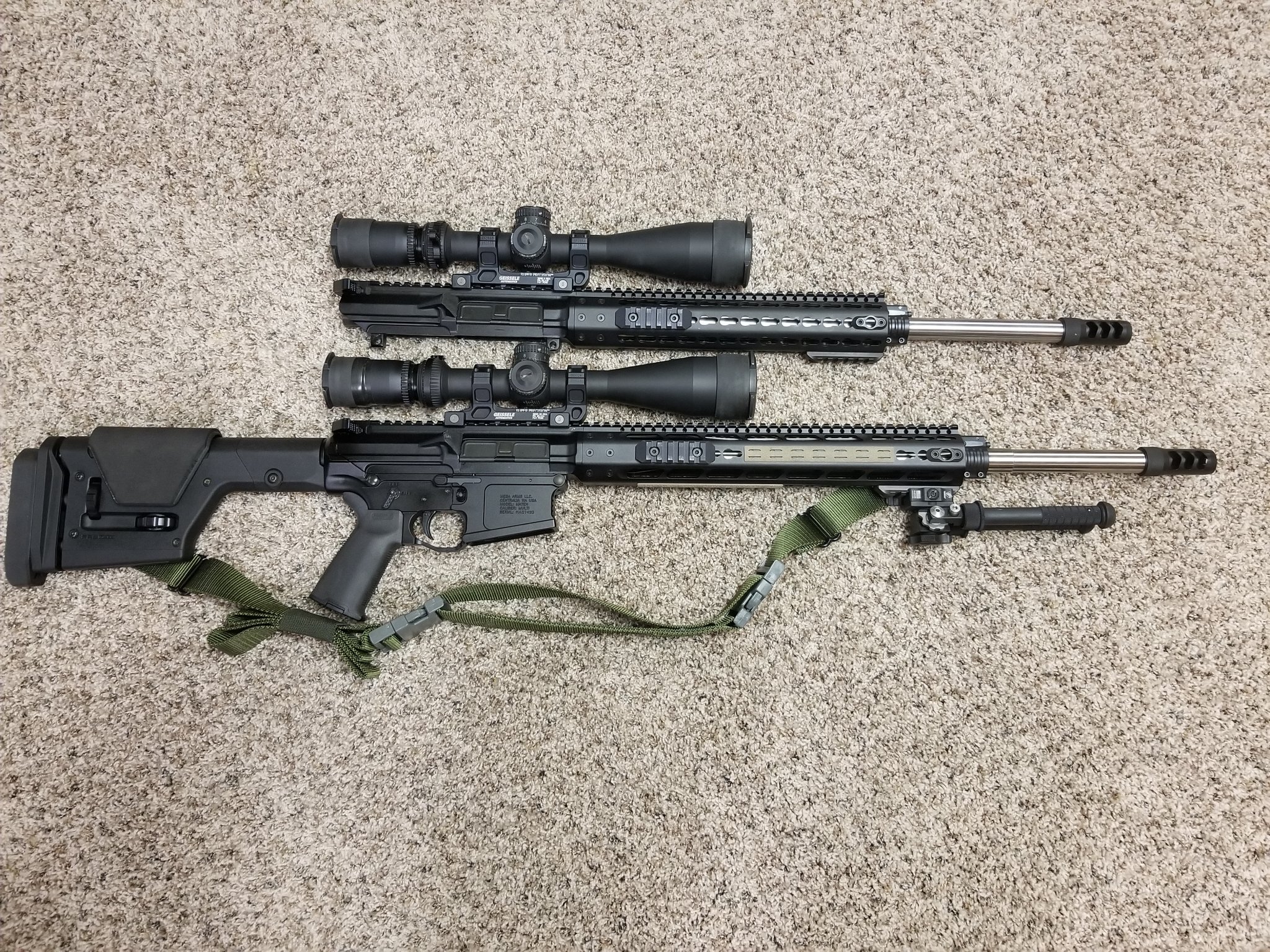

I have 2 uppers for my Mega Maten. One is a 6.5cm, 22" JP with +2 gas. The other is a 308, 20" Proof SS with rifle length gas. Both use SLR Sentry 9 AGBs.
The difference in barrel profiles make both uppers handle about the same, weight-wise. I believe the +2 gas systems are normally only recommended on barrels longer than 20" due to the increased dwell time at higher pressures when using the slower powders in 6.5cm like H4350 vs, let's say Varget or 4895/4064. Figure about 1.75-2 ozs for each 1" of barrel length, and 25fps.
