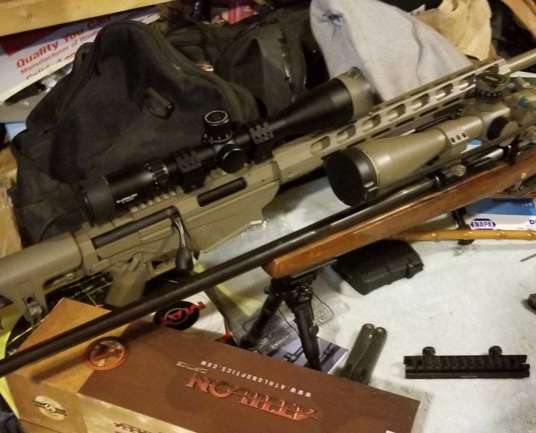

We both using Ruger provisions, nice. I just swapped glass from leupold vx3i lrp 8.5-25x50mm to the Athlon midas tac 6 24x50. It arrived yesterday. Vortex rings and a bubble but no trigger time to. Weather too thick. It's a stock rifle but for my debatable duracoat rattle can job and a good chamber polishing before I ever fired it. Here she sits next to her big brother. M98 in 270 with discarded leupy on it. Cheers and God Bless you!

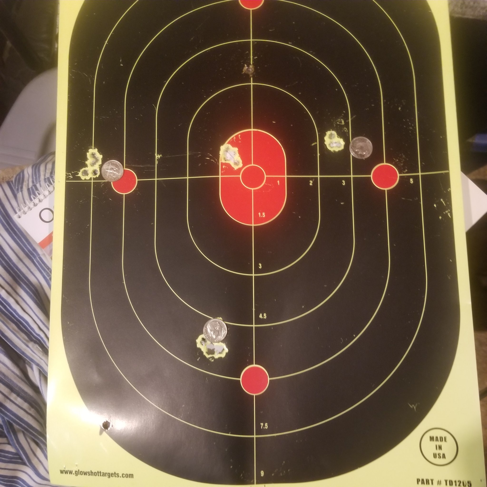

Hi Mk. .3 @ 700 is a nice slice on any sandwich. Last go round doing load workup. I'm close to cleaning dimes at 100 and now 150. Posted the last target with dimes next to the groups. Cant use standard grids at the moment as the weather up here in northern Maine interferes. So the shootnsee will have to do for now. Hoping to get this RPR dialed in under .5. If not I'm gonna get another barrel. As much as I like to shoot, I'm not heading into the fray for chits n giggles. If I'm gonna get a whupping I'm leaving a trail of black eyes in the wake. Coming back to the hide has proven the best move I could have made. I've missed reading the forums and the quality of resources is top notch. I will check out that annealing unit. And get my next set of beggars questions ready.
Again many thanks. Learning new tricks for a brain dead old guy is challenging!
