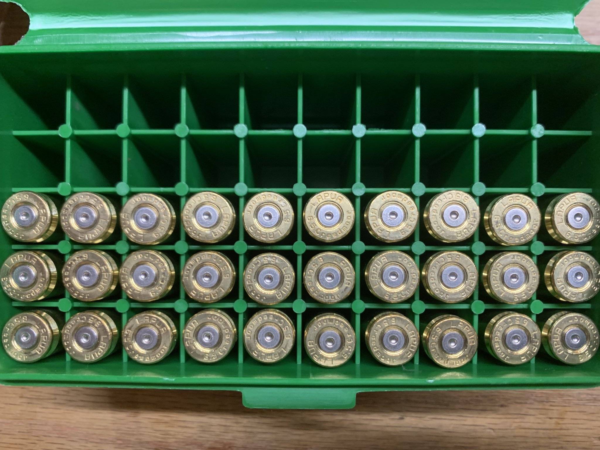

Starting to reload for my 6.5. I have been reloading for many years and the selection of different brands of brass is amaizing. I am thinking ordering Lapua small primer, I will be FL sizing a standard Forster die, (already have small pins) any reason to buy something else?
It’s a totality of issues thing. Hard to find components, ignition issues, primer piercing issues, etc. Large primers are more forgiving and idiot proof. And most people are not good enough reloaders to take advantage of the smaller SD potential.
But if you’re awesome and have a perfect rifle, then go for it.
Like what was mentioned, you want reloading components that are available. If you can find SRP then go for it. Otherwise, I recommend Peterson or Starline brass with large rifle primers.
I'm curious with ignition issue - Is it affected by the smaller Lapua flash hole? Does the large primer Lapua suffer the same issues?
No it’s not the flash hole. In cold weather the small primer has trouble igniting certain powders. Many rifles hit primers off center due to a combination of loose chamber, bolt, firing pin raceway, etc. Then when you get close to max pressures you start piercing primers because the rifle isn’t built correctly.
It’s not worth the headache.

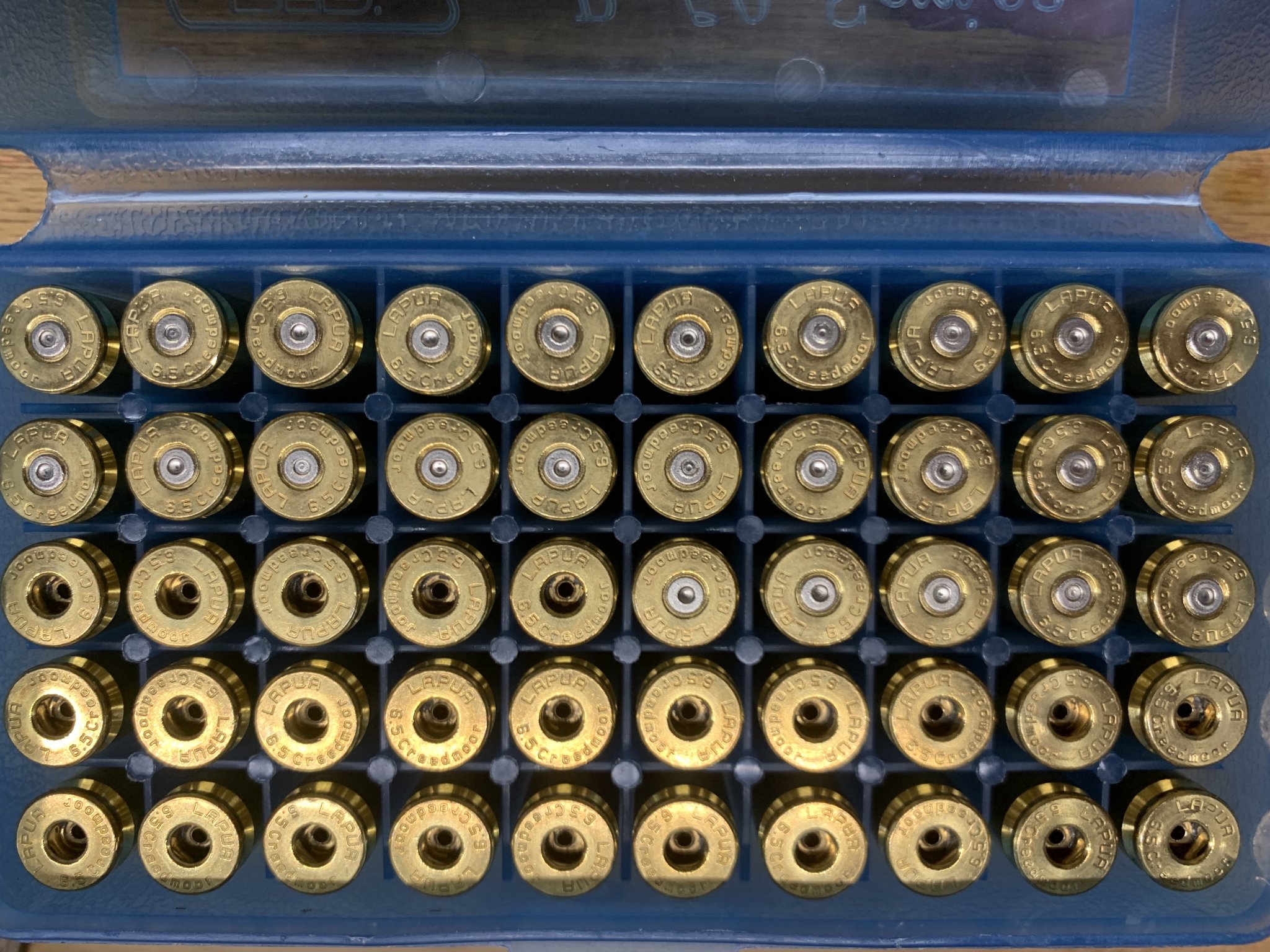

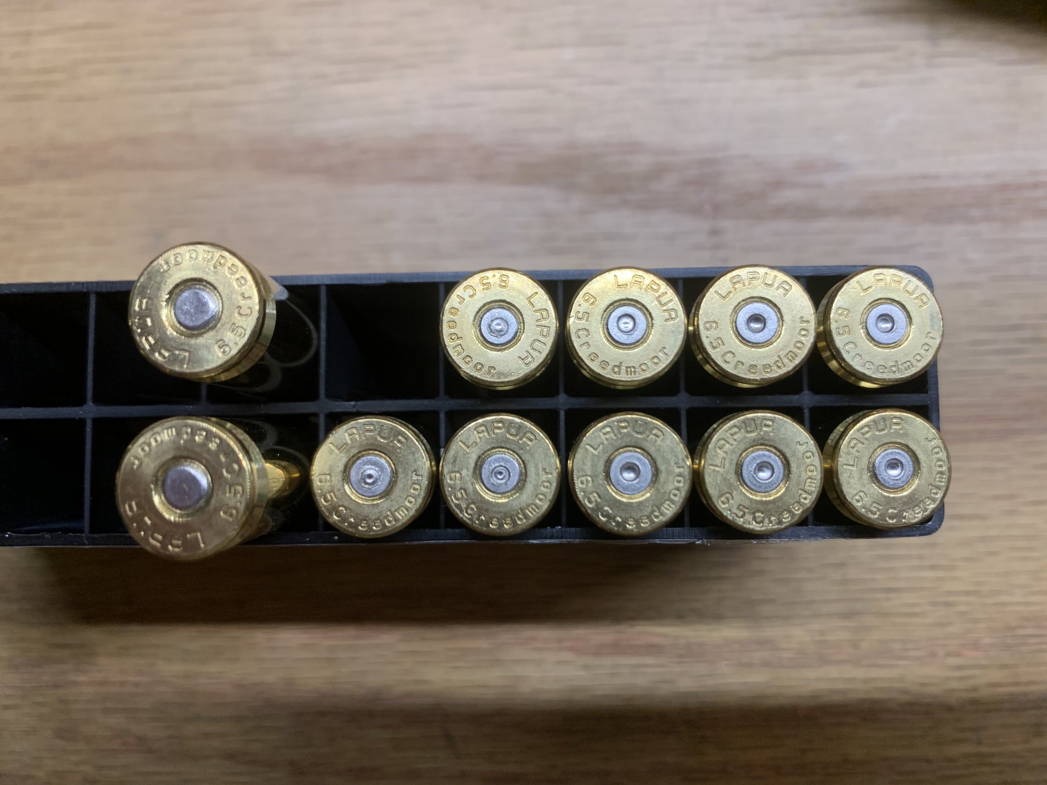

Lapua SRP is also a pain in the ass to get a decap die for. With that being said I'm using Lapua SRP and love it but I've had to Jimmy some shit together to have a decap die as a separate function. There may be a better die set up but I've been unable to find one.
This is exactly why I use Starline SRP 6.5 and .308 brass. For my batch of Lapua 6.5 cases I have a Harvey deprimer
Edit: The Starline SRP has a standard size flash hole
Lapua large primer. Brand and quality is a no brainer, primer pocket is the size it’s supposed to be. For myself it’s also the choice due to shooting in AK winter as well.
Don’t understand why manufacturers have to keep make things complicated, like small primer .45acp, (yes I’ve heard the green primer) now we have to sort brass by primer size too. Loading on a Dillon you don’t wanna be having that foul up.
Srp Lapua brass available at some online sites, but no srp to be found anywhere. On the other hand, lapua lrp brass can’t be found anywhere but lrp primers can be found from time to time on lgs shelves.
I'll have to look into that Harvey deprimer. My current set up has me wondering when that Jimmied up rig is going to fail.
Don't overlook Alpha Munitions brass.
Alpha is pretty good brass. I have a couple hundred on its 8th. Only thing I didn't like is the primer pocket. All 300 pieces I've ever got from Alpha had to be uniformed which is not a big deal, I do it anyway. But between trimming, chamfering, deburring, and uniforming you could have added all shavings together and only had 1/10th the amount from the primer pocket and primers were still tight as hell having some that had to be deprimed because the process damaged the cup.
I see. I run LRP brass and it has been fine
Yeah I haven't heard of that issue with any LRP brass. Really Alpha is the only SRP brass I've heard of the issue but I knew about it going in so I'm not bitching about it but just letting it be known that it's an issue so a guy without the equipment to uniform primer pockets or a guy who doesn't know what that means doesn't go balls deep on Alpha SRP then get burnt.
I knew about it, uniformed all right off the rip, and still had several primers clip an edge and smash a side. The first batch of 100 I had a few issues then I figured out exactly how everything had to be to stop the issue but it was still extra tight. After first firing it's pretty much straight forward.
But their SRP is large flash hole so that's an upside.
Don't overlook Hornady brass, when sorted and prepped it is worth the effort.
The only once fired brass I have bought for my 6.5CM was Hornady but instead of 100 pieces for $100 of Lapua I paid $100 For 420 pieces of Hornady.
If at all possible buy within the same lot in as big a batch as you think you will need after sorting and culling pieces.
The reputation of accuracy and consistency for the round wasn't built around Lapua brass or a small primer and flash hole. 😎

I’m now sticking with 6.5 creed Lapua LR brass from the Berger factory ammo in my Gap Templar hunting rifle. Had primer issues with the 120 scenar and 135 classic hunter ammo with the Lapua SR primer brass. George said with the medium firing pin in the Gap to stick with LR primers.
LR primers in the 156 EOL ammo:
SR primers in the 120 scenar and 135 CH ammo:
So if you are looking for LRP 6.5CM brass you might take a gander at Graf and Sons major US brass manufacturer brass. It's Peterson seconds and I am postive of this. For "seconds" it looks pretty damn good. If you want LRP Lapua they have that in stock as well.
