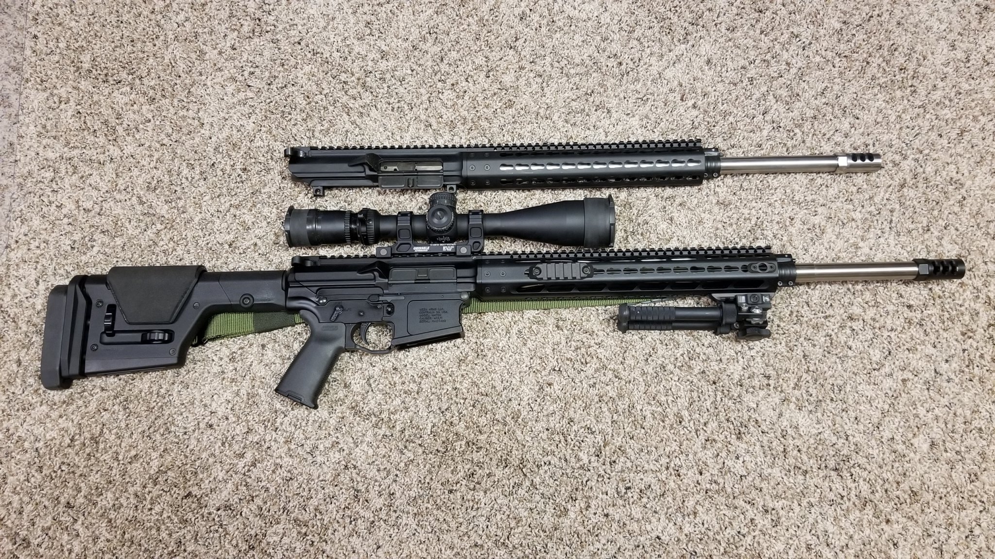

I built a 6.5mm Creedmoor Large Frame DPMS MSR AR, LR-308, AR-10... (what the hell do we call these things now?)
For the trigger, I used a Geissele Hi-Speed National Match with the Match spring. It's a two stage and it comes with three springs, so you can choose your weight. The first stage pull distance, second stage break, and overtravel are tunable with set screws. It's the most adjustable trigger I've ever seen.
I used the MagPul PRS GEN3 stock with a standard length rifle buffer tube. It comes with an adapter for an M4 carbine stock too, but just stick with the rifle buffer tube and you won't have to screw with a castle nut. You'll want the GEN3 because the comb is set back far enough to clear the extra length of the AR-10 charging handle.
I wanted the option to be able to have a suppressor, so I bought JP Rifles internals for adjustable internal mass. I went with the JP Rifles Variable Mass Operating System bolt carrier with the JP Rifles High Pressure EnhancedBolt. For the buffer, I used a JP Rifles Silent Capture Spring Heavy Version. I bought four of the steel weights and the spring pack and while I wait for my can, I am running steel weights and a lighter spring. When the can is out of ATF jail, I will put on the tungsten weights and possibly increase the spring weight.
I have a Proof Research 22" barrel that is rifle + 2" and comes with an appropriate length tube. I use a JP Adjustable Gas Block on it.
Muzzle device is the standard .308 flash hider while I wait for the can and mount.
I have topped it off with Burris XTR II 4-20x50 H591 scope with the AR-PEPR mount.
You can use whatever you want for the upper lower, handguard, grips, LPK, etc... I used a match M5 set from Aero Precision with their parts kits.
Now, if you like your handguards to cover your gas blocks, just be aware that the rifle + 2" will stick out a bit from most 15" rails.
I used a XXL (17") JP Rifles Handguard which covers the gas block nicely but doesn't occlude any of the adjustment screws.
This thing is a beast and weighs at least 14 pounds. I don't shoot it offhand much, best accuracy is from prone on a mat on an Atlas bipod.
It is sort of like the JP LRP-07 but with a better barrel and trigger, minus the side charging, and $1000 less.
I chose a jp precision barrel and all their internals and moving parts. Trigger tech trigger ,aero upper and lower with a prs stock to help balance the gun. I don’t think your gonna get a light weight gas gun in 6.5 creedmoor because you need a longer barrel and gas tube. This was my last load development group. 3 shots at 200 yards. No they don’t all group this well but never bad and functions flawless.

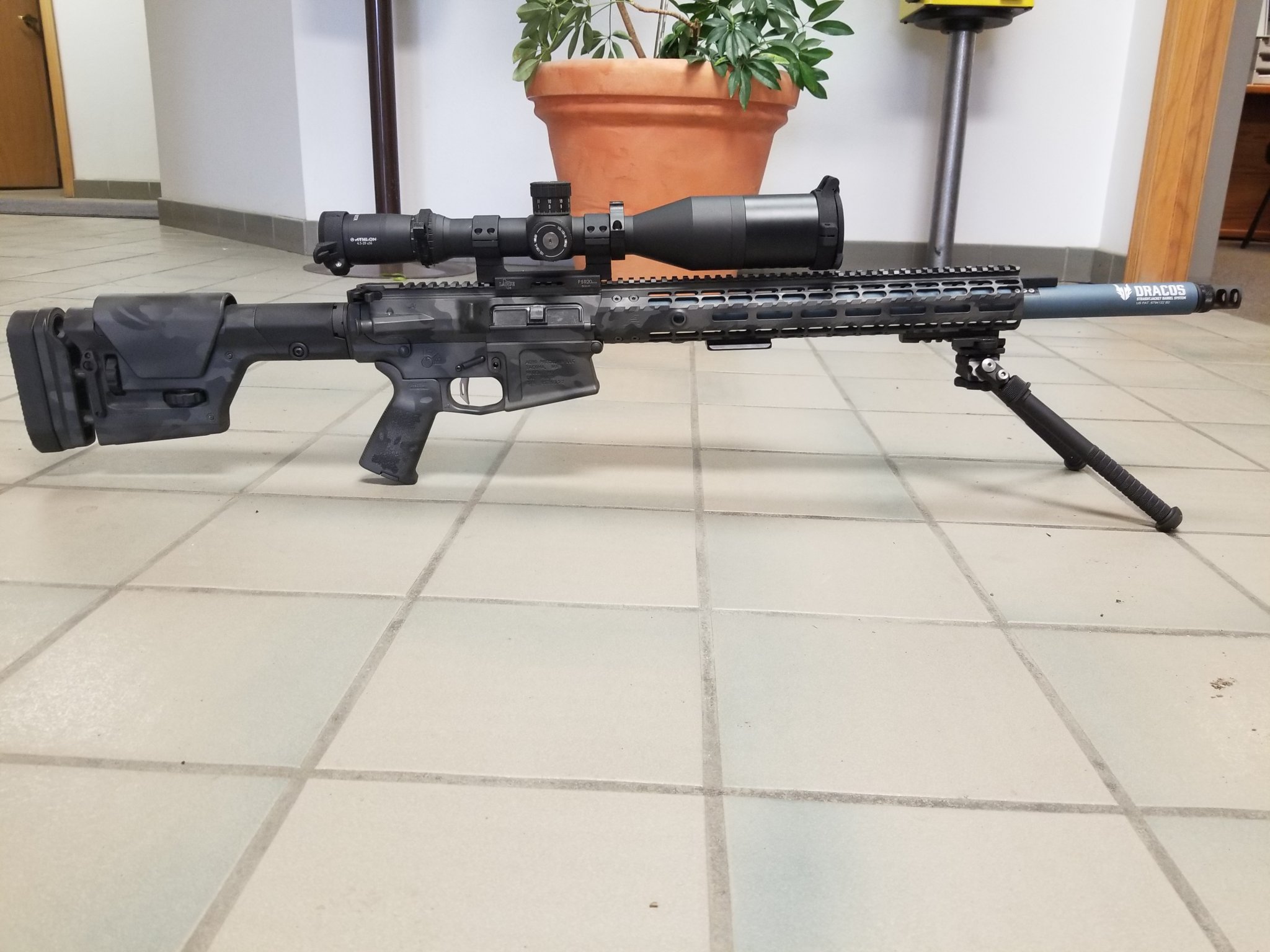

I just completed an AR10 6.5 build. I'd go with a 20" Proof Research barrel. With the 6.5 you need the rifle length plus 2 gas system. A HP bolt and adjustable gas block is a must. I'd go with the JP Low Mass Bolt Carrier & HP bolt. I also used their silent capture spring. I used the Ascend Armory match reciever, magpul stock, fortis rail. I used the Draco's barrel. It shoots but I'm not sure I'd recommend it or not. Lets say I'm neutral on that recommendation. Maybe after I get more rounds down range. I just now got it all tuned and good glass installed. Haven't gotten a chance to do much with it since.

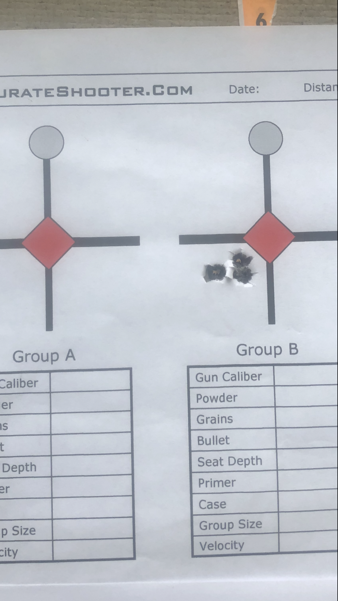

I’m shooting a Faxon 20” fluted. Accuracy has been good with a variety of factory ammo. I’m using a Rubber City Armory HP bolt/carrier, velocity 3 lb trigger, SLR adj GB.
Prime 130, Hornady 147s and Hornady Black 140s all shoot around 3/4 moa. Hornady 120 ELD-M are around 1.25 moa. The barrel has rifle length gas and all cycle great with standard AR10 spring and buffer.
A buddy of mine has the same barrel with very similar results with Winchester match 140s. We have taken them out to 300 yds with consistent sub moa peeformance.

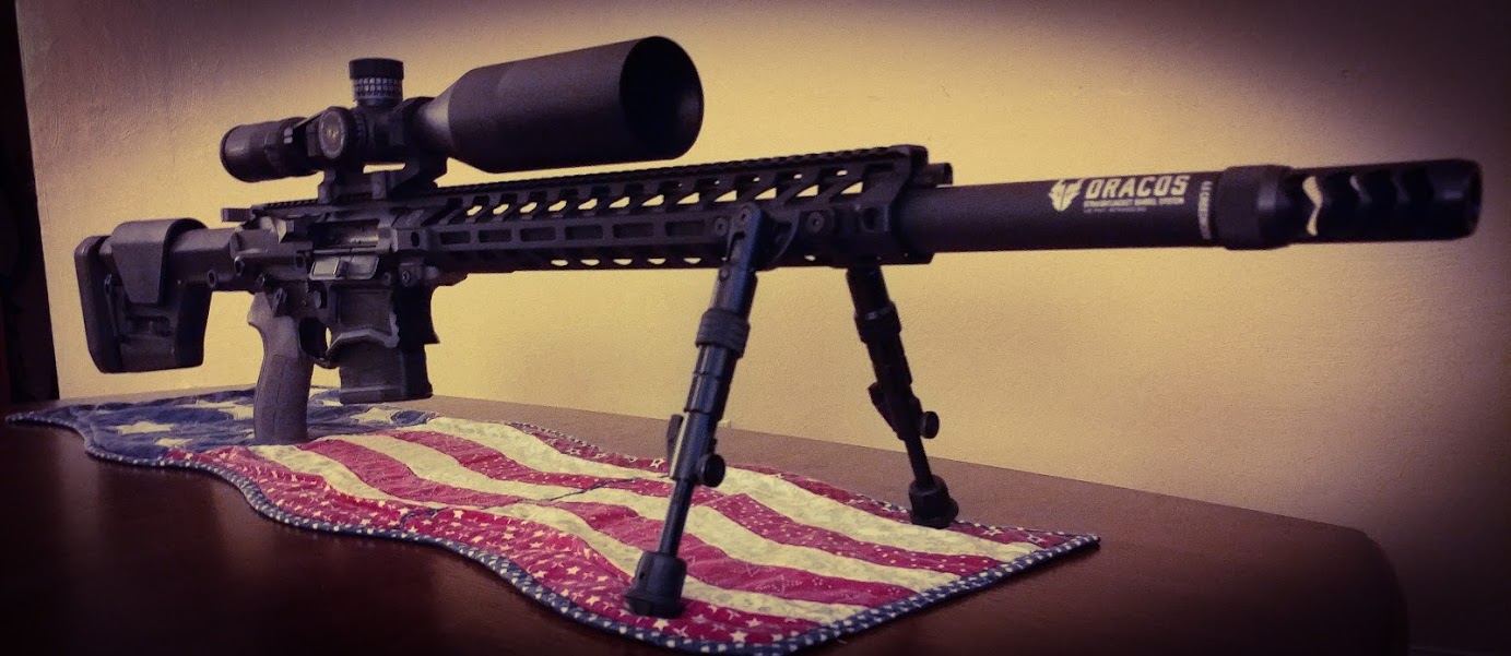

Depending on what you call "lightweight ", you can actually build a light 6.5 CM. The one in the following link is 6.5# and I'm the builder/owner. I'm not a PRS shooter, not yet anyway, and I'm not certain you would want to go this light for a competition gun, but I sure would not want a 14# gun either. Anyway, take a look, it's easy to add weight here and there if you need more.
https://www.snipershide.com/shooting/threads/lightweight-2a-arms-xanthos-6-5-cm-build.6877340/

My buddy at Prometheus arms is building a 6.5 for a friend that I’m pretty excited to test out.
Custom receiver set
JP high pressure bolt
Custom carrier done by Prometheus
Geissele sse trigger
SCS buffer system
SLR handgaurd
XLR stock
Custom cut bartlien barrel done by Prometheus
I just completed an AR10 6.5 build. I'd go with a 20" Proof Research barrel. With the 6.5 you need the rifle length plus 2 gas system. A HP bolt and adjustable gas block is a must. I'd go with the JP Low Mass Bolt Carrier & HP bolt. I also used their silent capture spring. I used the Ascend Armory match reciever, magpul stock, fortis rail. I used the Draco's barrel. It shoots but I'm not sure I'd recommend it or not. Lets say I'm neutral on that recommendation. Maybe after I get more rounds down range. I just now got it all tuned and good glass installed. Haven't gotten a chance to do much with it since. View attachment 6931991
Nice rig. But like you said jury is still out on the Dracos for me.
