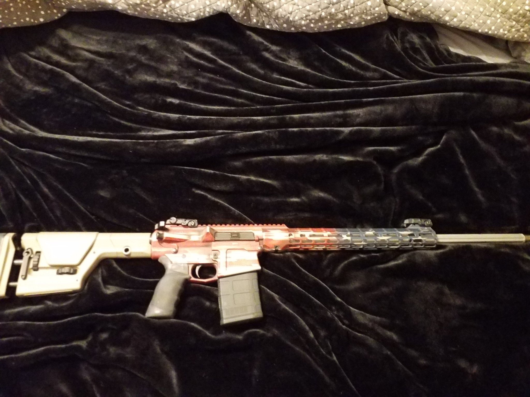

6.5 Creedmoor build.
Ultiminer
Dec 10, 2020
4
0
Rangely
I recently built a 6.5 Creedmoor in a AR10 platform. I have used mostly Aero precision parts. The upper and lower is a matched m5e1 with the atlus so Handguard. I am going to put the vortex strike eagle 5-25x56 ffp EBR-7C MOA with 34mm tube. I would like to be able to shoot 1000yards maybe more. What rings will be my best option?
I have had nothing but good luck with these. Only problem is if you put a 20moa rail on top of the AR rail, you now just have another part and its playing middle man.
This is a bad suggestion for an AR
OP. You want a 20moa mount and 'may' want a cantilever too depending on rifle setup
Spuhr. Nightforce. Badger. ARC mount. Hawkins mount.
again. Cantilevered versus regular will depend on you.
But either way. You want 20moa. Itll let you use the zero stop and still have 18mil travel
