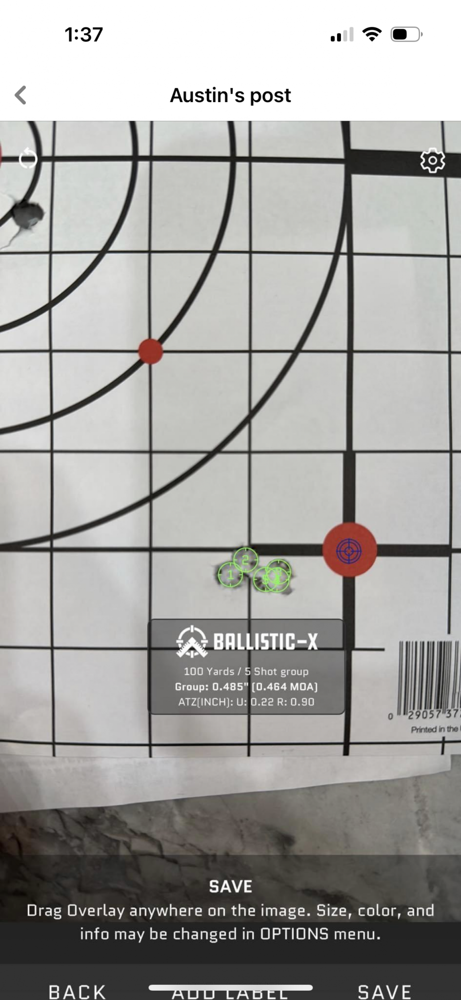

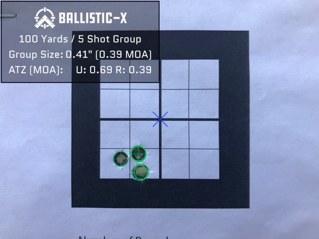

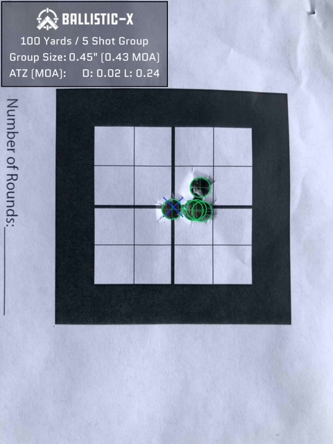

JP w/ LRI20 upper. It will run any type of ammo I push through it.

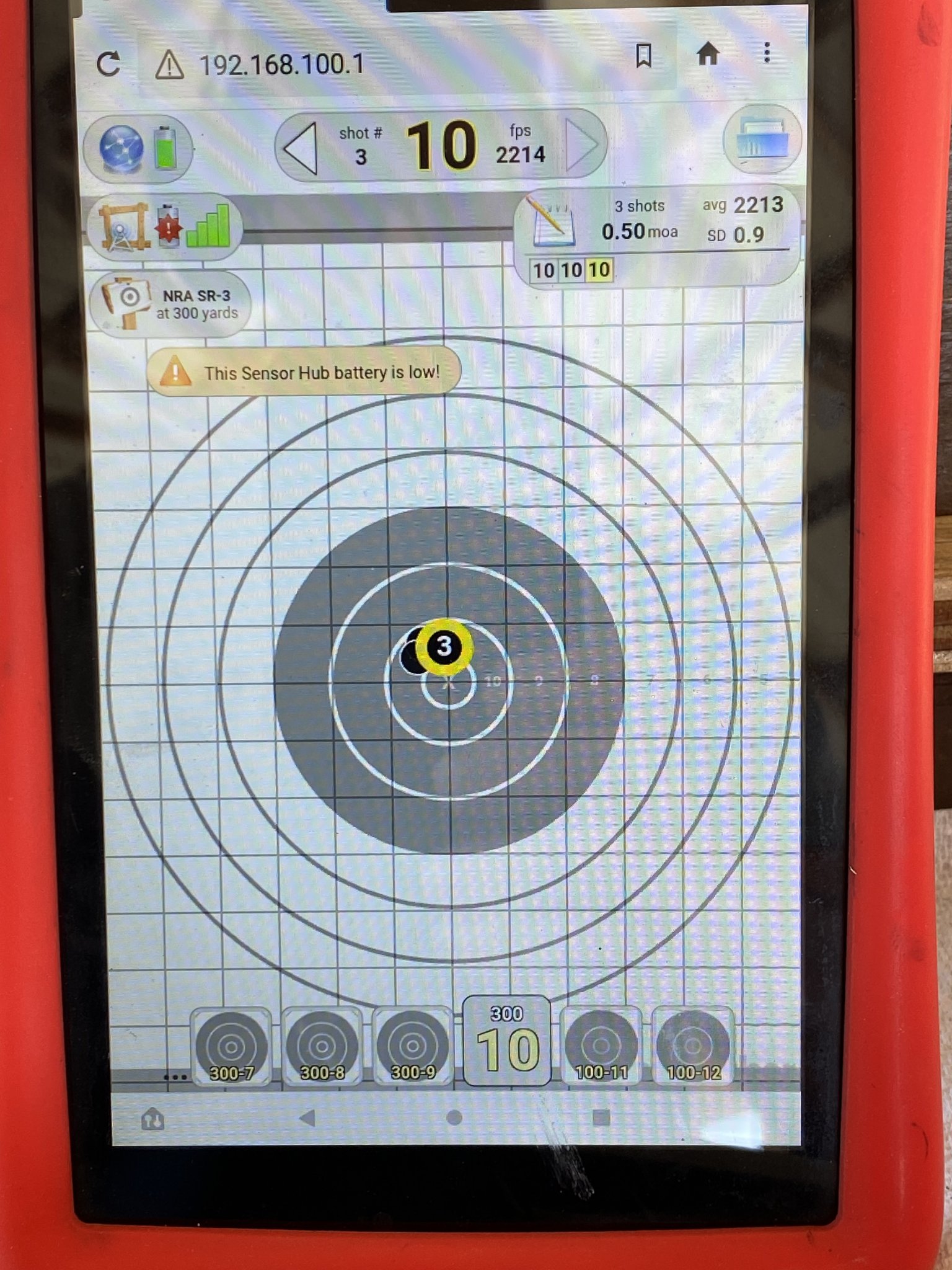

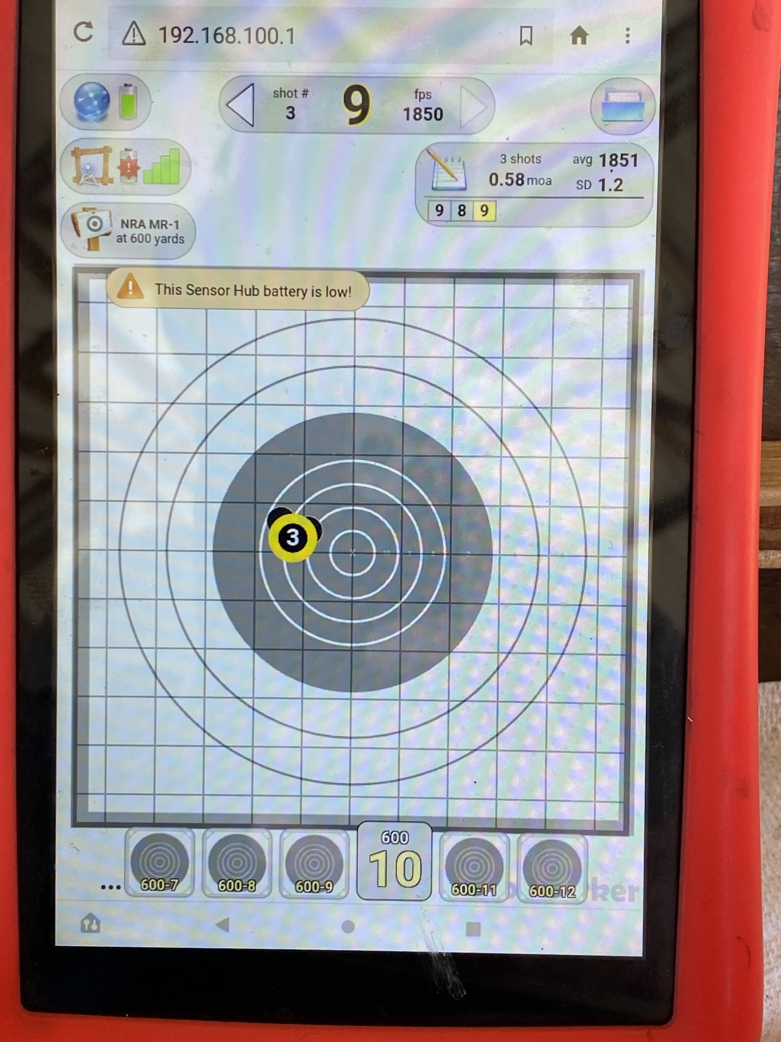

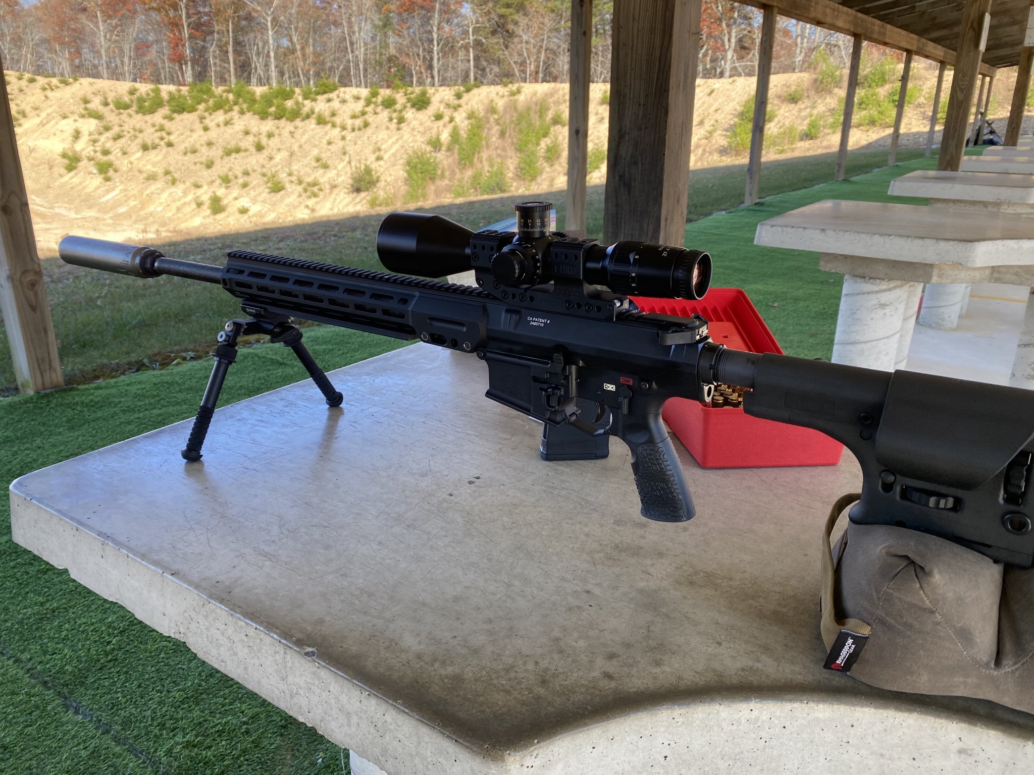

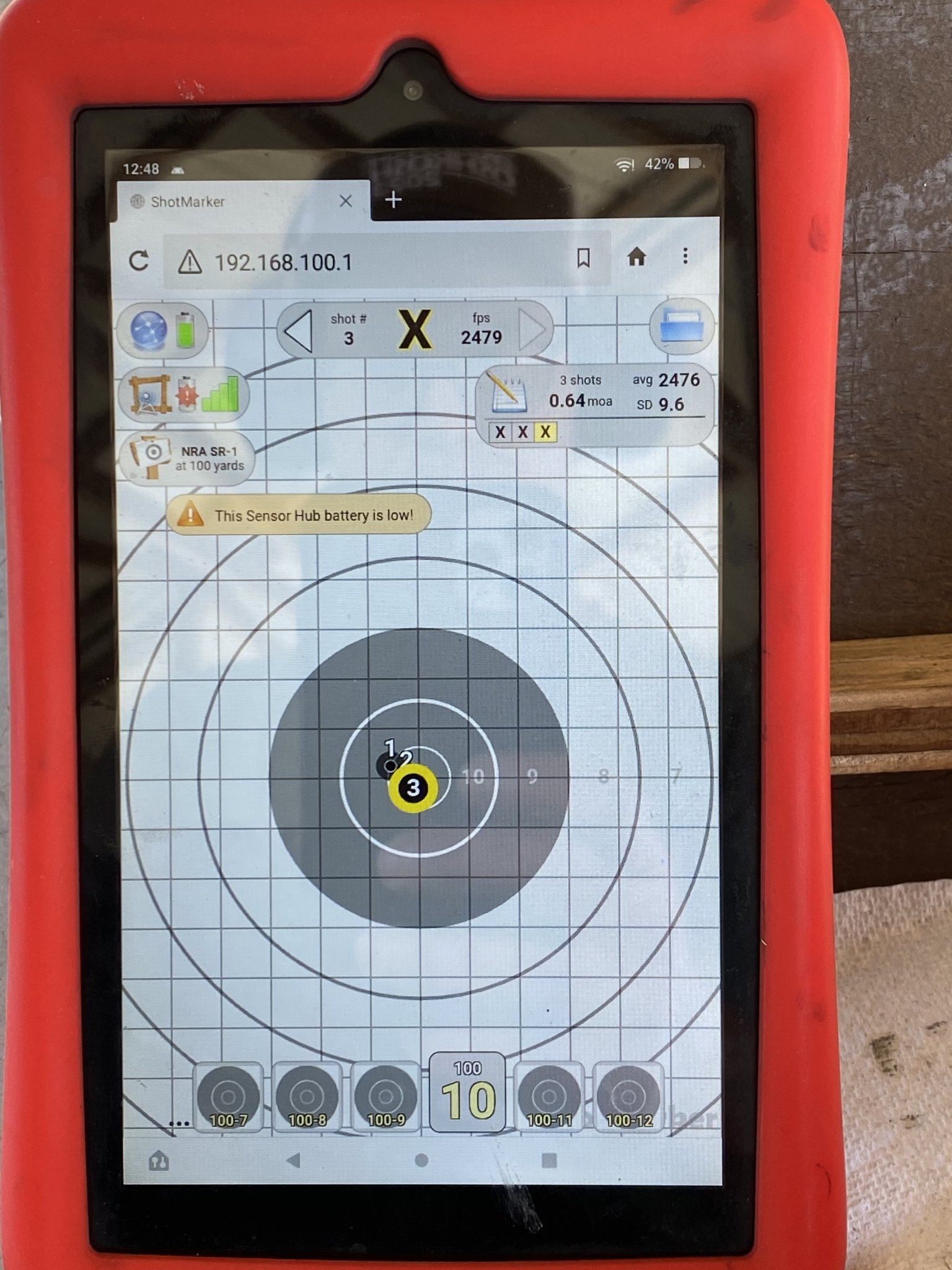

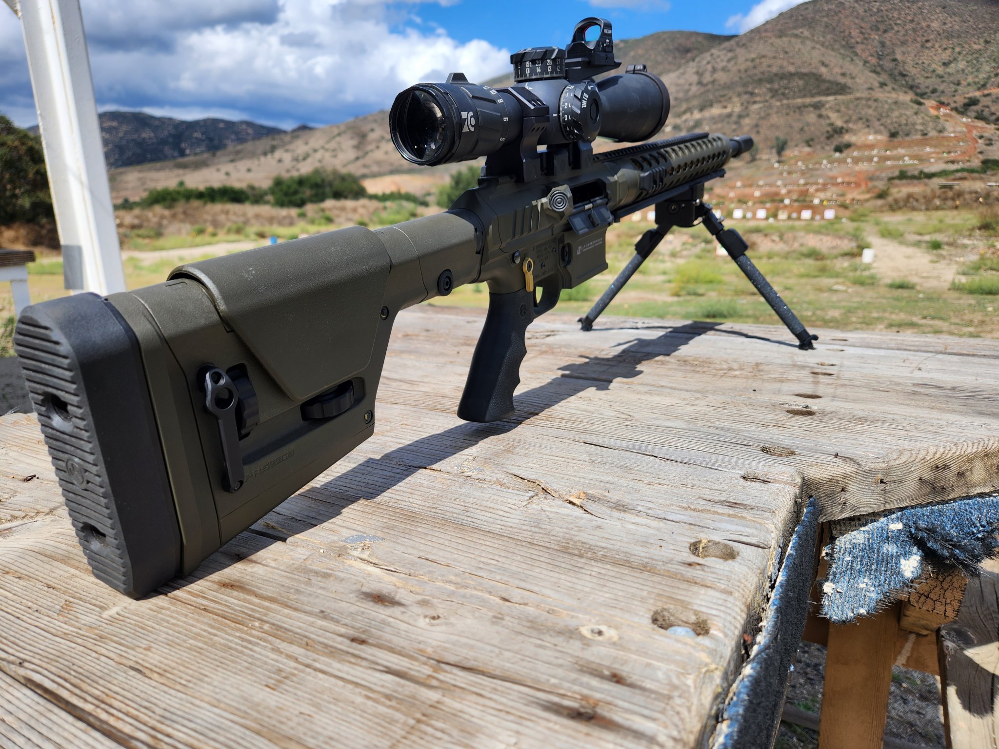

I got the LMT 15.3 together with a new MARS-H lower, Geissele National Match trigger, Geissele SCH, JP SCS, LMT bolt carrier group, 4-16 scope, Superlative AGB, and a Proof Carbon 6.5CM barrel converted by D. Wilson. Went out shooting yesterday for the first time with it. I would guess a real gas gun shooter could probably do better, I am gradually making some progress on consistency with my semiauto shooting.
I like it!
100 yards
300 yards
600 yards

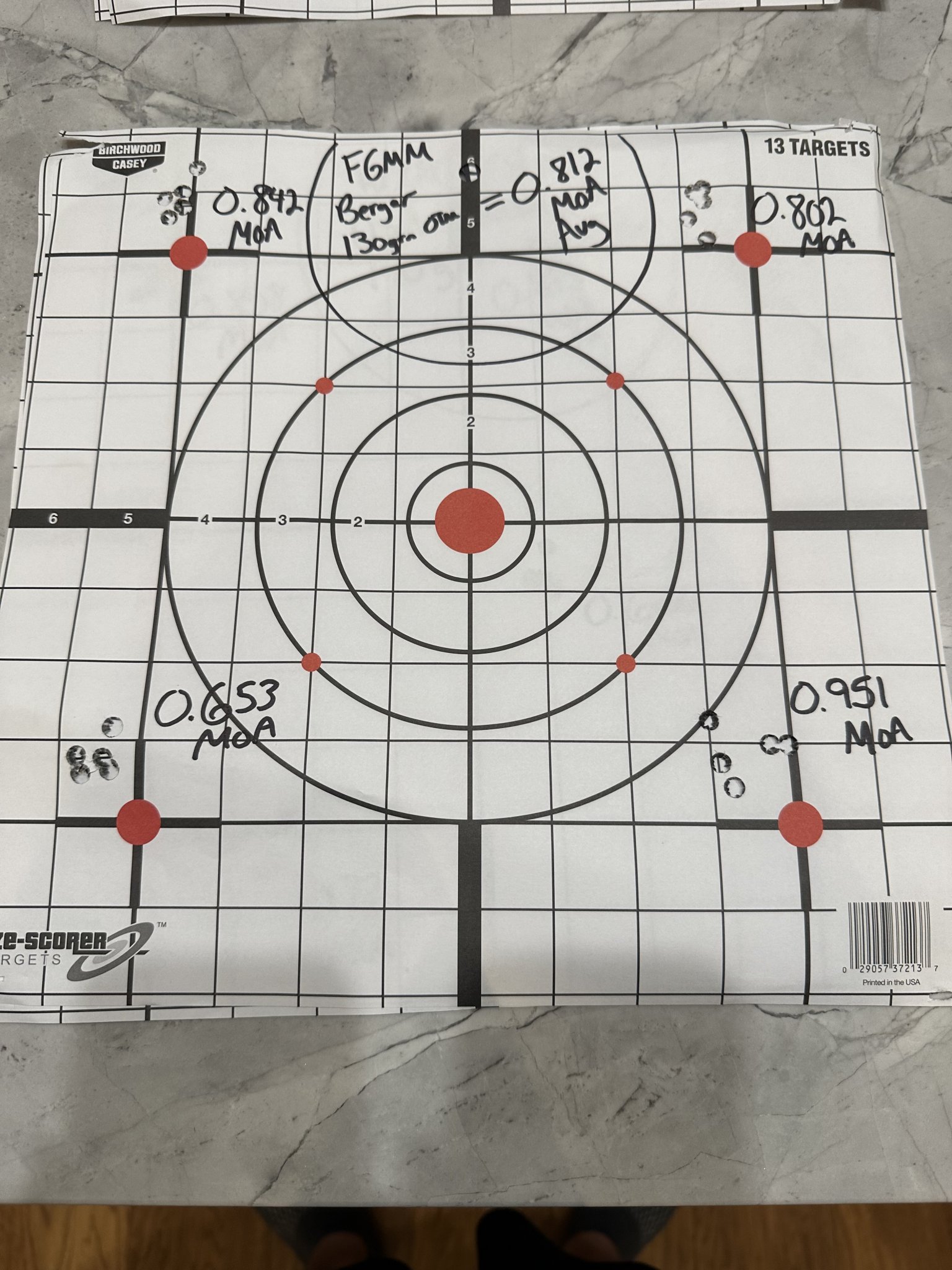

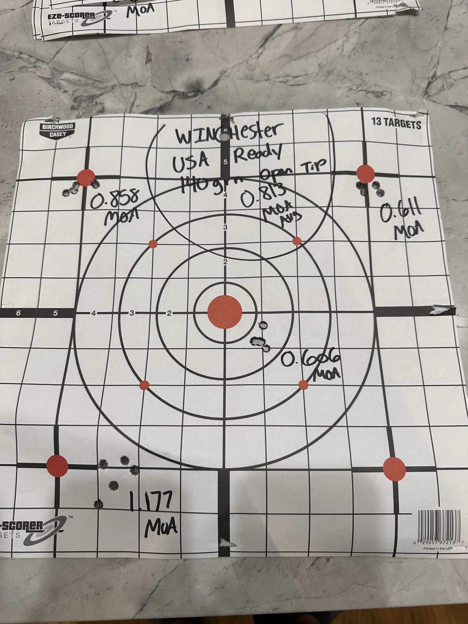

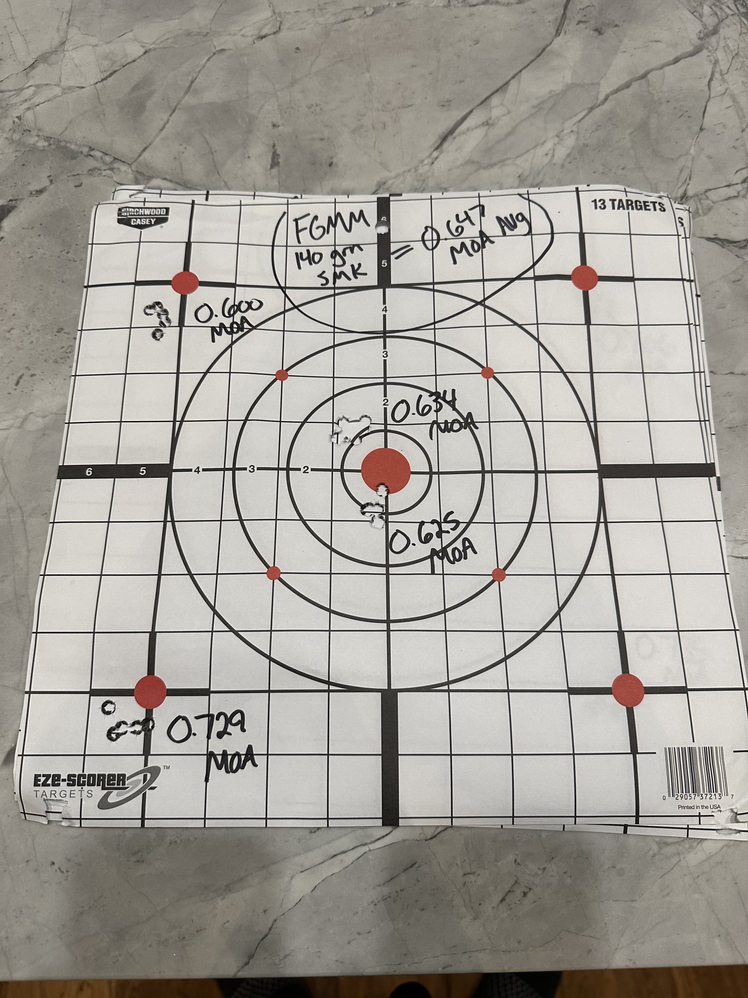

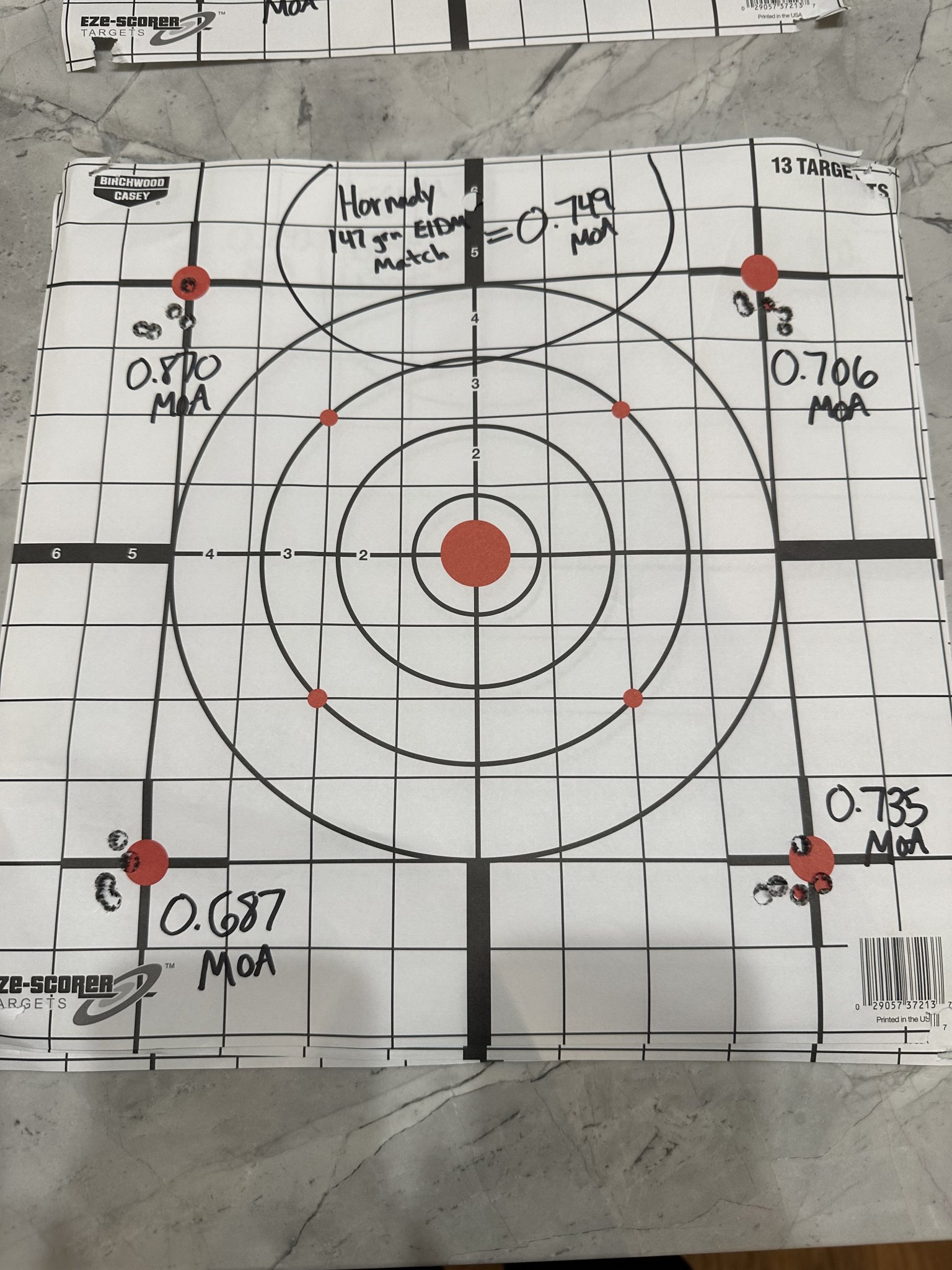

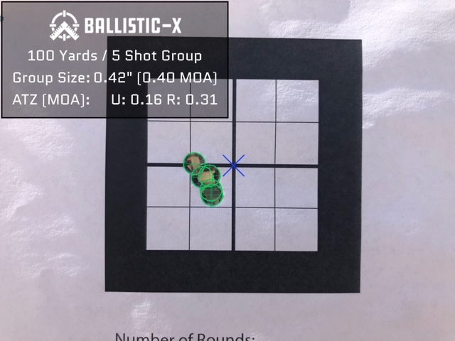

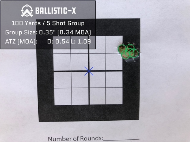

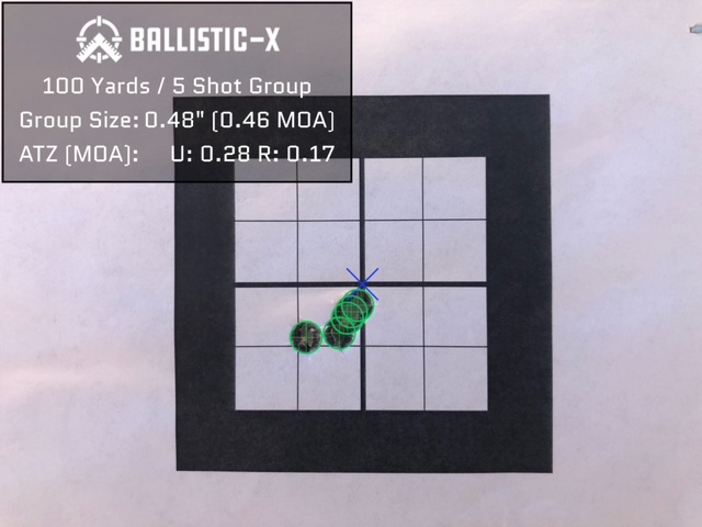

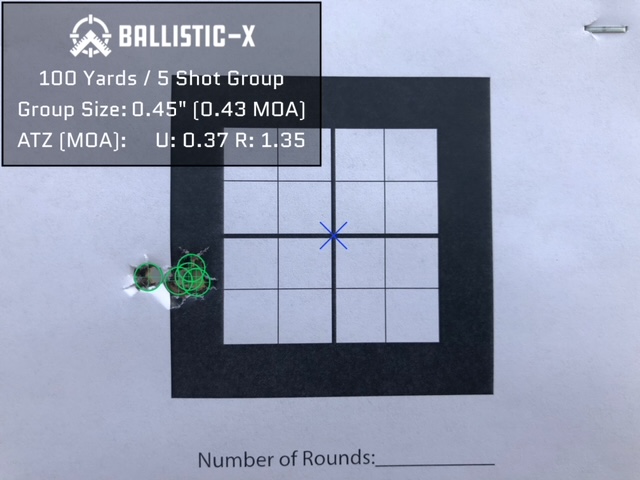

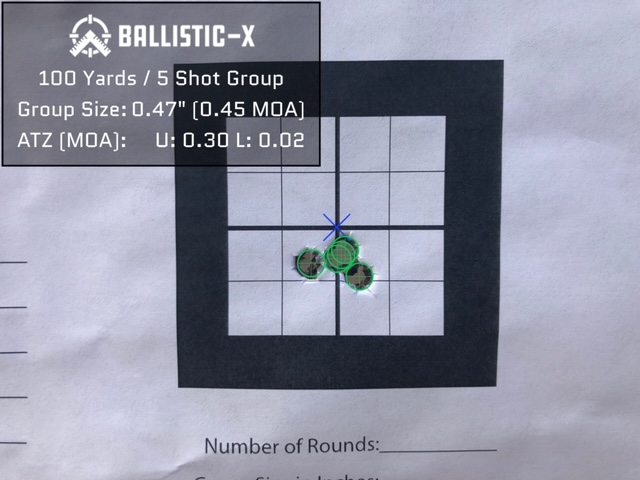

I haven’t been able to load for it yet here’s a good example though 4 factory loads 4 5 shot groups.

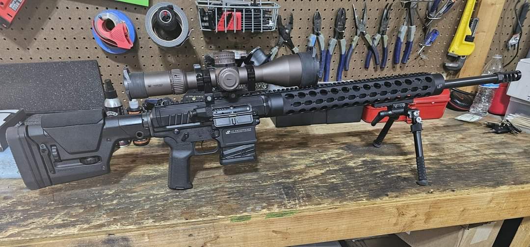

The LRI-20 has a semi Monolithic upper receiver to handguard interface, il increases accuracy and rigidity. It has a integral nut design instead of the exterior barrel nut threads that a traditional upper would.
I built mine with the LRI-20 builders kit and CLE 24" Custom Bartlein Barrel. Average 5 Shot groups are .3 - .5 MOA
Tomorrow I'll be finishing it's Mini-me Small Frame build with a 20" Bartlein .223
View attachment 8266961View attachment 8266962View attachment 8266963
Nice! Can’t argue with those results. @bigjake83 and I have had unexpectedly good results from that Winchester USA Ready 6.5CM ammo.
I know from experience that Hornady’s American Gunner 140gr BTHP also shoot very well through bolts and gassers. Their BTHP just doesn’t have the BC that their ELD’s have, but if they’re all I had, I wouldn’t be upset.
I was shocked by the Winchester stuff. I may buy some for bulk.

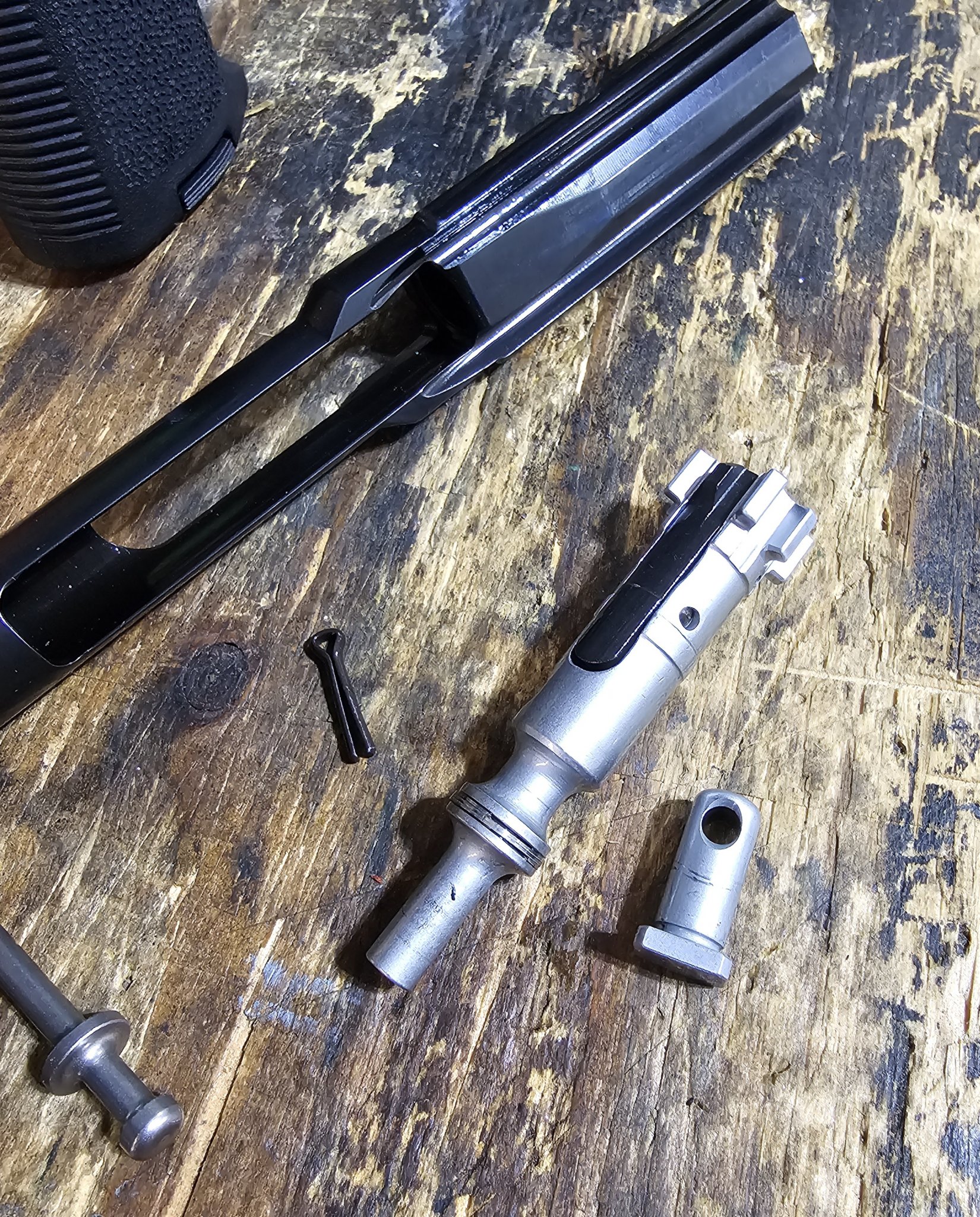

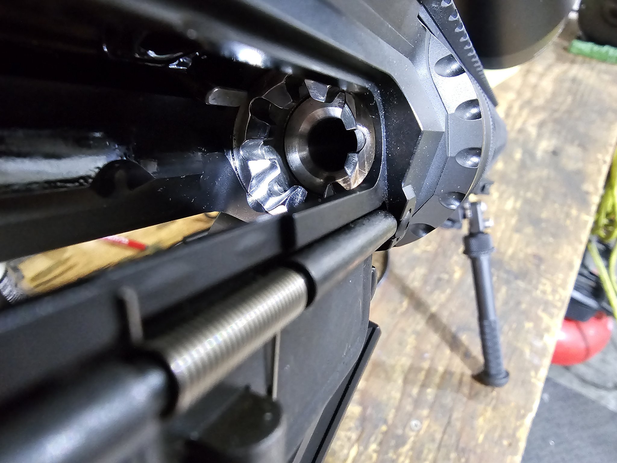

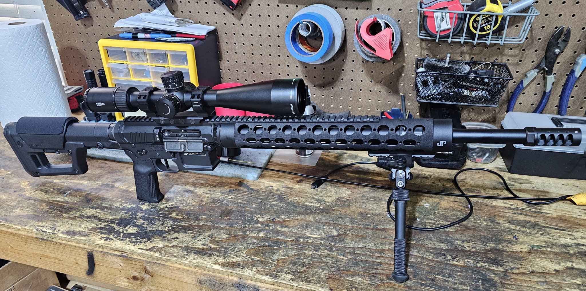

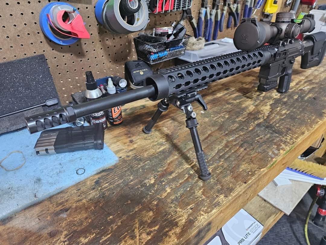

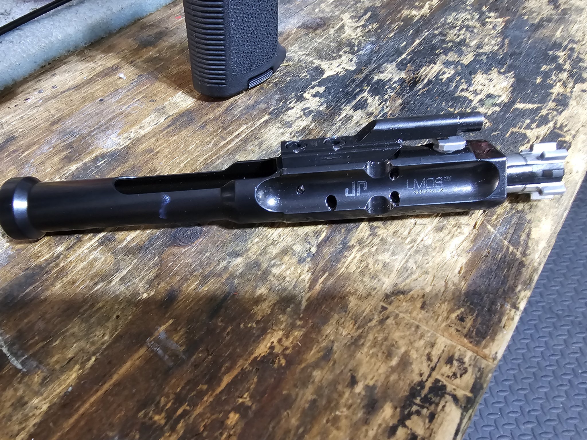

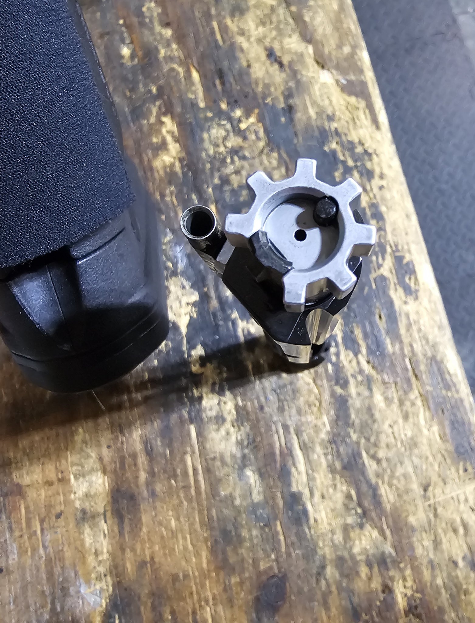

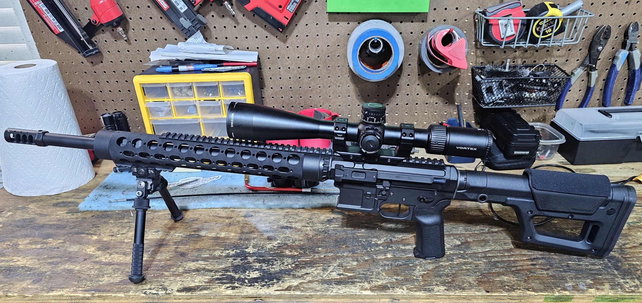

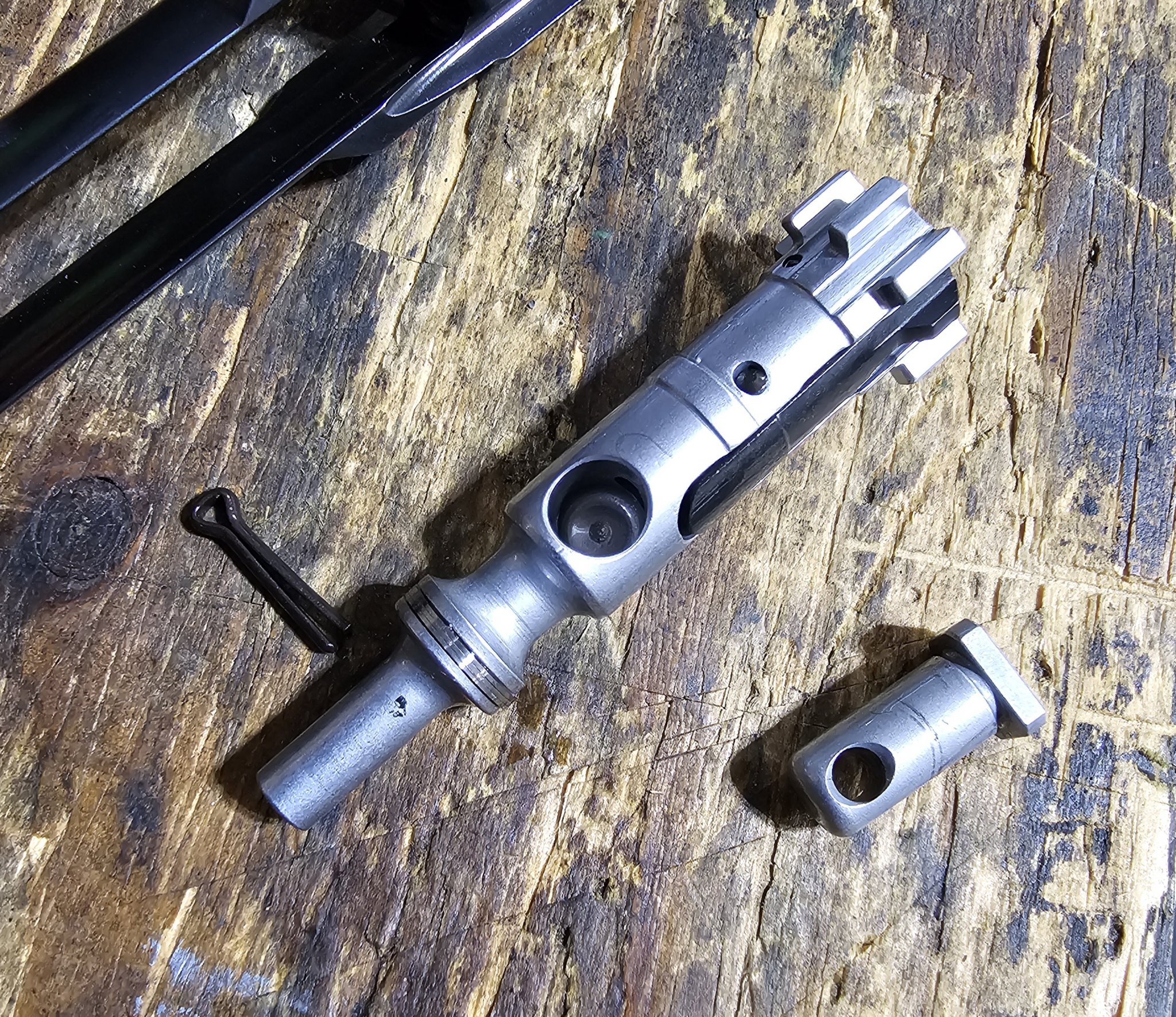

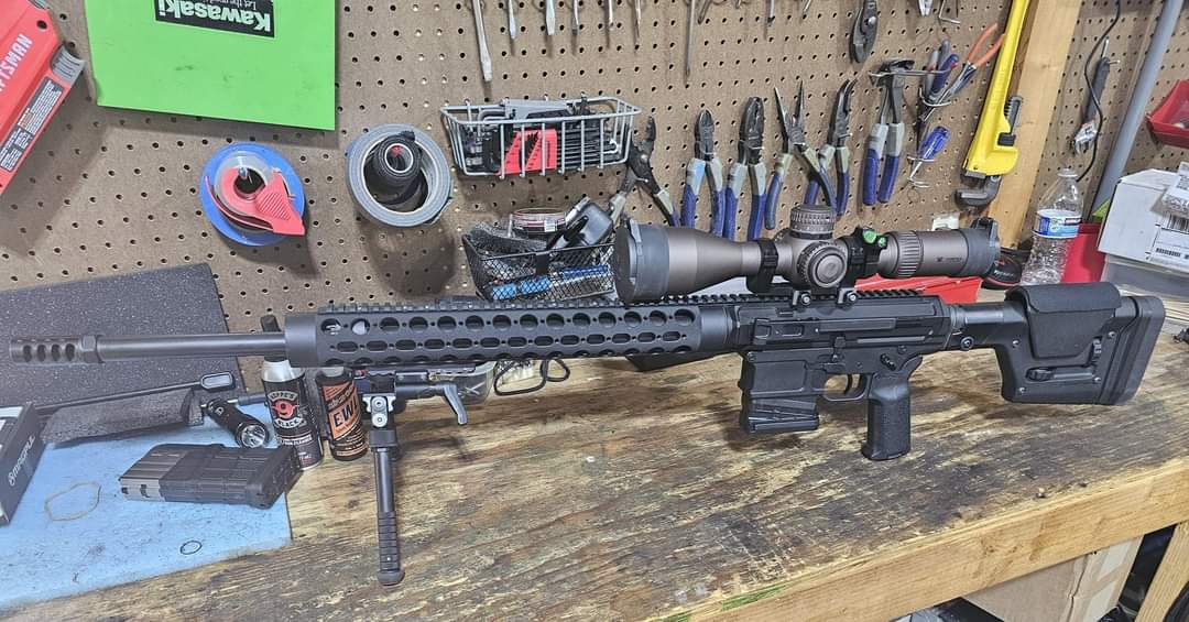

Say hello to my little friend...
JP SCR11/SCI20.
JP LMOS BCG with Young Chrome HMB Bolt.
JP SCS.
JP .875 Adjustable Gas Block.
CLE Bartlein 20" .223 / 1-7.7 Twist / CLE Match Chmber / Rifle gas / 5/8x24 Treads / White Oak Competition Barrel Extension.
Triggertech Diamond Single Stage.
American Precision Arms Adjustable Muzzle Brake.
MagPul PRS Lite

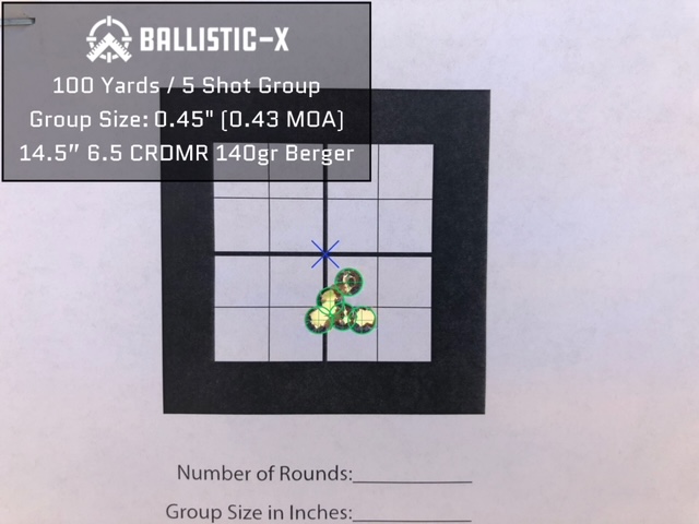

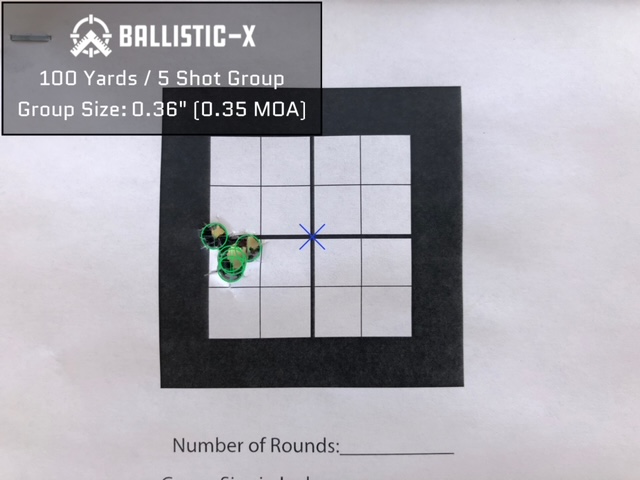

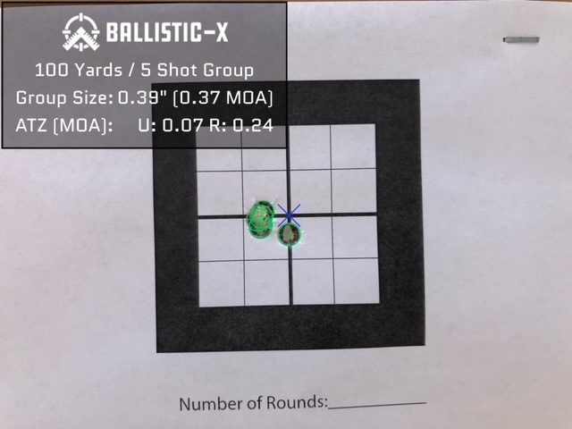

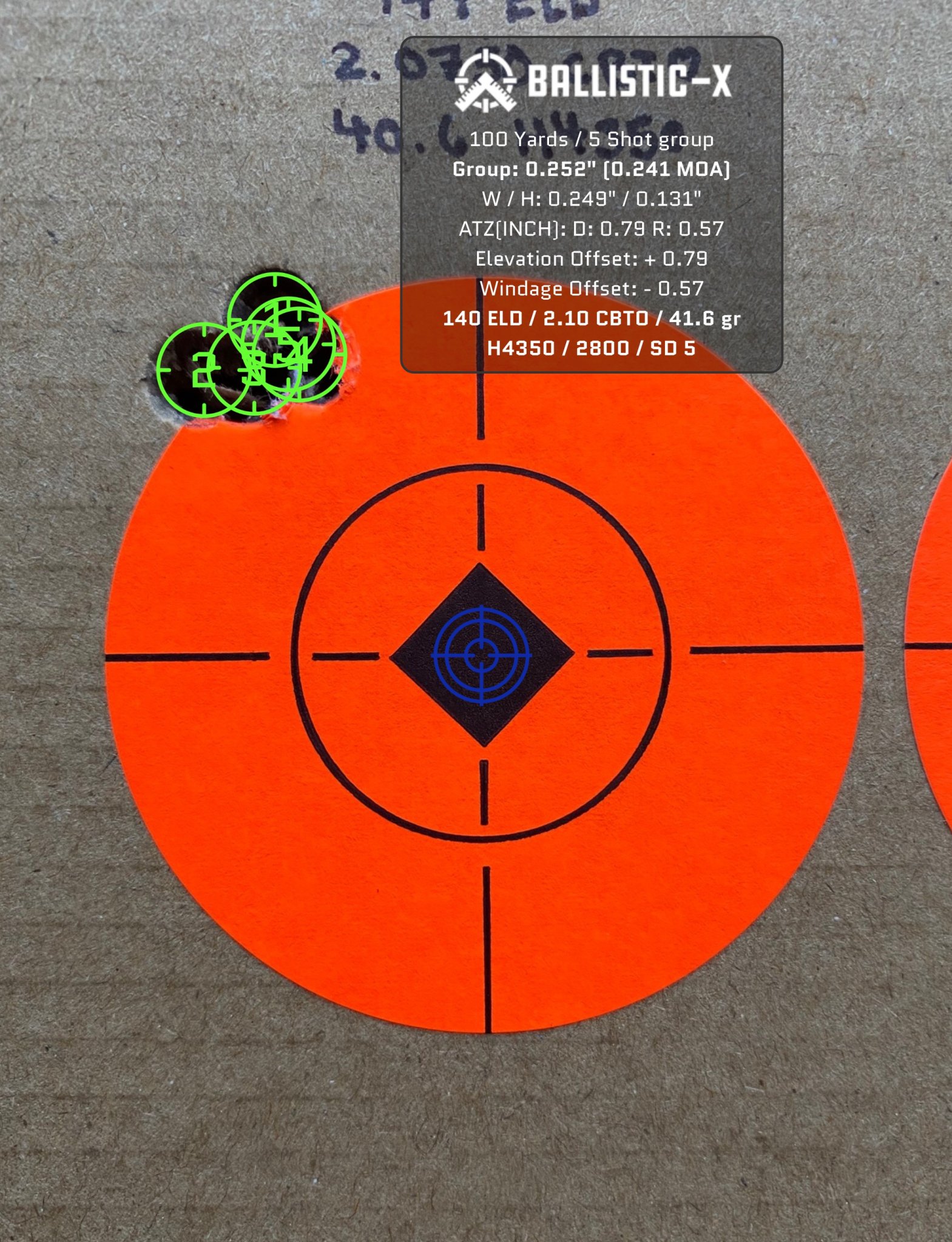

Anyway, here are some pics of groups that I personally shot with various lengths of 6.5 M110s while I was focused on that program. They are definitely not what I would call representative of overall average group size (we comfortably guarantee 1 MOA average of 5-shot groups with good ammo), but this is all factory ammo. And one of me shooting a 16" 6.5 at the Quantified Performance Finale a couple weeks ago.
