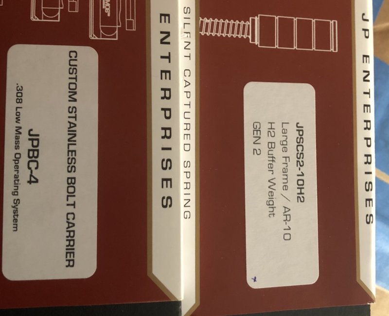

Just to follow up I purchased the jp barrel,bolt, adjustable gas block and operating system. It feeds 100% with everything I tried in it. The only thing I’m not crazy about is the carbon fiber lancer hand guard. It’s very lightweight and good looking but isn’t very solid. To as accurate as I could have hoped with 130 prime.
Full weight bolt carrier or lmos? Did you get one of JP's SCS's? If so, H2 or standard version. I am considering swapping a 308 build to 6.5C
Had related conversation with JP customer support ;last wek. They suggested a VMOS standard weight bolt carrier with the H2 SCS for a 6.5 Creedmoor.
Ok guys so reading what you guys are saying, what can be done to mitigate the effects as much as possible? I've got a build with a 22" Black Hole Weaponry .260 barrel with rifle gas and an SLR adj gas block. I'm just breaking it in, maybe 50 rds on it so far and it is hammering but I'm getting more ejector swipe than normal, primers look fine and the rest of the brass is fine best I can tell. This is done off an Aero receiver set with an Aero HP BCG. Standard rifle buffer and spring. Is a JP SCS and heavier buffer going to help?
Same question here....I shoot a BA 18" 6.5 cm ( is a chopped 20") with rifle length. Flattened primers and battered brass are normal life. So before developing the right load I just decided to try to bring it as close to perfection as the bitch could possibly be so on the Christmas Eve I replaced the original aero non adjustable gs with a Sentry slr 8. Going Thursday to tune it.
Next Padom said either RCA or JP. So next will be replacing the entire Bcg with RCA ( is the easiest to get for me here in Europe) Full mass of course. In the meanwhile a JP SCS is already on its (long) way. An area 419 sidewinder will also join the team, will at least help in reducing felt recoil further. I'd love to hear from the Hide Sorcerers if something could be done to improve a situation which will be never close to perfection not until I will be able to have Craddock to deliver the right tube.
Using Peterson or Lapua brass is just hiding some dust under the carpet as it is reducing the load and shoot 2400ish pills wasting powder time and money.
