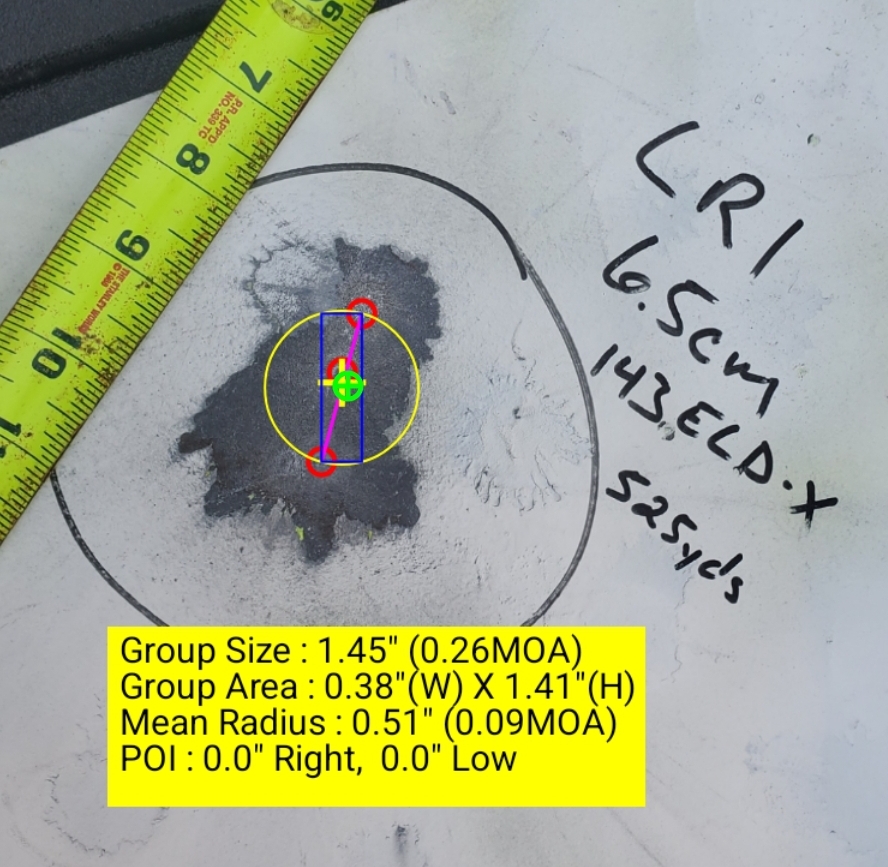

I have 2 good loads in my Tikka T3x compact 6.5cm 20" worked up so far in 143 ELDX. H4350 41.2gn at 2.80" MV of 2565, groups 0.5" or 42.3gn at 2.953" MV of 2635, group size 0.30". Some load manuals say the 42.3 is over max also My lands location may be different than yours so keep that in mind.
