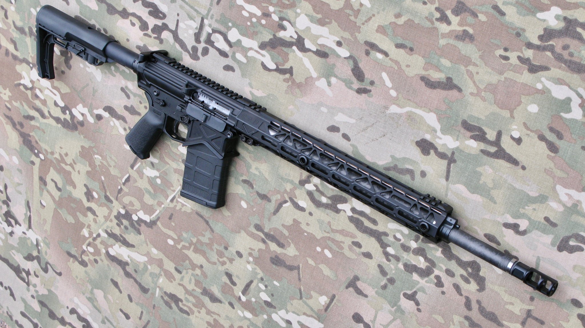

I have been building sub 6 pound AR308s since 2015. My latest came in at 3.9 pounds complete without scope. Currently building a 6.5 Creedmoor upper using a Xanthos receiver. Hoping to be around 5.5 pounds, my Xanthos lower complete is 15 ounces.
First of all NEVER build an AR308 without an adjustable gas block. Go with standard rifle gas length. Also no flash hider, use a good 2 chamber muzzle brake or a 3 chamber brake. I recommend a JP low drag spiral bolt ring.
For a barrel I recommend Faxon barrels, mine have been their 28.3 ounce 16" 308 barrel that has given me sub MOA using factory ammo @ 110 gr, 132 gr, 168 gr and 175 SMKs.
The barrel length doesn't really matter as much now as an 18 inch 5R will give the same velocity as a 20 inch 6 groove.
