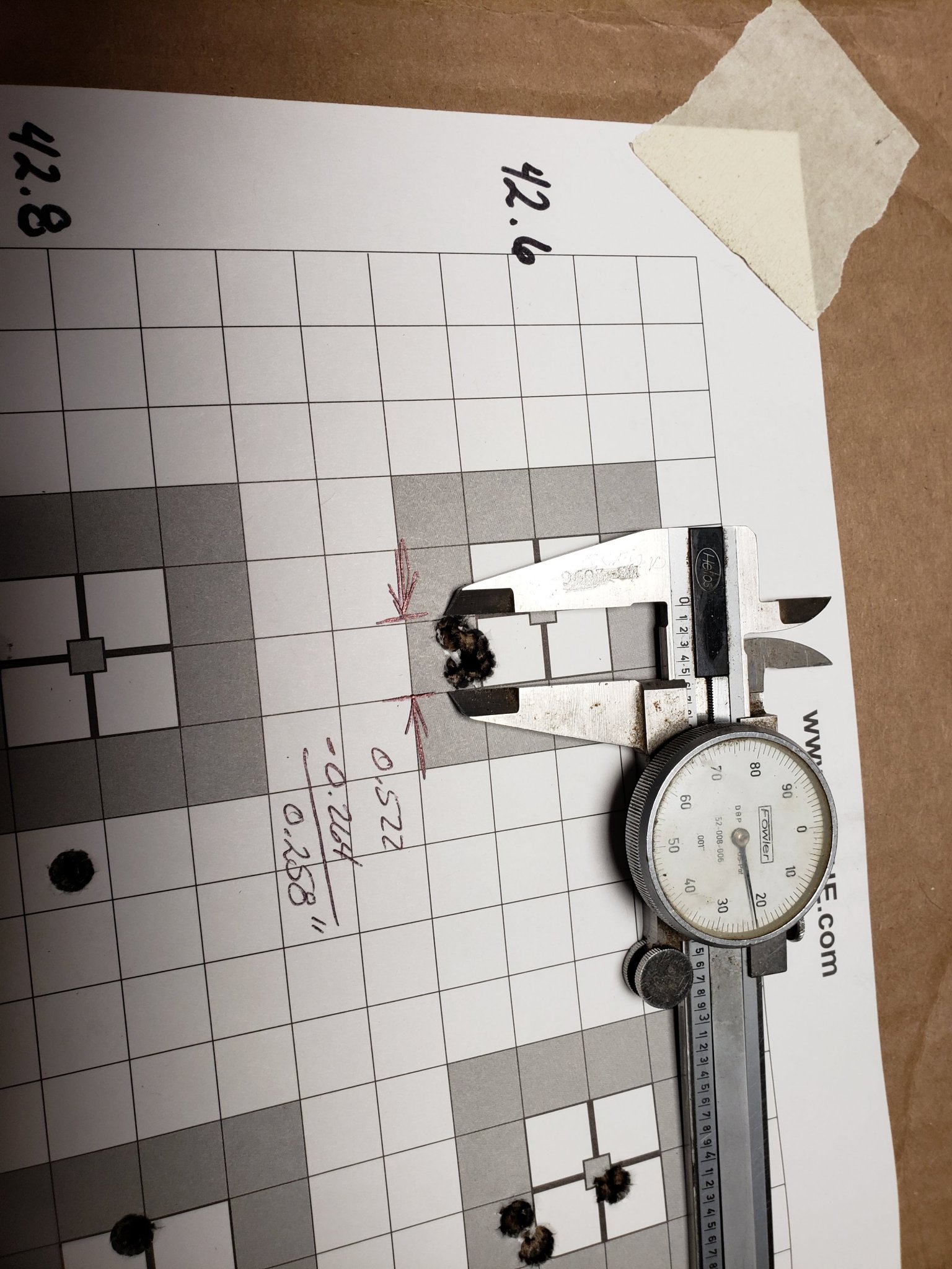

Your gun shoots 1/4moa groups at 100yds? Or you shot one 1/4moa group? That would be the most accurate large frame gasser ever seen....?
Reactions: TACC
Great choice. If you want something smaller and effective put a APA Little Bastard break on there. The only other option I would go with outside the JP barrel setup would be a Bartlein from Craddock. Send them your JP or Rubber City High Pressure bolt and have them do a custom Bartlein for you headspaced to your bolt with +2 gas. Other than that, JP is going to be your best off the shelf option.
This is the target. This was during test load development. Also after barrel break in. 130gr ELD-M over H4350. 0.258" group at 100 yards. maybe it was a 4 shot group. I can't remember.
