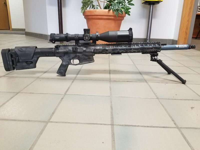

I just had my 6.5 semi out for the first time last weekend and was pleasantly surprised. The gun ran 100% less one round and I chalk that up to screwing around with the dwell time on the adjustable dracos barrel. As far as reliable that is yet to be seen but so far so good. The picture is a cherry picked 5 round group but was the best I had shooting some old Hornady 120 grain Amax match ammo I had sitting on the shelf. I will try to get a group picture of groups like Padom has above when I get some time. That format is a lot more informative 6.5 Creedmoor1.jpg
