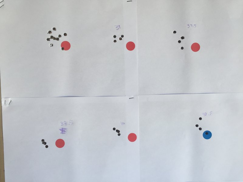

Here is my OCW test results. What do you guys think?
I didn't get quite high enough in my velocities so I think I will re-do the test with different charge weights. However, I don't like how my group opened up at higher velocities. Not sure what to do.

Load 9 is just a good group. I'm not so certain is actually a node.2 and 3 are a node, very close poi and stacked velocity. Only 7fps separating them and single digit SD's.
I think you are also coming into a node at the top. I would be curious to see what 43.3 looks like. If it has a velocity really close to 43.1 and another single digit SD, I would say that would be a great load. I've long since stopped doing ladders and OCW testing. You can find accuracy nodes with a good chrono. No dependency on shooting good groups or interpreting sloughed data because you didn't. Find the stacked velocities and it is quite often a single digit SD and an accuracy node. Play with seating depth to tighten the group.
forgive my ignorance, I am not a seasoned vet when it comes to load development, but what is the difference between a good group and close POIs? It's seems intuitive to me that they are the same thing.
What Birddog said... for the OCW you're NOT looking for "group size" i.e. POI in relation to each other.. Your looking for the poi to be closest to the point of AIM. You re trying to find the accuracy node, a point where the load is stable against minor variations in things such as the powder charge itself. Look at your graph, loads 10-11-12 are showing a flat spot in velocity, very little change in poi and velocity even though you've increased .4gr of powder. If it were me, I would do another round of testing from 42.8-43.3, (as long as you're not seeing pressure issues) take the group with the lowest SD and load a handful (5-7) and see how they group, this time concentrating on the actual group size. Also, do some research to find out what most guys are using for jump for the RDFs (I've only been shooting ELDs and Hybrids so I can't help) then fine tune your groups with that info.
Not trying to nitpick here, just clarify. You are not looking for POI to be near point of aim, you are looking for 2-3 loads that impact to the same area on the target (for example 3 loads throw high and left). You are looking for a pattern in the barrel harmonics that gives you a margin of error to be off on your powder charge by .2 or .3 grains and still impact in the group. This node should also provide a certain amount of temperature stability.

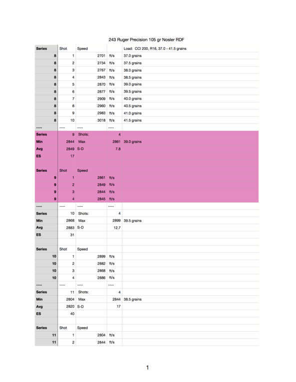

Here is my weekend outing data. I was using the method the 6.5 Guys had posted in youtube using velocity to locate the nodes and go from there. The first 10 shots were just one shot of each load for velocity and then the most consistent loads I shot and chronoed again. I wasn't really looking at my groups too much as this was virgin brass and I had to seat to mag length for the RPR I was shooting out of. I'll need to adjust my seating lengths some but I expect I'm about there. None of these loads showed pressure signs. All shots were taken with the Magnetospeed mounted so I'm not sure how much that would affect group size anyway.
