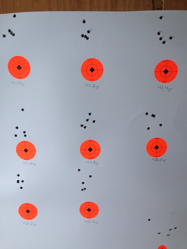

Went out this morning to run a OCW test in my 6.5 Tikka CTR. I'm a bit lost because I was expecting to see some POI shifts but it looks like the POI remained the same through the entire test. So what load would you start working around? 41.4gr obviously had the tightest group but I know I'm not looking for groups just similar POI. I used virgin Lapua brass, 140gr ELD-M bullets, RL16 powder and CCI 450 primers. COAL is 2.865" which puts me .02" off the lands.
I'm assuming that was 100 yards?
If so, try at 300.
Or maybe you're a lucky bastage and your rifle like just about anything so you can just pick the one with the smallest group/ES/SD.
This why I do these at longer ranges, you just get more resolution in the vertical. In my limited experience with R16(and only with 147’s), the 41.4-42 grains is about where you should be for pressure. There is vertical shown here, however slight. Also, don’t disregard group size. Looks like everything after 42 gr, with one exception, is opening up a bunch. Id be exploring 41.4-42.
That's pretty close to my sweet spot
My T3 Tac with 26" Bartlein likes 41.70gr of RL16 with SMK's 142
Avg 2820fps, ES 20, SD 8.0
CBTO 2,1900 (-80thou) .289 neck
I was able to make it back out again today, this time with my magnetospeed. I shot these 5rd groups @200yds and here's what I got.
41gr
avg 2643
SD 13
ES 34
41.2gr
avg 2650
SD 14
ES 34
41.4gr
avg 2664
SD 12
ES 31
41.6gr
avg 2684
SD 9
ES 23
41.8gr
avg 2697
SD 13
ES 35
42gr
avg 2713
SD 9
ES 25
42.2gr
avg 2726
SD 7
ES 21
42.4gr
avg 2744
SD 5
ES 15
So 42.4gr load gave the best SD and ES numbers but one of the worst groups. Would playing with seating depth shrink that group and keep the lower SD and ES or should I try tweaking the 42.2gr load since the group was already sub MOA?
