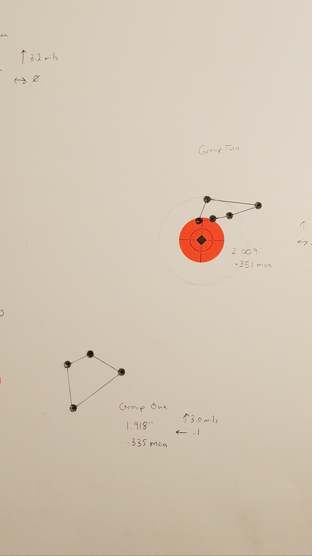

    Here's a couple groups at 500m with load developed exactly as described above.
