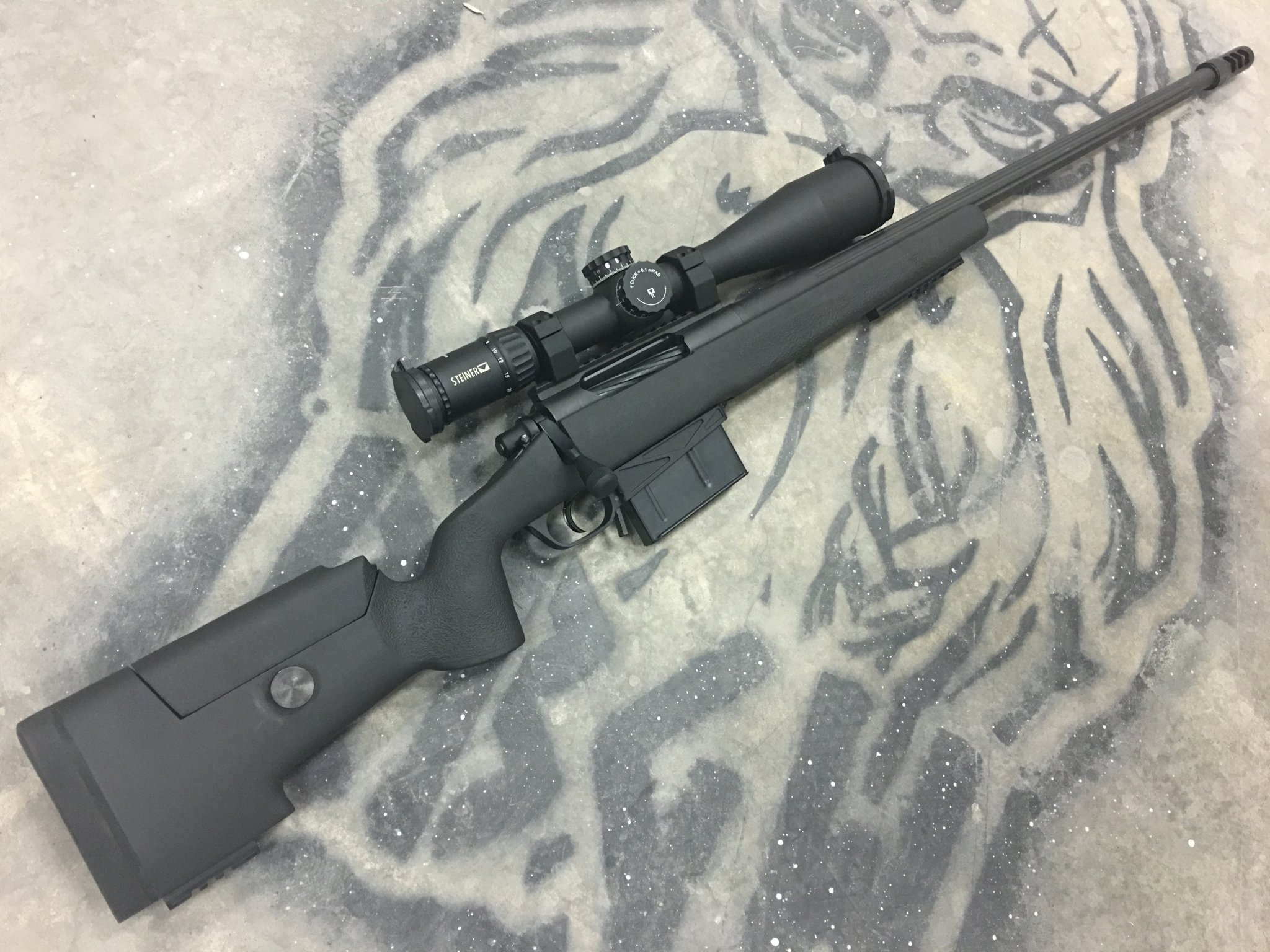

Lol, although I could be considered a little biased due to my current 300 Norma build below.
Berger ammunition is hitting retailers at a fairly good pace now and of course 6.5 Creedmoor is less than the 300 WM, and WM is roughly half the cost of the 300 Norma if its any concern.
However, Berger confirmed that they sourced the 300 Norma brass from Lapua :cool: which I believe makes it a good value for those who reload. 300 Norma1.JPG300 Norma2.JPG
