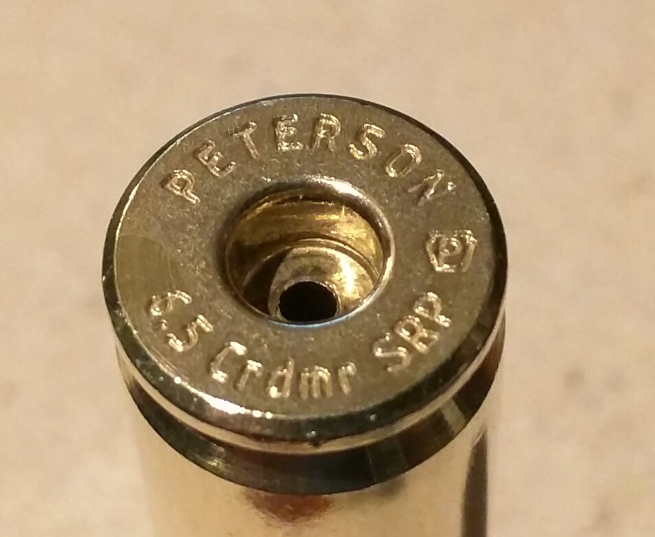

Recently picked up a few boxes of this brass to compare against the Lapua SRP brass I normally use due to seeing some good reviews and wanting to find a solid, US made precision option. After reading that this brand probably had a smaller interior capacity than my Lapua, I did some H20 testing that confirmed that this lot, which tested extremely consistent with <.6gr deviation in empty weight, did have about 1.3gr less H20 capacity than my current lot of Lapua.
I loaded up several ladders of H4350 for my AIAX using 147gr Hornady ELD, starting at 40.5gr and moving up to 41.8gr in .3 increments (I normally shoot 41.5gr using Lapua and get ~2750 fps with great accuracy in my 26" Bartlein barrel out to 1000+ yards). I loaded them straight out of the box given that they looked pristine in the way they ship, so didn't do anything from a resizing standpoint.
It was a cold, damp day up here in CT at 40 degrees so didn't expect to see blazing speed but was a bit surprised that even at 41.8gr H4350, I was below velocity of my normal Lapua loads, averaging 2744 fps with an SD of 3.7. I figured it was a combination of the neck tension of brand new brass and the weather.
I didn't get any flattening or cratering of my CCI primers, or hard extraction,
but noticed what looked like some extractor marks on several pieces, regardless of the load. It happened on a few of the lightest load. Not sure if this means anything but thought I'd get some input on whether this is a potential pressure issue or something else.
Appreciate some thoughts.

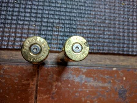

Ejector marks usually are what looks like a high spot on the head of the case that’s much more shiny than the rest of the head. It is usually round as most rifles have a plunger ejector in the bolt face. You can see in the pic here a typical ejector mark on the 308 Lapua case. This is caused be either too much pressure in your case forcing the brass to flow into the ejector hole, or can also be caused when you bump your shoulders back too far with a sizing die, which creates excessive headspace.

thanks for the clarification and pic. The impression is not raised but looks more like a "swipe" or scrape. Hope the pic below makes is a bit more clear:
Definitely looks like a swipe to me. It I’m not sure how you get ejector swipe in a bolt gun. I’ve seen it in an AR plenty of times, but never a bolt gun.
I’d try a Google search and see if anything come us. I’m curious now.

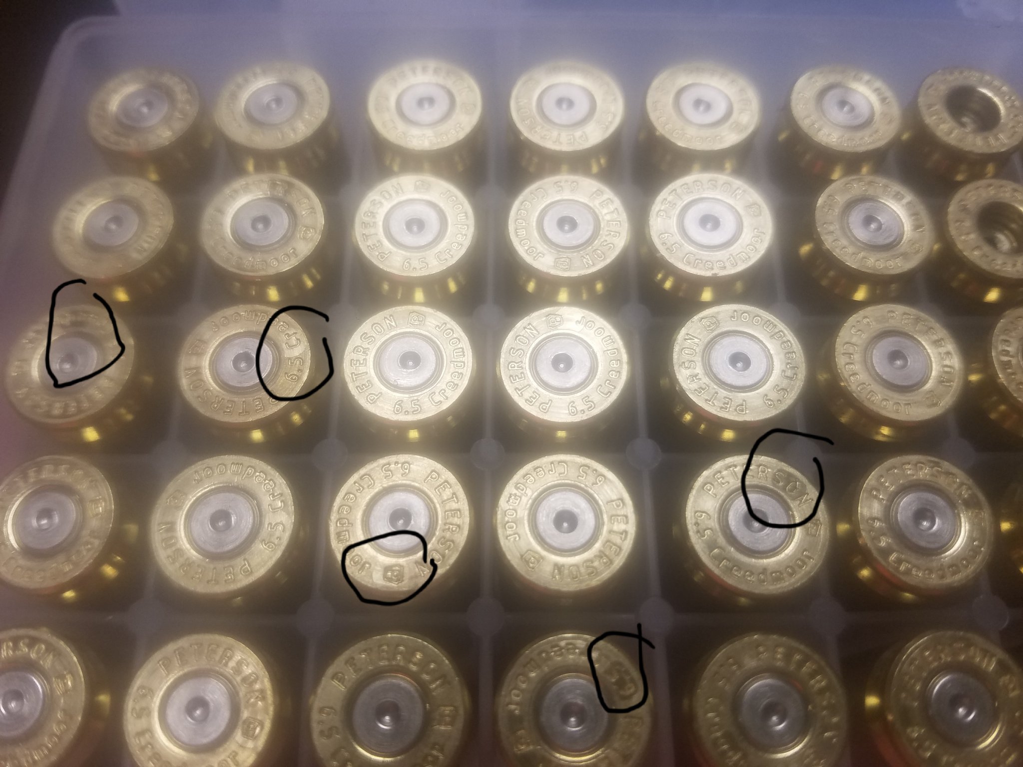

I got a few swipes when doing OCW @ 43.5 grains, pulled my bolt and found a little bit crud between the ejector and the inside bolt edge. I cleaned the little bugger out and zero issues from then on.
Easy bolt, no more markings anywhere, primers just starting to flatten just outside the primer strike (SFP) bolt @ 44.4 and shooting fabulous in a 20" Proof.
I checked my bolt last time out and found some debris in there, too. Looked like tiny brass shavings, maybe from the swipes during past sessions. Cleaned it out and am not seeing much of an issue any longer. Getting good groups with single digit SD so guess I can deal with small swipes if they continue. Will be interesting to see how long this brass lasts. I'm AMP annealing after every shooting and up to 7 reloads. So far, so good.
