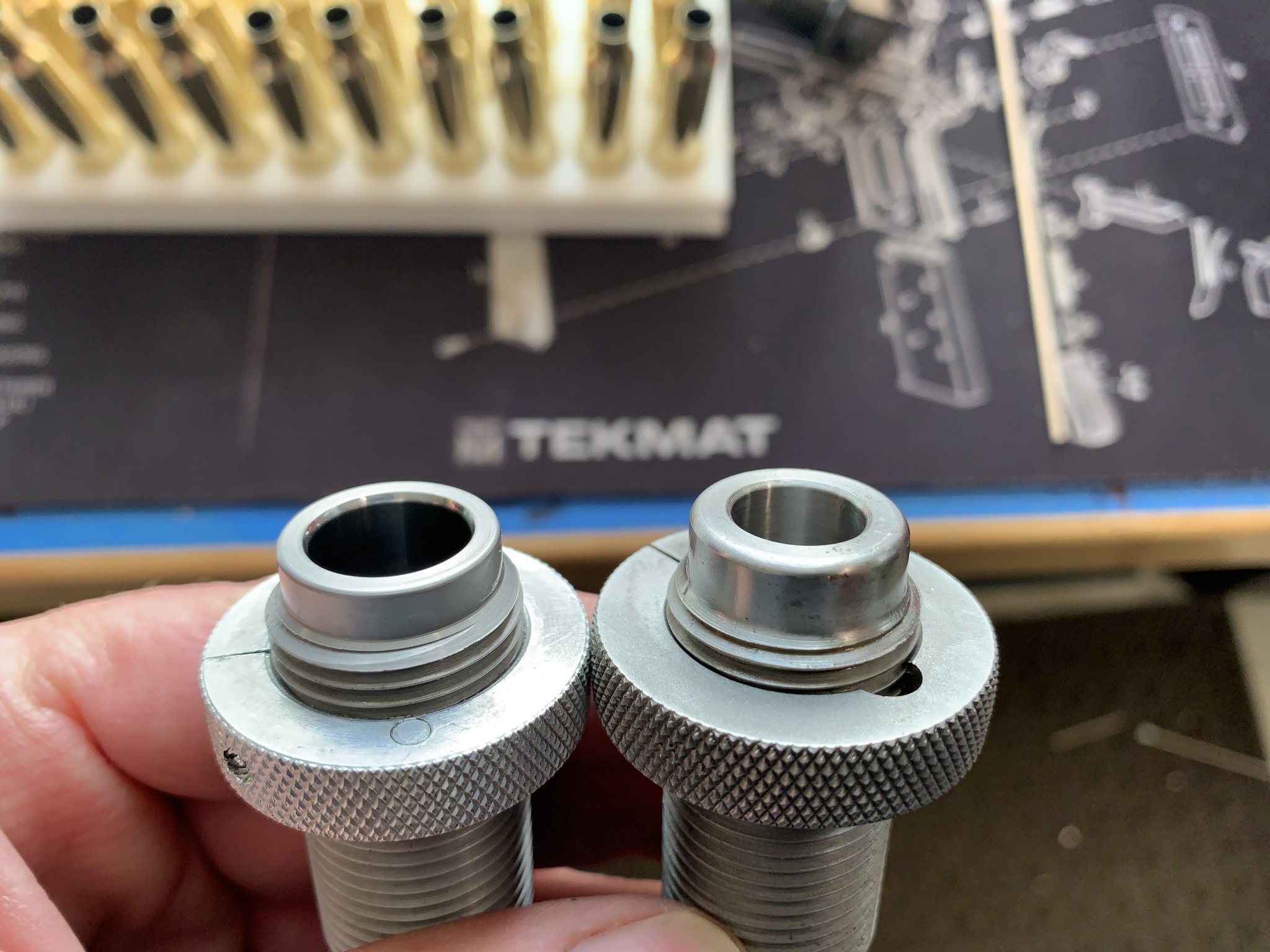

The Redding seater is nicer than the Hornady seater, but you’re gonna pay for it. The Redding sizers are very mediocre compared to the Hornady, and twice the price. Poor internal finish, lube hungry, and an absolute garbage decap rod and expander design. Hornady’s drawback is a limited cartridge menu, where Redding is almost limitless. Fortunately you can buy the individual dies so mix and match as you like. Forster makes nice seaters too, and well priced.
Guess which one is the Redding.

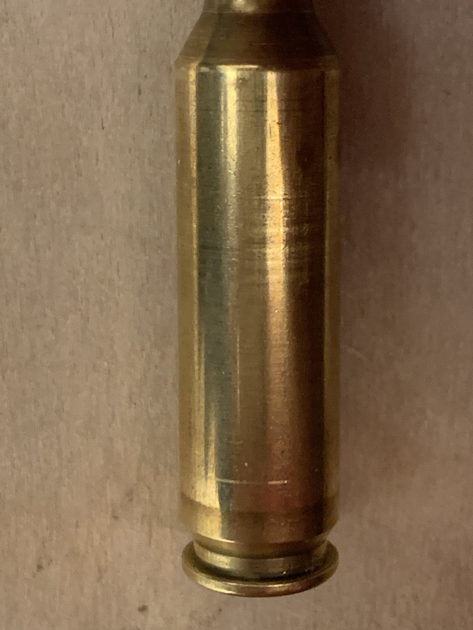

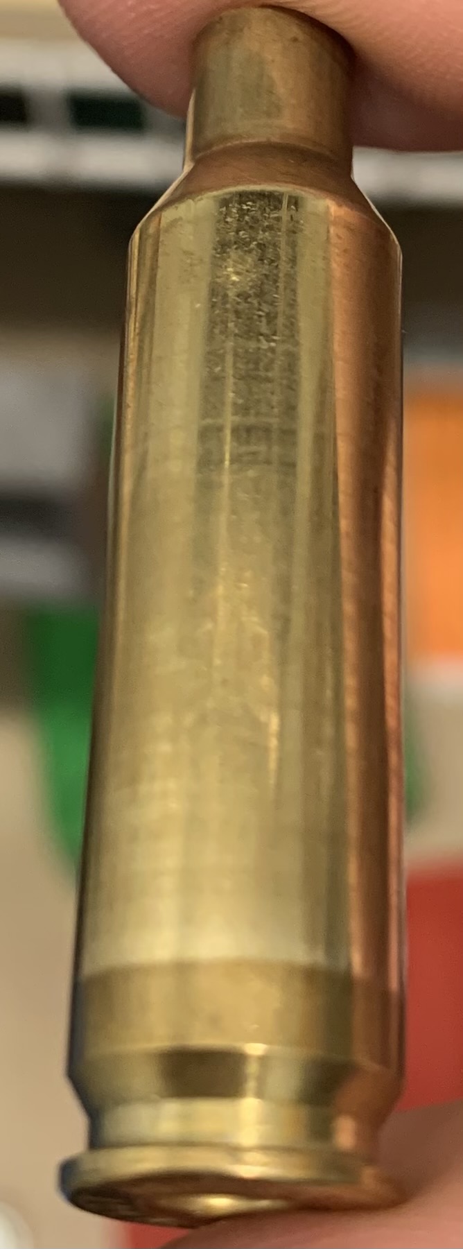

Now, this is where I can't figure out what is going on... The Type S die was leaving these horizontal marks throughout the case body, along with these spots near the shoulder as seen in the picture on the right. The brass was also brighter on the resized portion, almost like it was shaving it off. The Hornady did not do that. Is this normal? Am I doing something wrong with the Type S? Does it need some stupid amount of lube? I used about the same for both.
Left = Hornady, Right = Redding
Redding (the bright line close to the bottom is from my concentricity gauge, it's not head separation hehe)

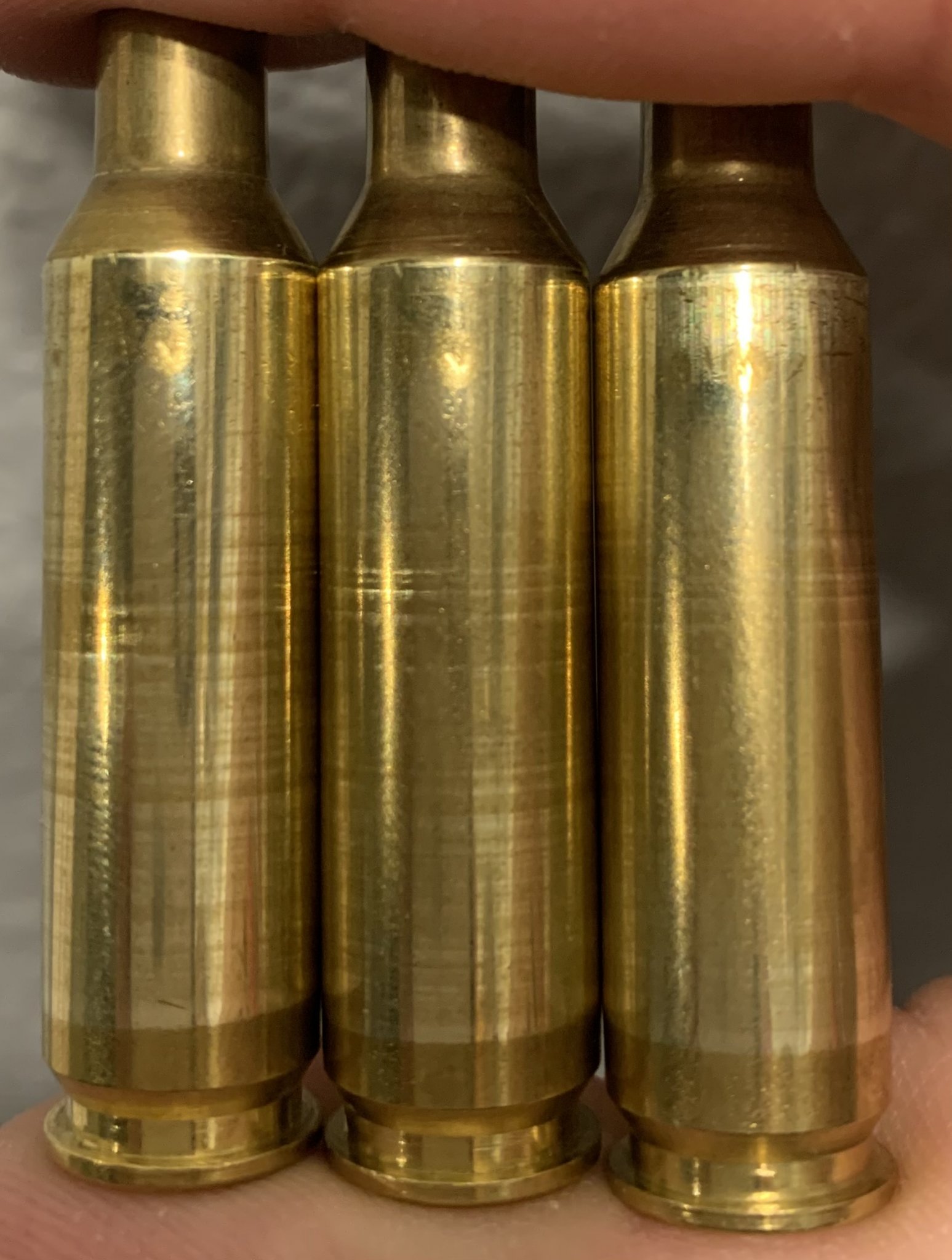

Here's some more pictures of 6.5 CM brass resized by the FL Type S die. It's as if the brass is being stripped... I originally cleaned the die with CLP, cleaned that all out, and used Imperial case wax as I mentioned above. Same method I used for the Hornady FL bushing die.
I would personally either run the Hornady dies or jump straight to Whidden. The Whiddens are much better at correctly sizing a case in my experience. The Reddings I had/have were trouble from day one and their customer service was not responsive to any emails about it.
Like I said (and showed)above, Redding has a shit internal finish, and they charge you twice as much for it. Fwiw, if you buy one of their custom $200 type s dies, it will have the same crappy finish. They long ago stopped living up to their reputation and price point.

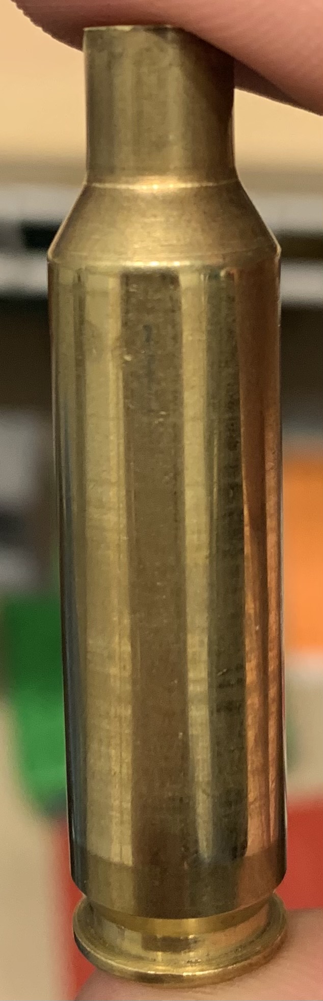

Here's my final attempt. I cleaned the Type S die with bore cleaner, grease remover, a nylon bore brush, bore mop, and Q-tips for final wiping down... to no avail. It was a little more smooth, but just doesn't feel quite right. The below picture is more clear than the others, and shows that it puts a bizarre spot (the shiny circle in top center of each case) near the shoulder. I've never seen ANY sizer do this magic. And with that, I surrender lol.
Stop punishing yourself.
