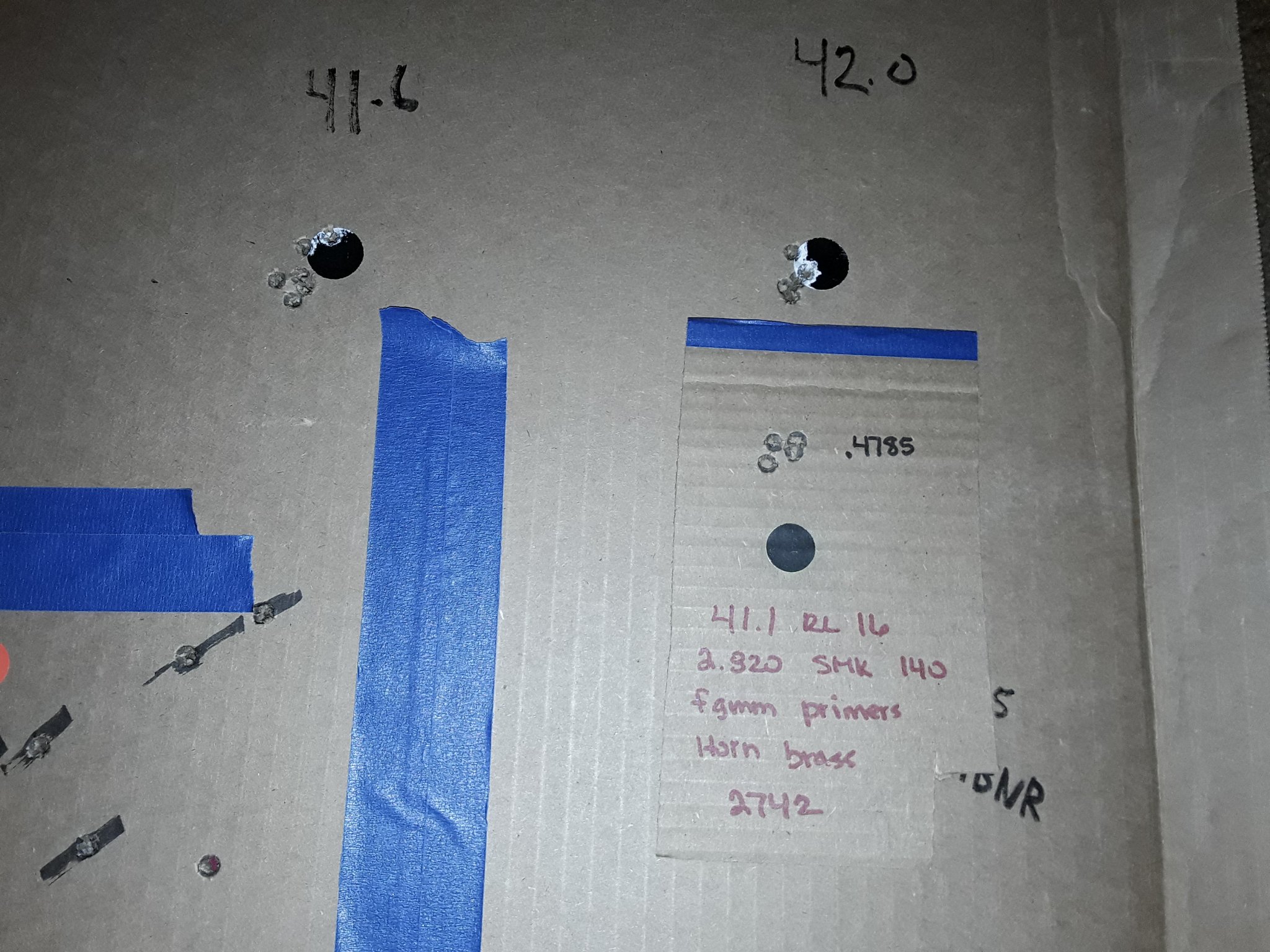

Top group is same components but with 42.0 RL17
Bottom group is as written below the group. Both are 5 shot groups
Nice. I'm not far from that. If I can get it there time to go do some F Class... I may back off to 2750 just to see if I can find a good node..
