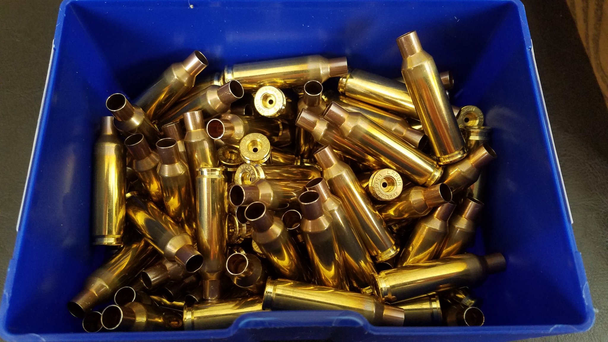

I had on hand 100 rds. of this that I had never done anything with, then this AM there was another 120 rds. with boxes my Partner in Crime found in the bucket at the range so I brought it home. so I think once fired.
I had 20 rds. given to me months ago and I reloaded and shot it several times and so far it has been good, primer pockets still tight.
I am sure it is not the best in the West and others are better, but for short range plinking out to 600 it seems to be OK.
What can you tell me about this? Do they produce their own brass?
It seems like it is a cheap round for entry level shooters to use to get their feet on the ground, and the factory loads are not very consistant, in my experience, but they go Bang every time.
Tell me what you know. Regards, FM

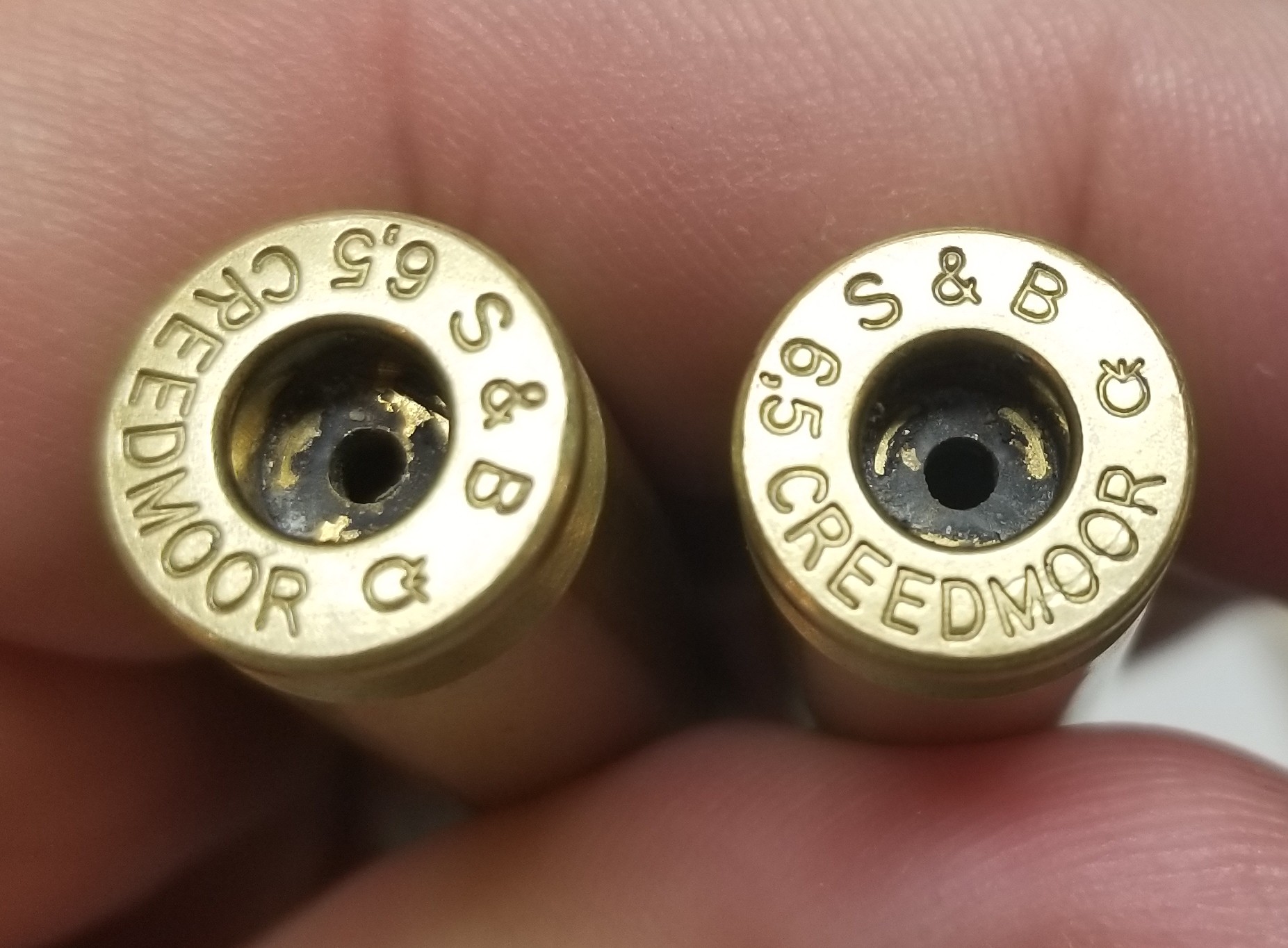

The only issue I've had is that the primer pocket crimp needs to be removed. You can't see it, but it's there.

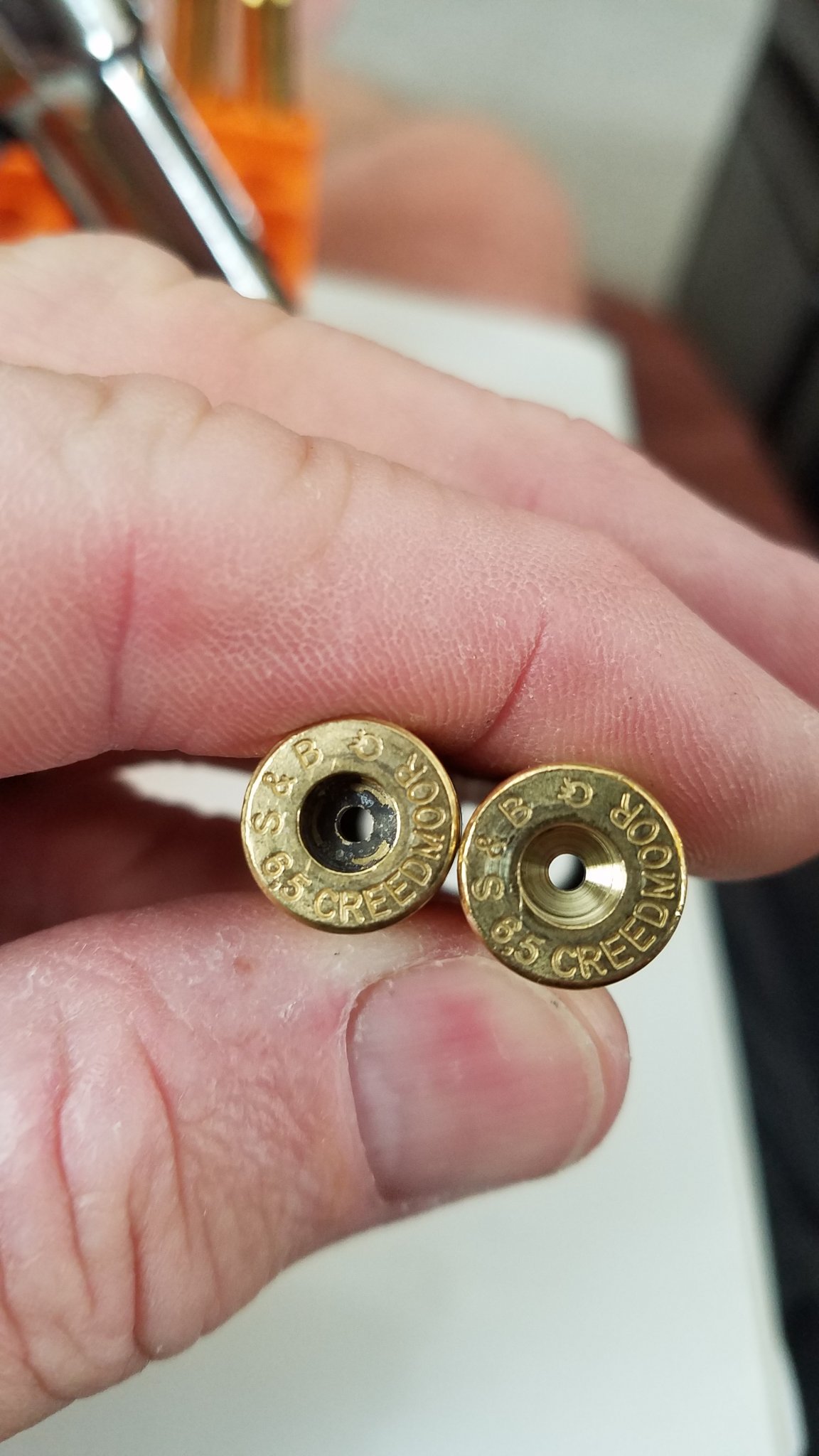

Primer pockets are super tight. So much so that a WLR will not go in unless the outer edge is bumped with a crimp remover. Like this one.
It cuts a very small ring off of the lip and primers go in without a fight.
I'm just going to do all of my S&B Creedmoor brass with it.
I also hit the flash holes with a deburring tool. Most times, there isn't any burr.

The primer pockets on the S&B brass are crimped, just like Federal 223 cases.
You can see the crimp on the unworked case from the 2-9:00 position.
The case on the right has had the crimp removed and the pocket uniformed.
The pockets are so tight, that it left a mark on the case head as if it had hard extraction. That was from the RCBS primer pocket uniformer.
You can see where the crimp remover cut a wider radius along the edge of the crimp on the worked case.

My rifle, a Remington 700 with factory barrel slightly craters primers with starting loads and with max loads. The primer edges are still rounded and extraction is easy with smooth bolt lift.
I'll live with it until it becomes an issue.
Are you just using the Hornady deburring by hand? How long were those rounds purchased? I'm new(er) to reloading and this is what mine look like - I would not have guessed that these were crimped. I was about to start loading some of them this morning for the first time and stumbled upon this thread after reading the more recent thread in the bolt action sub-forum.

There is no primer pocket crimp on S&B brass that needs to be removed. The beveling around the primer pocket is minimal and may pose an alignment problem with some primer tools. I never had a problem seating primers into this brass.
Looks like good ignition to me. Clean the primer pocket and go again.
The S&B brass does have a tight primer pocket but I have never had to do anything more than but put a little more grip on my priming tool.
Your cases don't look like there is a crimp present.
Maybe they changed their process.
I've got about 100 of a newer lot and I'll check for a crimp on them.
As far as the older lot is concerned, it is definitely crimped.
