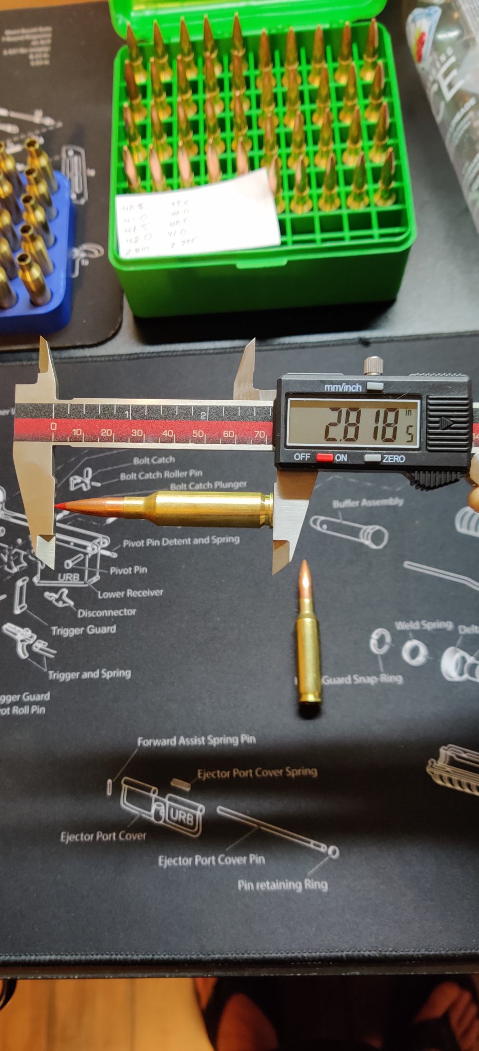

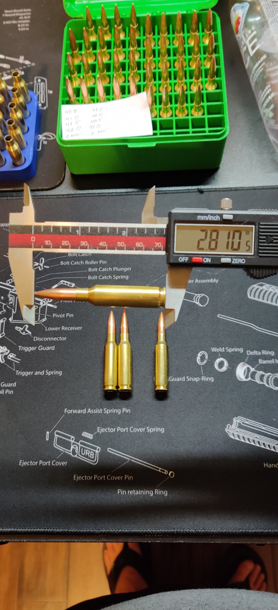

Need some guidance.
Working up some loads for my HMR using 140 Grain HPBT from Sierra. OAL is 2.810". H4350. Did 5 of each @ 40.5/41.0/41.5/42.0. I also loaded 5 of each with the Nosler Custom Competition HPBT @ 39.5/40.0/40.5/41.0 but OAL was set at 2.775" according to Nosler's data.

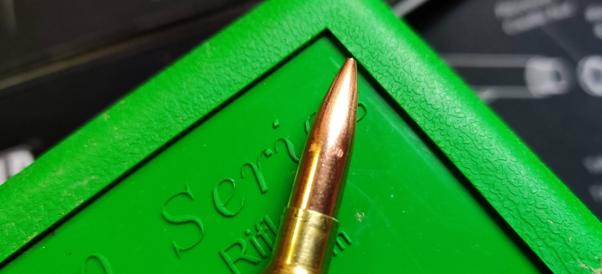

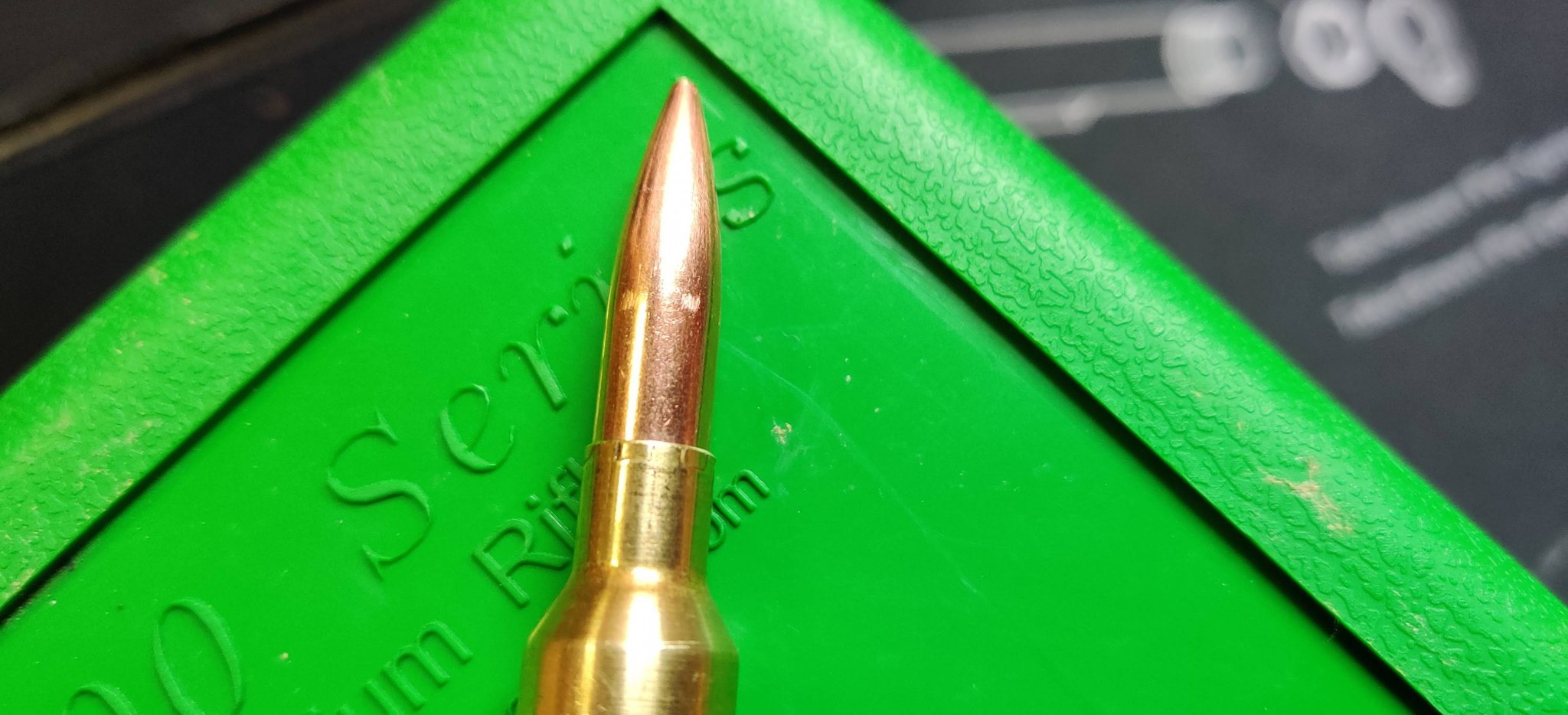

Problem is, I took one of each load and cycled them through the weapon. The Nosler's cycled just fine. The Sierra's did not. They were tight going in and locking the bolt. Each bullet has what appears to be marks from the lands on the bullet? I checked the OAL before and after chambering and it's exactly the same.

I backed a few down to 2.80", and they go in a little easier, but all are still hitting the lands. I ran a black marker around the bullet and you can see where it's still hitting.
If I go any lower, I'm worried about over pressure.

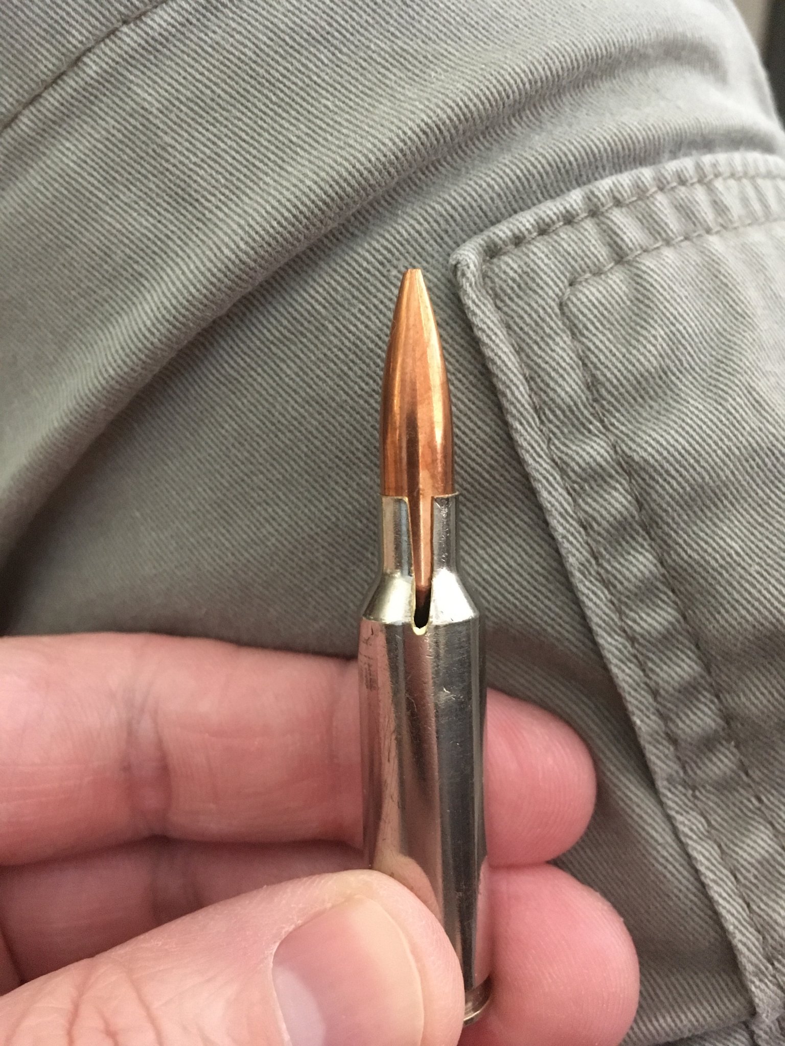

I do the slit case trick myself though I don't normally cut past the shoulder. Once you've cut the slit in the neck resize the case and seat a bullet long. When you put it into the rifle and close/lock the bolt it will push the bullet back into the case. You can measure the length of the assembly and it will tell you where your contact point is. I normally measure the overall length then using my kinetic bullet puller I pull the bullet out just a little and try again. I average a few of the checks and use that as a max overall length with the bullet in contact. Usually I seat shorter than that by a few different lengths and test fire some groups to determine what the best seating depth is. Some bullets don't mind being seated 80 thousandths off the lands and others need to be close to be accurate. It can make a big difference with some bullets.
Thanks 918V for posting the pic.
Frank

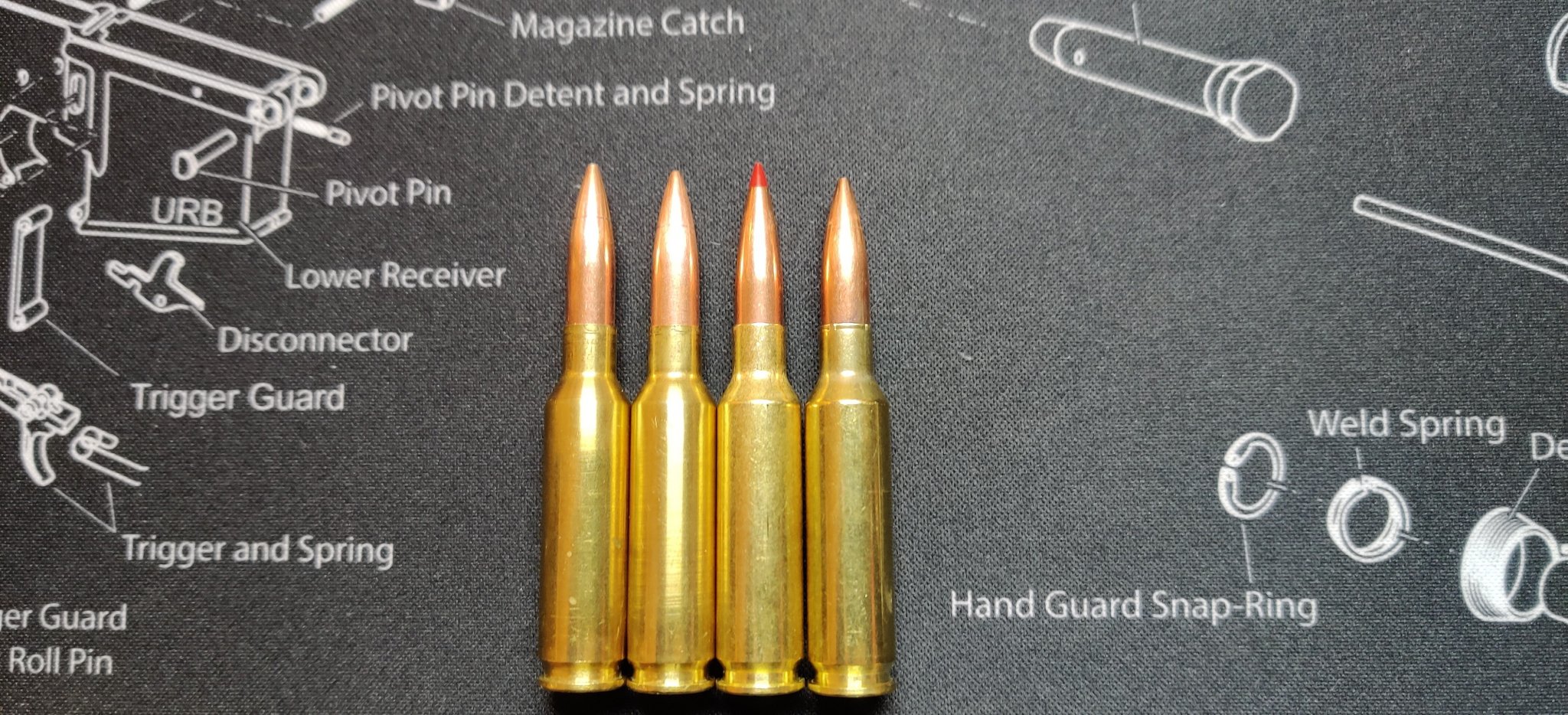

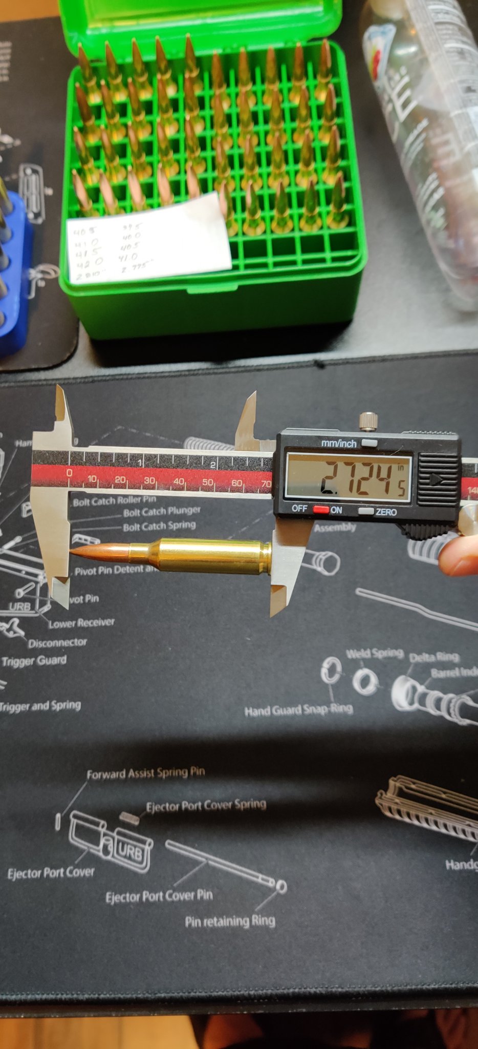

Thanks again for all the help. Tools arrived today and I figured it out.
Took an average of 3 lengths with the SMK O-Give
2.263"
2.263"
2.264"
Average 2.263"
.020" off the lands to start. Puts me at an average COAL of 2.760". All rounds cycle excellent and have plenty of room in the mag. 2.243" off the O-Give.
Y'all were spot on. Measuring off the O-Give gave much better results. Extremely consistent.
Thanks again everyone for their input.
