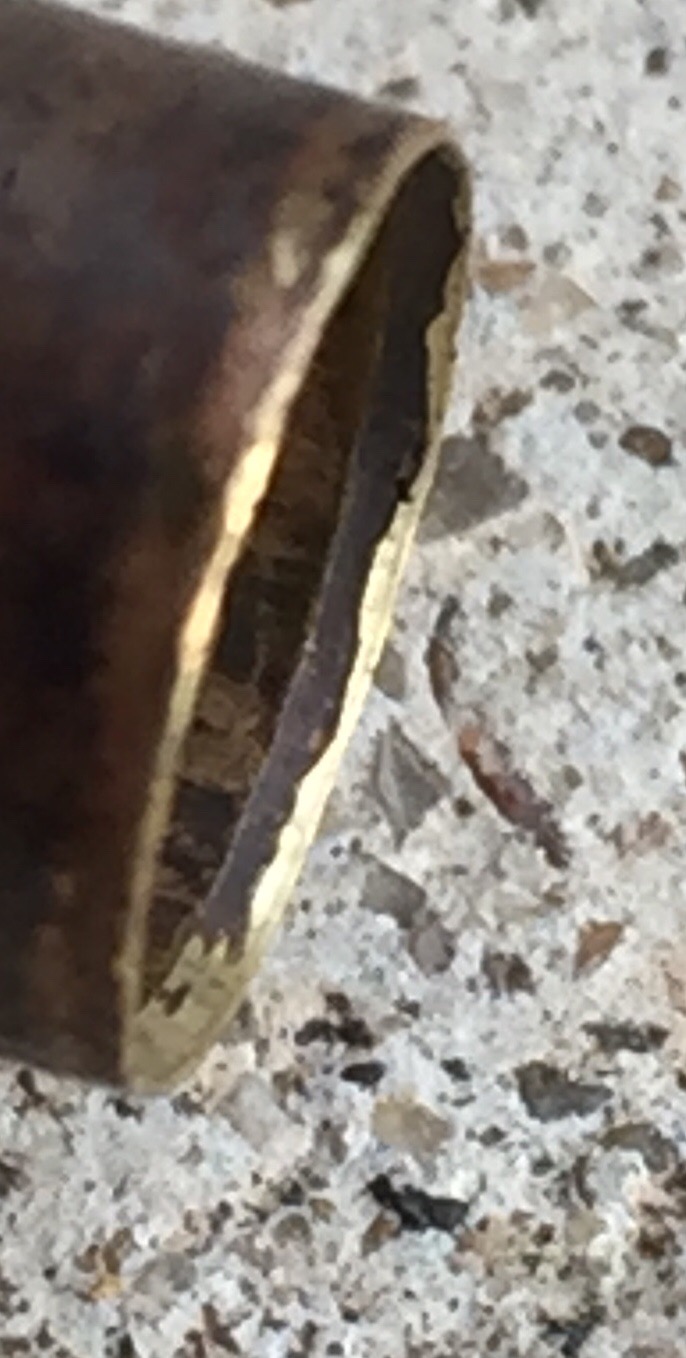

Ill try to get a pic later tonight of what I mean and update this post. Doesnt take any of the length off at this point, my brass has almost stopped growing any appreciable amount it seems, but the cutter will still scrape some sooty sections on the chamfer clean and shiny. Not the entire way around, just the high spots.
Edit:
Tough as heck to get a pic of something this small. Didn’t give a full chamfer and didn’t take any measureabke length off but still knocked some spots off. If it grows enough it will give a full chamfer and deburr along with taking the length off. Otherwise it just pops the high spots.
