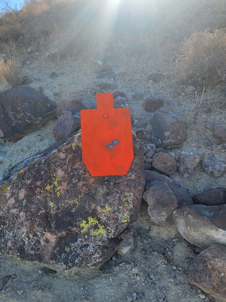

I shoot a 7.5 twist PVA Osprey with a 130 berger at 2950. heres two at 899 yards on a 60%ipsc target

I shoot a 7.5 twist PVA Osprey with a 130 berger at 2950. heres two at 899 yards on a 60%ipsc targetView attachment 8019625s two at
Wow nice. I'm pondering a faster twist and close to 2,900-ish fps. Looks like your MV/twist puts you around 283k rpm....no bullet issues coming apart I assume? I've read 300,000 rpms as the number, but not sure how close is too close. Thanks and nice shootin.
