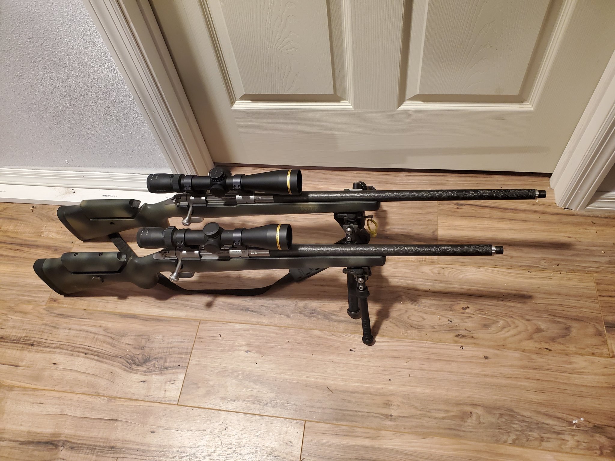

I have an Origin with 6.5 CM and 300 WSM barrels. I use the 6.5 for deer and PRS matches, and have hunted out west, and AK with the 300 WSM barrel. I like the combo and use the exact same rifle for matches and hunting, just a quick barrel and scope swap.
