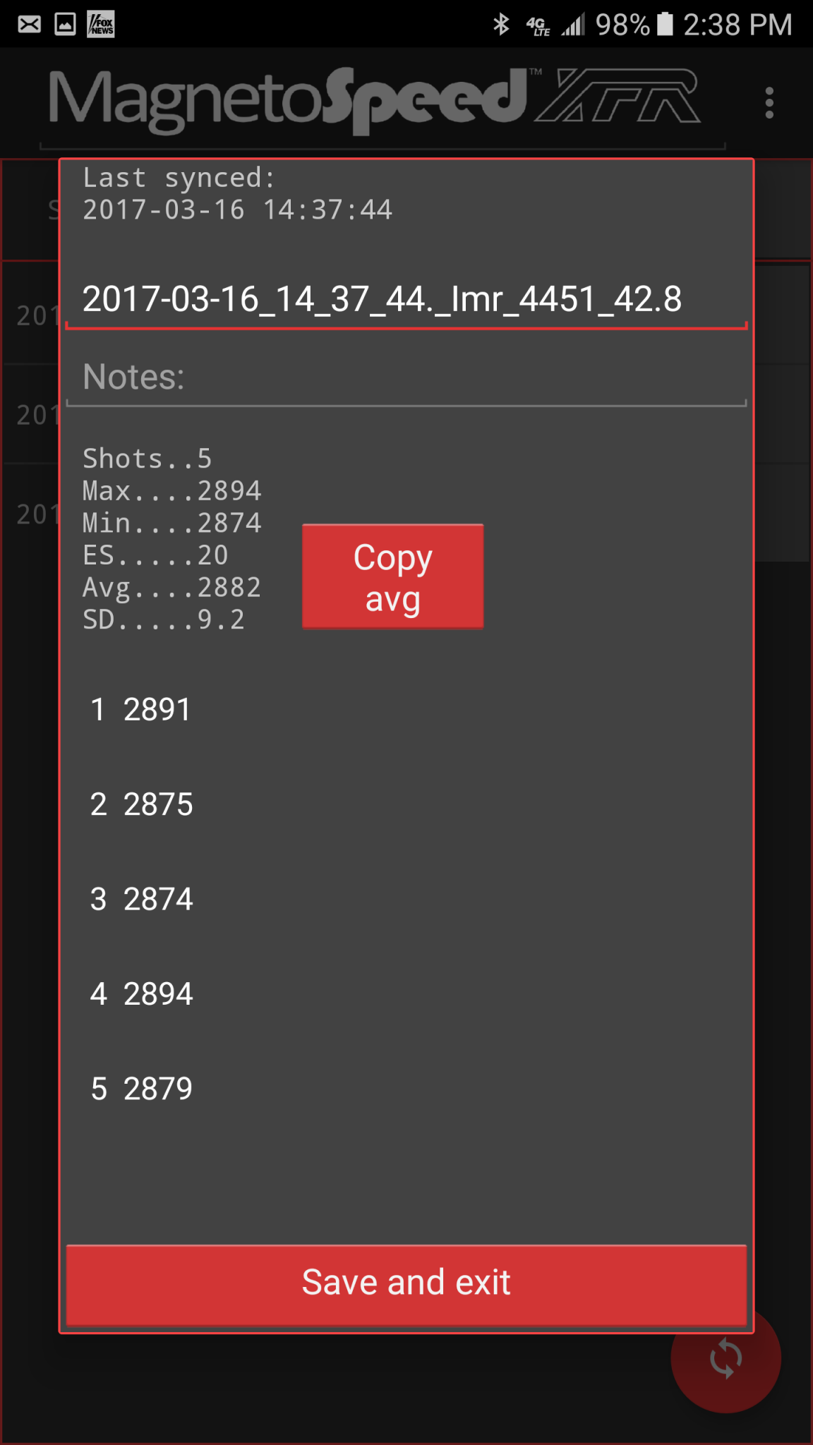

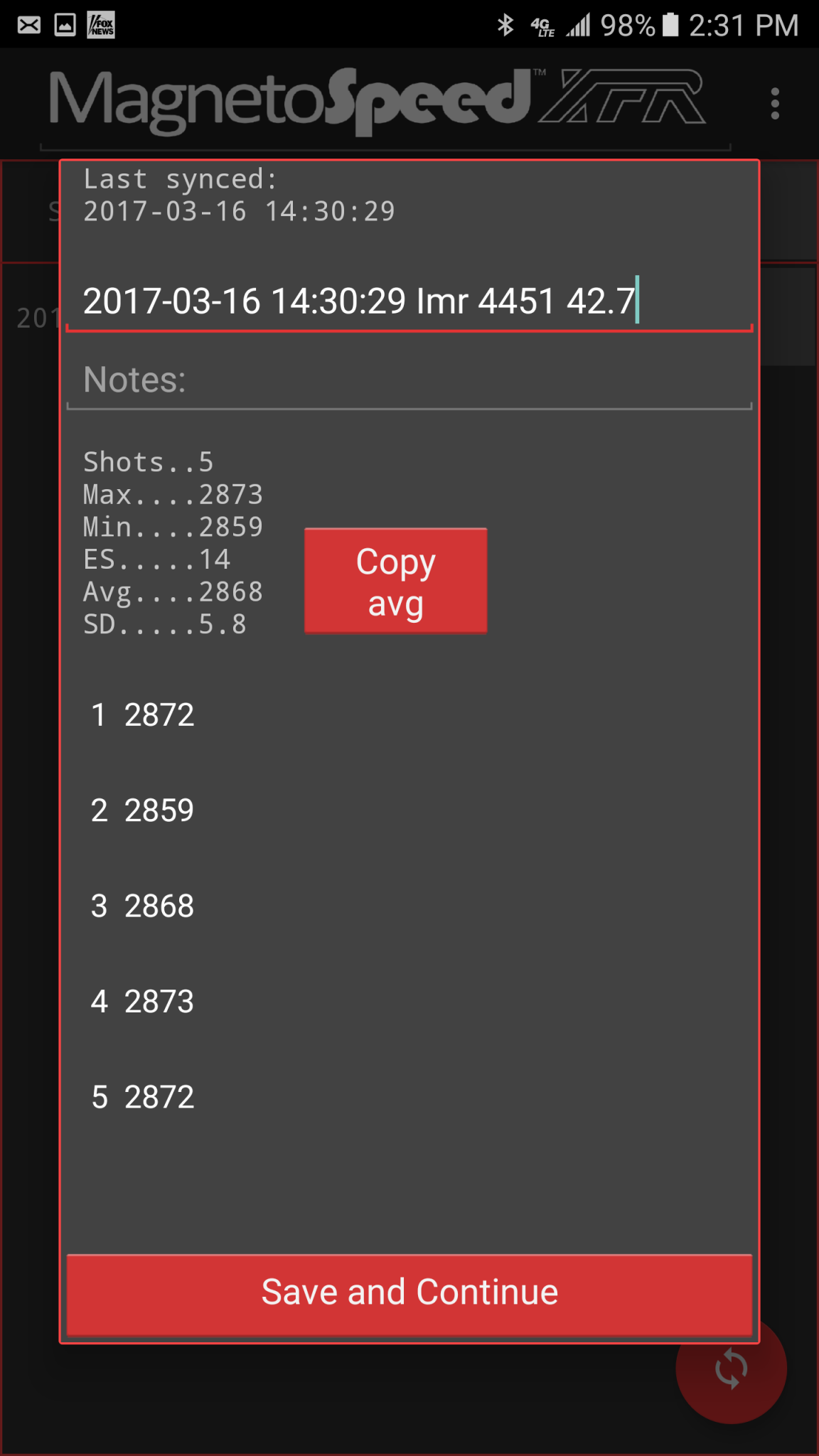

I have a 26 inch 1:8 twist barrel with a 9 inch form 1 can, the following data is with the can attached while slinging 147 ELD's with IMR 4451
This was on a load development day in 95F temps
Lower end of charge weight
Higher end
Settled on this 42.7 grain node running 2868 fps
I'm merely posting data I personally collected to provide food for thought
147's work great for me on Whitetails too, I can post relevant info on that if people are interested

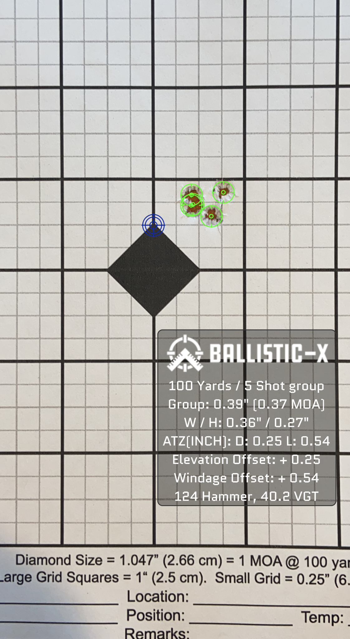

The Hammer Hunter bullets, and specifically the 124s, are amazing for the 6.5 Creedmoor. I'm getting 2900 with them out of a 20" Proof barrel, being pushed by 40.2g of Varget and no pressure signs. (Signs start at 40.7g for me.)
Super forgiving. Have shot numerous groups under half-MOA.
For my needs on deer-sized game, this makes a PRC irrelevant. And I step up from 6.5s on bigger game (elk) anyway.

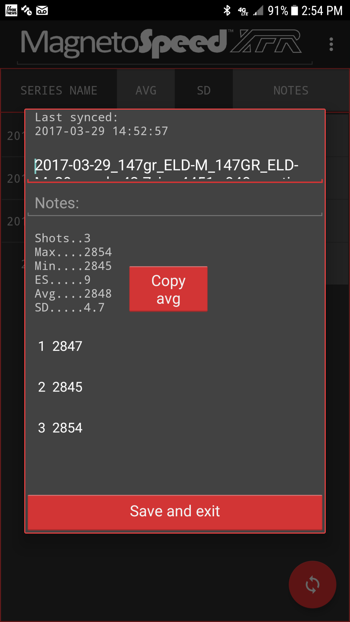

For my purposes (mainly hunting mule deer and elk), I chose the 6.5 PRC. With factory 147gr ELD-M’s, I was getting about 3,120 FPS the last time I ran them through the chrono. I was able to bag a bull elk with it this season, but it was a very close shot (around 100 yds). I’m still curious how it will perform on critters on the longer shots that are very common here in WY. Now, I loved my 6.5 CM, but for hunting, I think the PRC is gonna be my “minimum caliber”. I’ll probably get another CM for just a range/practice rifle, and will eventually step up to a bigger hunting caliber too (thinking either 28 Nosler or 300 PRC), but for now I’m really digging the 6.5 PRC!
