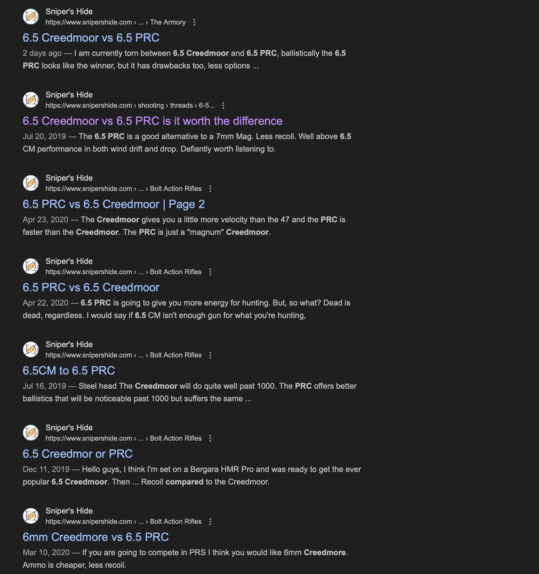

This definitely hasn't been asked before
