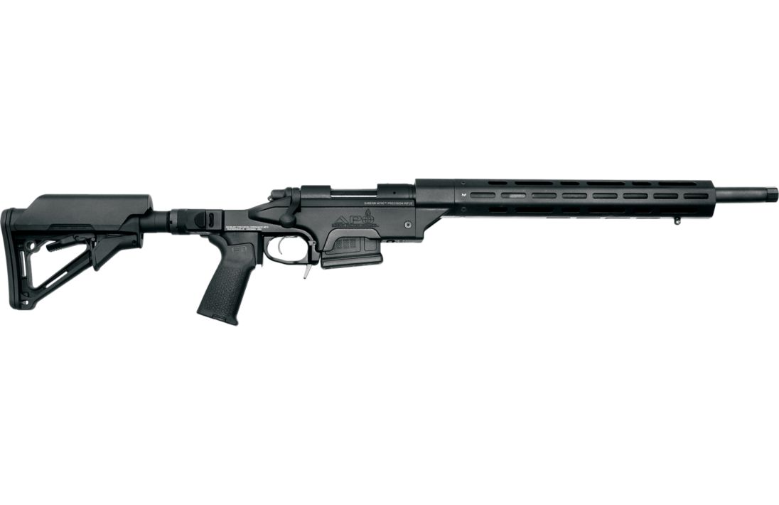

The APO summer sale ends today!! We have a few left in stock SABER M700's in .308 and 6.5CM Priced @ 755.00 plus shipping and the come with 20MOA scope base. Give the shop a call @ 434.296.8600
If youre just spoiling for a new bigger rifle this is a pretty hard to ignore deal for a creed, gets you a barreled action plus a chassis for 800 shipped if you call in TODAY

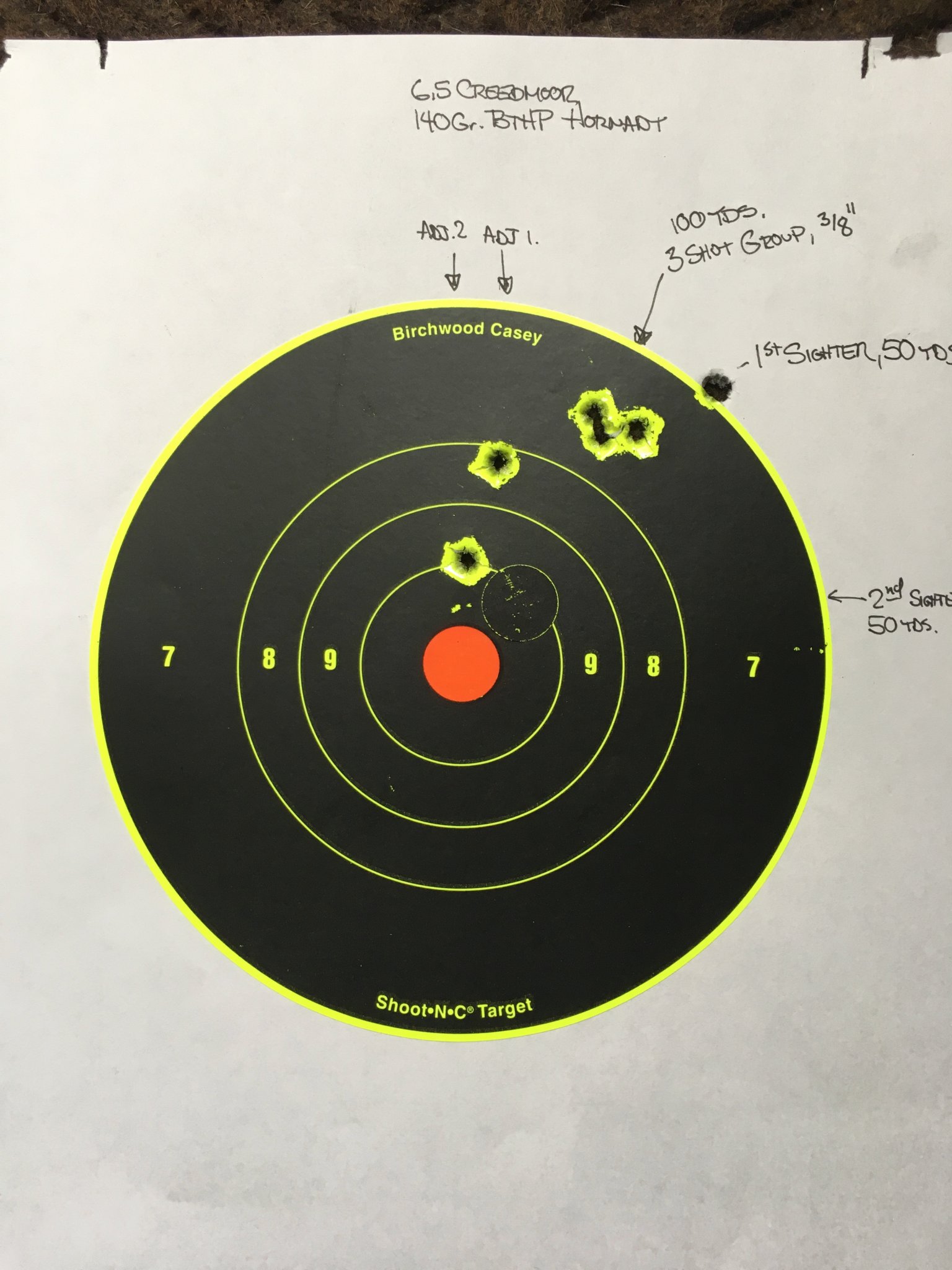

Took to the range today to sight in. 1st shot shown below after bore sighting at 50 yds.. Second shot was under the paster. Then I moved out to 100 yds and got that 3 shot group (not shooting too quickly to not heat up the barrel). That's a 3/8" group with a R700 that cost me under $200! I'm a happy camper.
The other 2 shots in the center were poorly adjusted scope adjustments where I made. Brain fart.

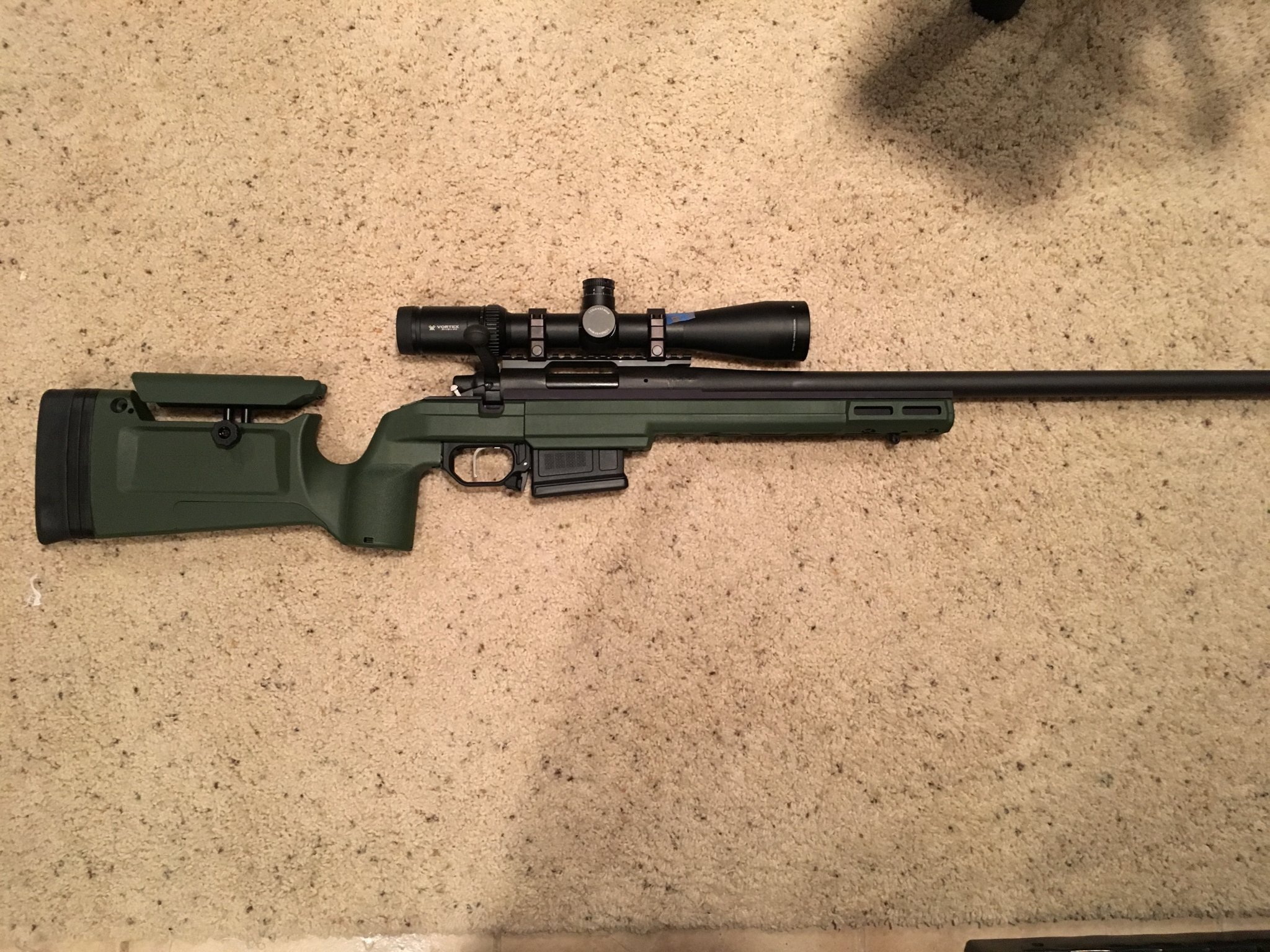

Well, got it put together. Rem 700 ADL, KRG Bravo stock, TPS base and rings, Vortex 5-15 scope (for the time being), Trigger Tech Special flat blade trigger:

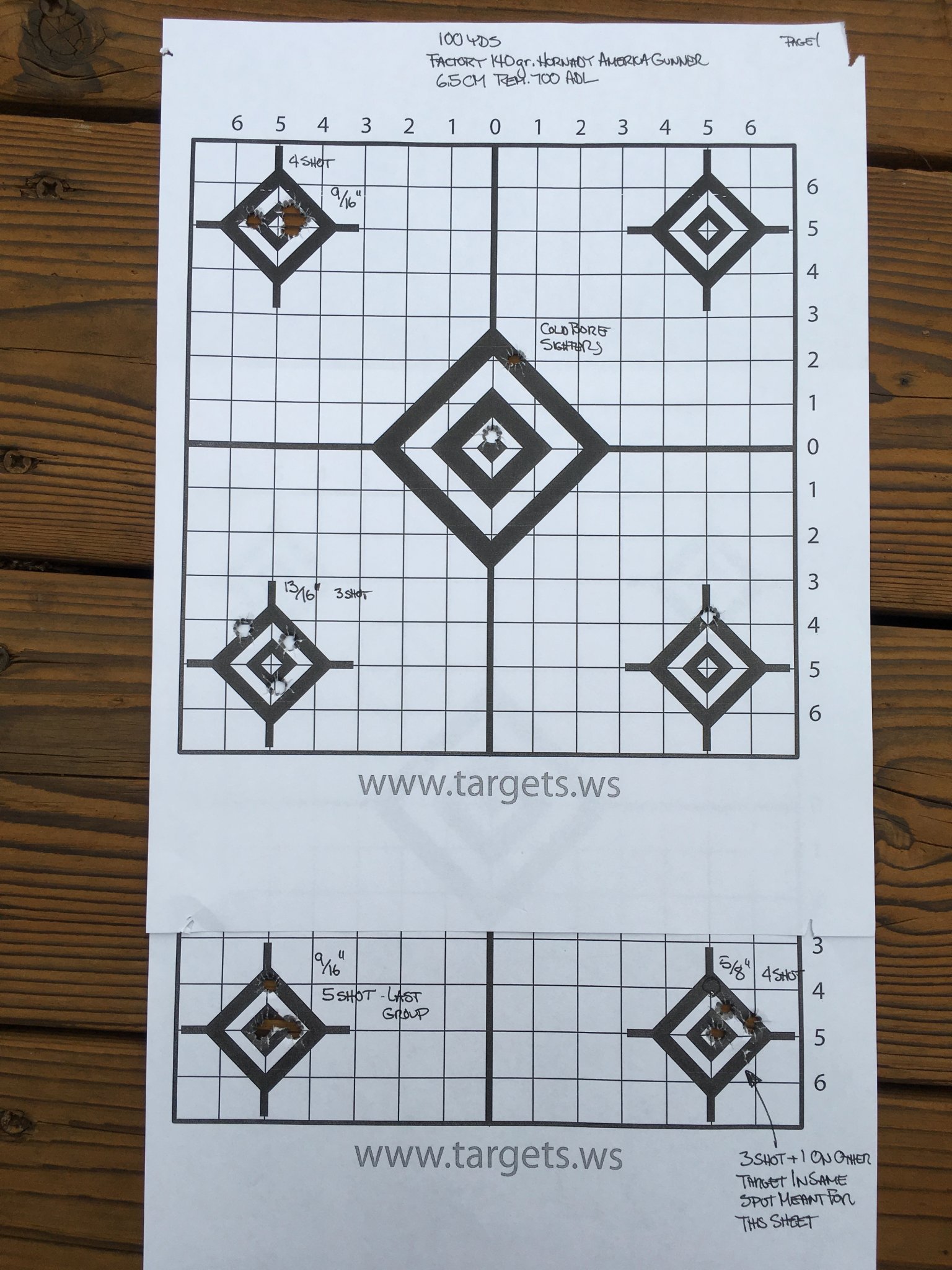

After a half dozen break in rounds, went out today to the 100 yd. range (200 yd was being used for a competition) and shot some groups with the Hornady 140 gr. American Gunner factory ammo. Averaged around 9/16" for 3 to 5 shots. Not bad for what started out as a $499 rifle with some discounts and upgrades. Couldn't be happier.
Now I need to order some Forster dies, etc. and begin reloading my once fired shells, and moving out a few hundred yards. Really liking the 6.5CM. Also, Remington looks to be producing some decent rifles.
