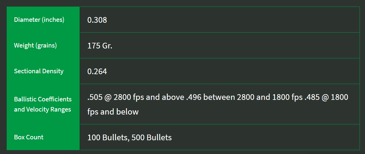

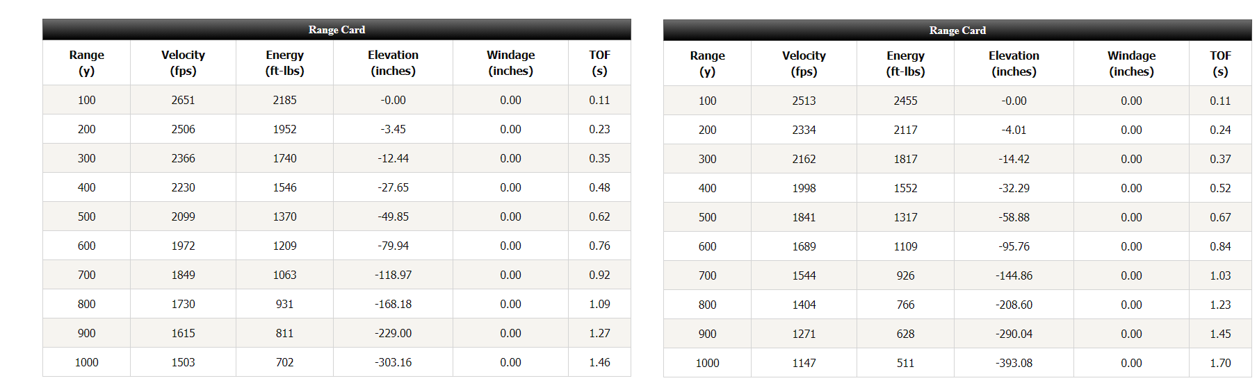

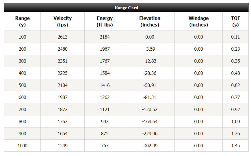

Could be an environmental difference but your 175 data ends up about 85% of the Sierra data at 2700.
Numbers like those are why I was asking for 6.5 data. That big switch between 600 and 800 yards
Not environmental. The G7 on a 175 SMK through 5 barrels has trued up to no more than .245 for me. I used .243 as the G7. Sierra lists the sectional density at .264, not the same as the G7. Their G1 is all over the place too, but assuming you use a G1 of ~.490, you should get around the same numbers.
Regardless, the 185 juggernaut is about the best bullet you can get for a 308 while maintaining a decent velocity and high BC. Even that doesn't quite hold up against a 6.5 using anything from a 130 hybrid to a 147 eld at distance.
Does that make the 308 useless or "outdated"? Hell no. It's still a great caliber, offers tons of barrel life, and has significantly more energy inside 200 yards or so.
Unfortunately I don't have a lot of gathered data from different ranges. I have the chrono data and 100 yard zero on the old scope, five or six thousand yard matches, and one match at 300 and 600 yards then back to 1000. The old scope was an older Tasco World Class with an 1/8 minute per click and no zero stop. The elevation knob went about a quarter rotation at the bottom after the reticle bottomed out. So I didn't shoot it much. New scope this summer but lack of local matches, so just a 100 yard zero for now. First match was get the 100 yard zero with m118lr then shoot a long range match at Quantico. Using the chrono and Sierra software I was low left in the 8 ring at 1k. I should digout the 300 and 600 zero and see how it aligns with the software.
