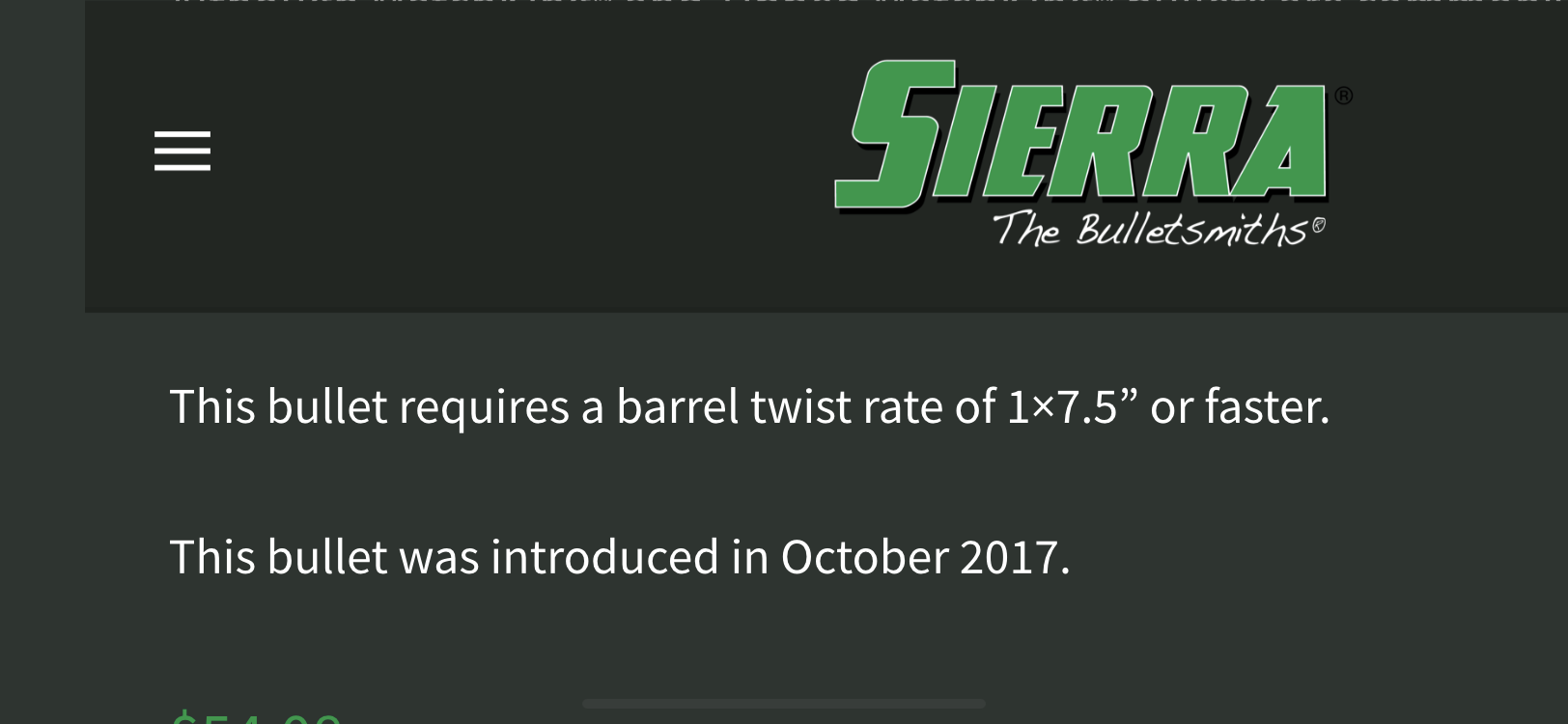

I can’t speak to the 150 as I’ve never shot it, but 1:7.5 is a very populist twist for the heaviest of heavies. Sierra recommends 7.5 twist for that bullet per their website.
