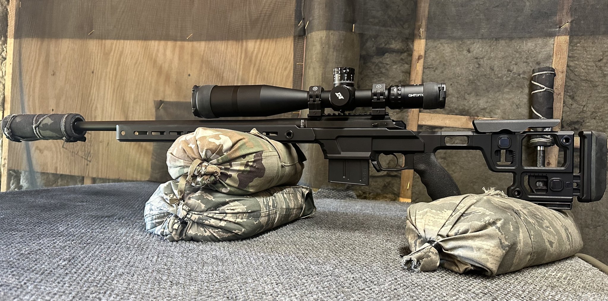

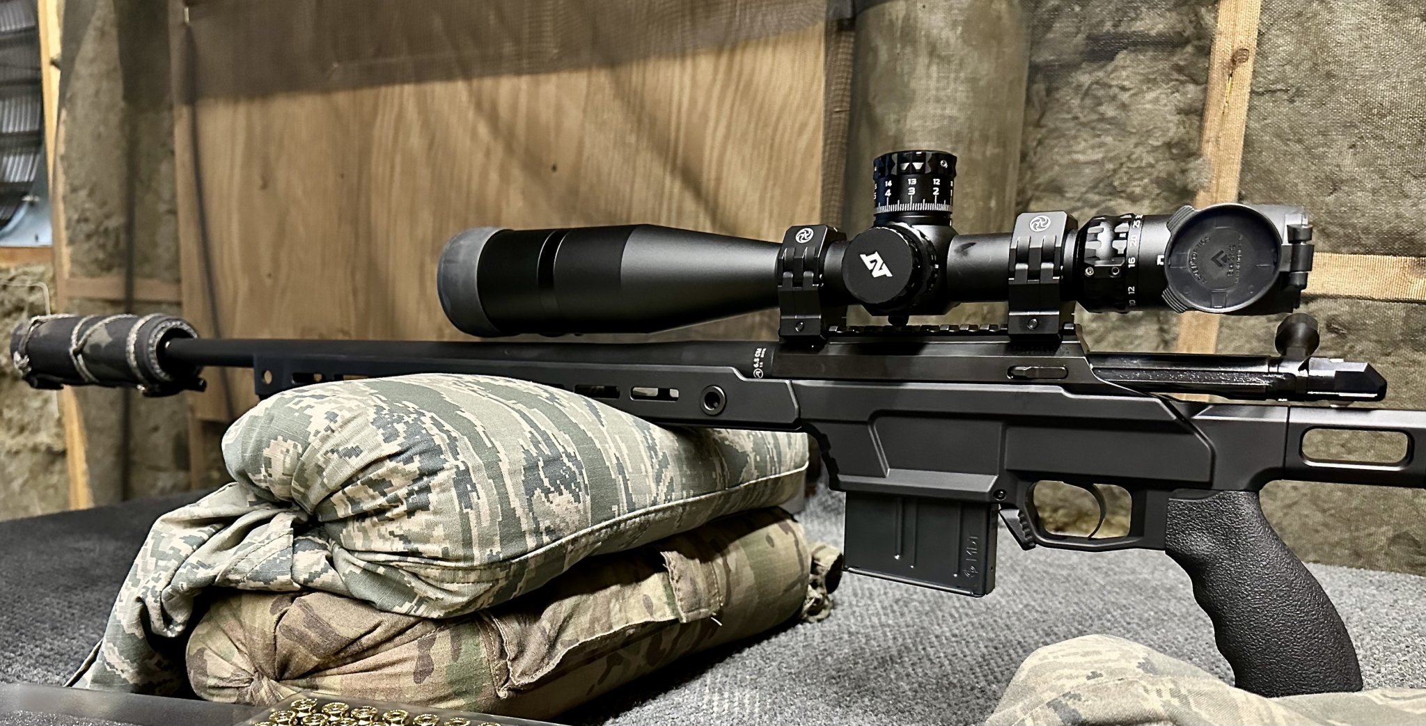

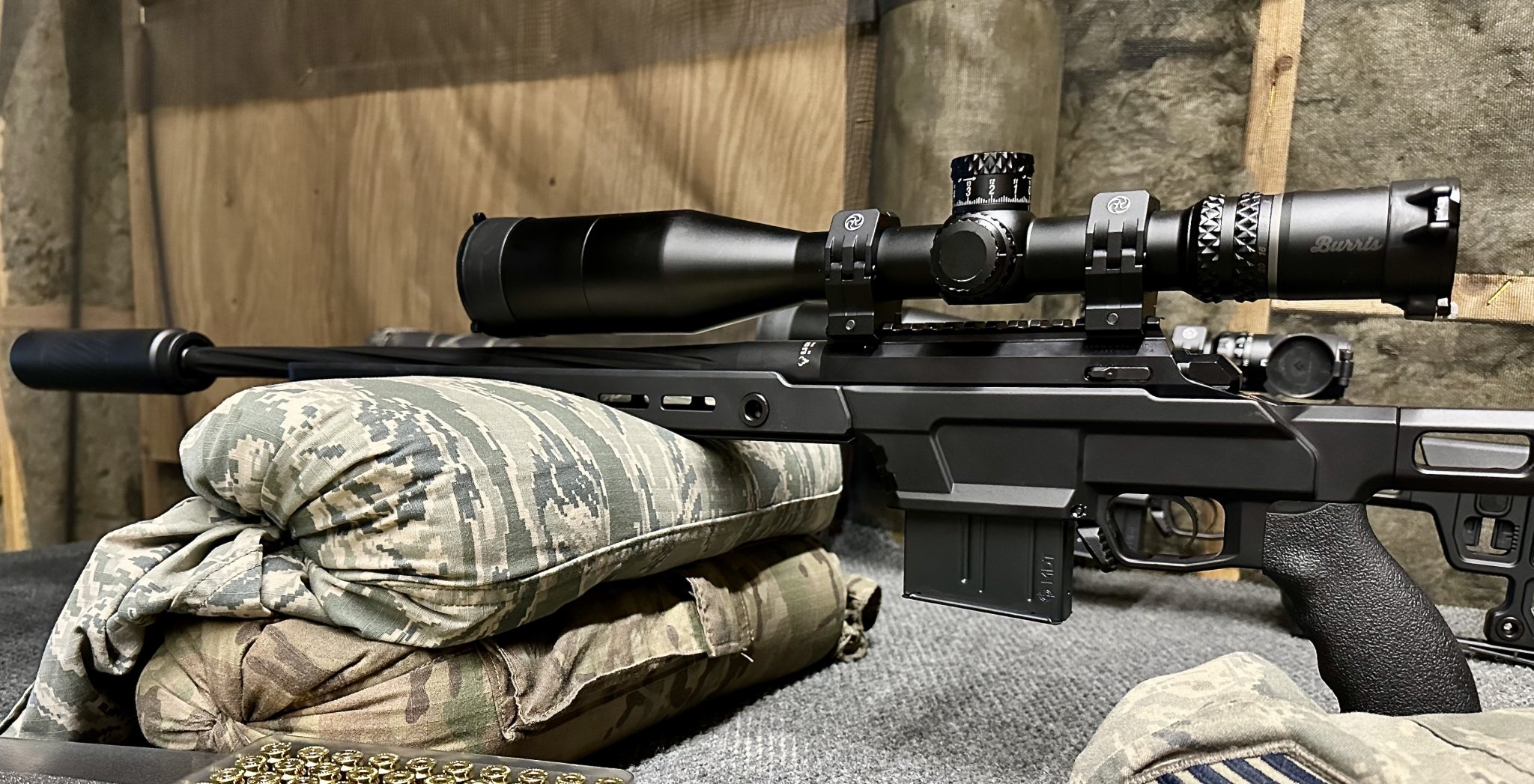

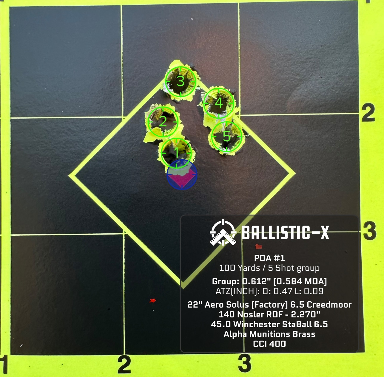

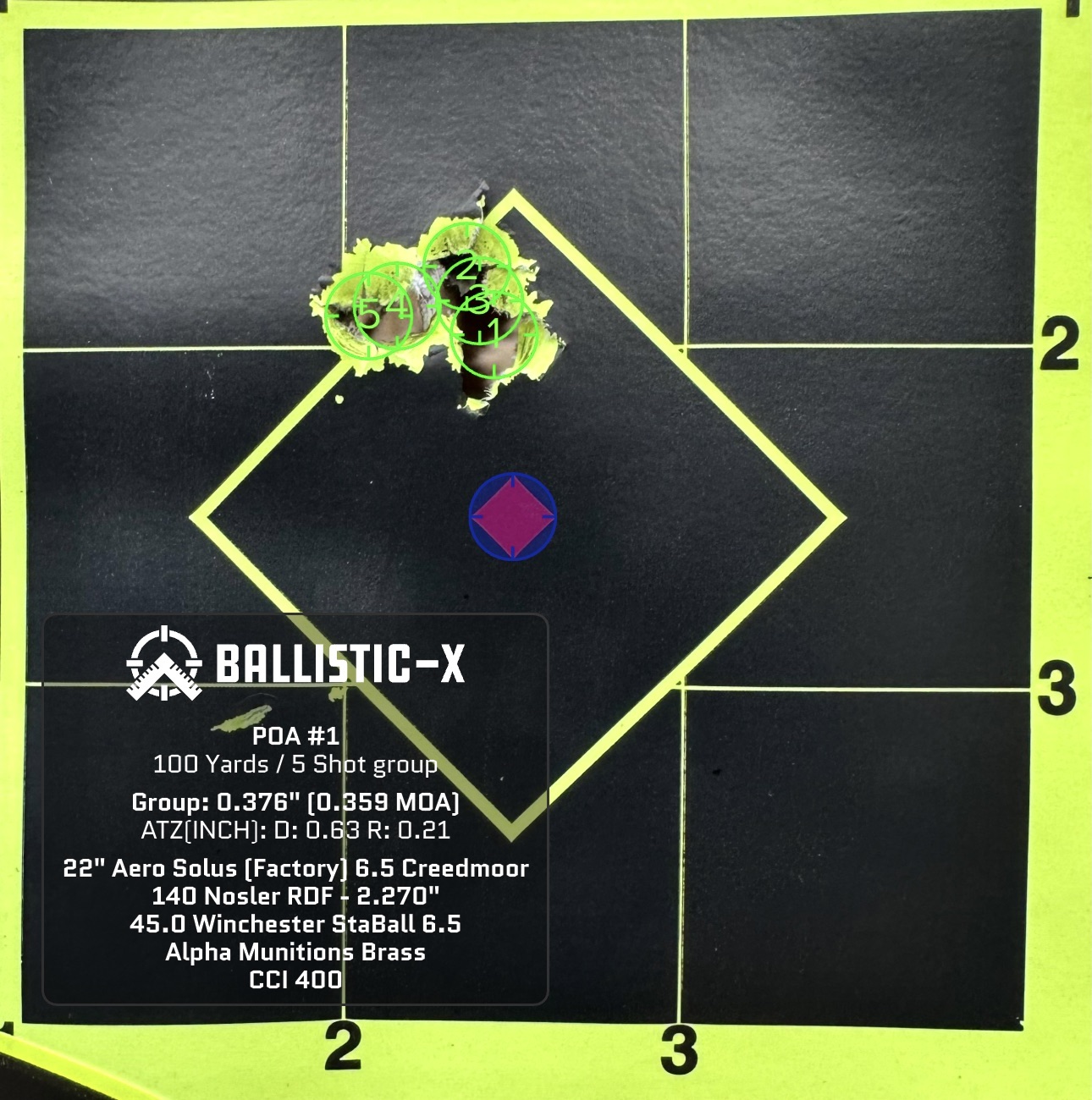

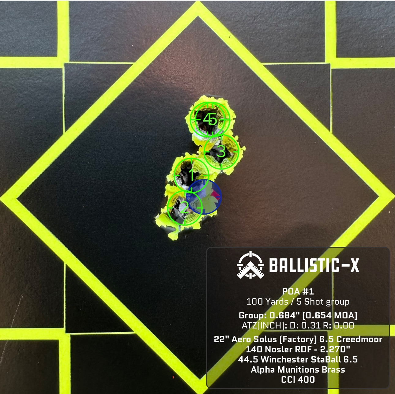

Mine is impressing me for a factory rifle... And this is with minimal load development with only 50 rounds down the barrel.
IMG_2896.jpegimage_cropper_E63E8D2E-E491-48B7-95AE-32A770A9E241-9319-00000841E4E46FEA.jpegimage_cropper_A6CED177-0686-49D6-A413-D0666AE7A4B7-9319-00000842E8D9FB06.jpegimage_cropper_CEF2CC21-7313-4FFF-9DAD-07ABFE8F7722-9319-000008442B708E88.jpegimage_cropper_A41811B1-BC45-4AA4-AC25-75897FFB39EA-9319-00000845227E743B.jpegimage_cropper_1161E4DE-0874-4CE5-8B0C-1DFF4BB95D26-9319-0000084607102E13.jpeg

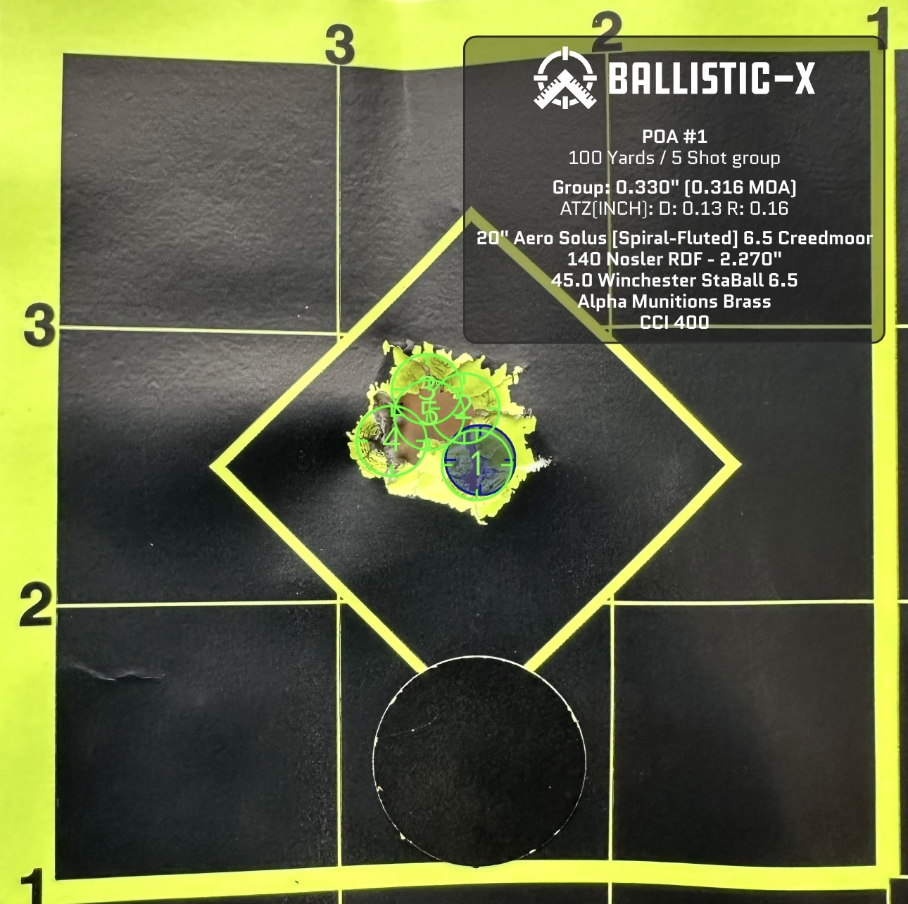

Here's 2 good places to order from. Price is about the same across the board at all the well-known reputable retailers I could find...
OR... You could get this, drop a TriggerTech Special in it, and put it in the stock or chassis of your choice, since it uses a Remington 700 footprint.

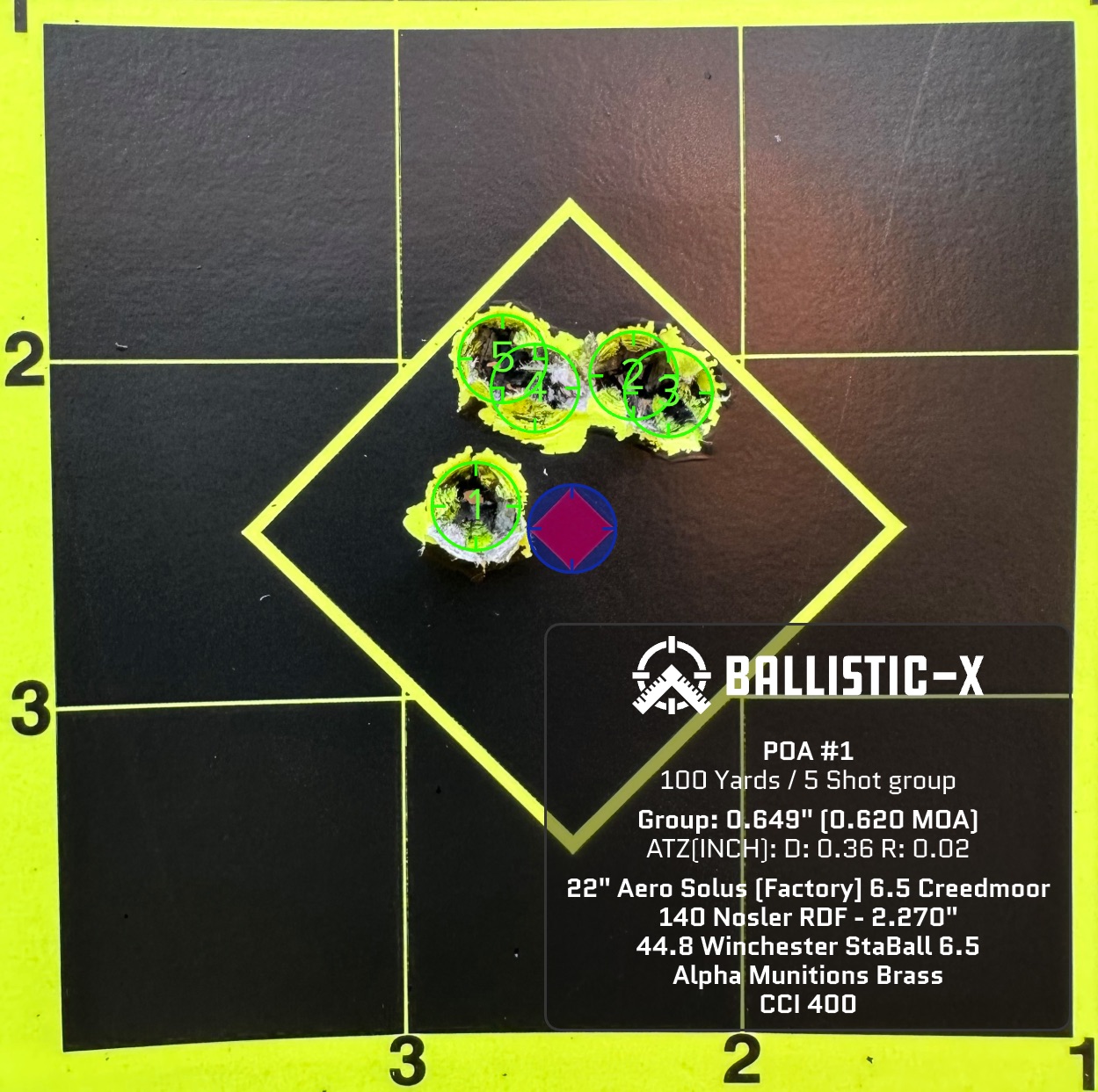

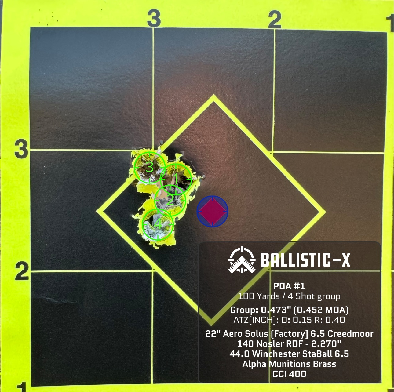

Here's 2 groups from Friday with both of my Solus 6.5CM rifles with factory Aero barrels on them...Shooting the same exact load. I think I've cracked the code.
22" Sendero / Nosler 140 RDF @ 2,834 FPS MV
IMG_4108.jpegimage_cropper_A37B4D72-FBE0-4C20-9915-9CD8482862F6-15323-00000CF6782841B5.jpeg
20" Sendero-Light (spiral-fluted) / Nosler 140 RDF @ 2,780 FPS MV
IMG_4110.jpegimage_cropper_6F9908FD-0B59-467C-ABEF-81B0F1658A83-15323-00000CF398D5C24D.jpeg
