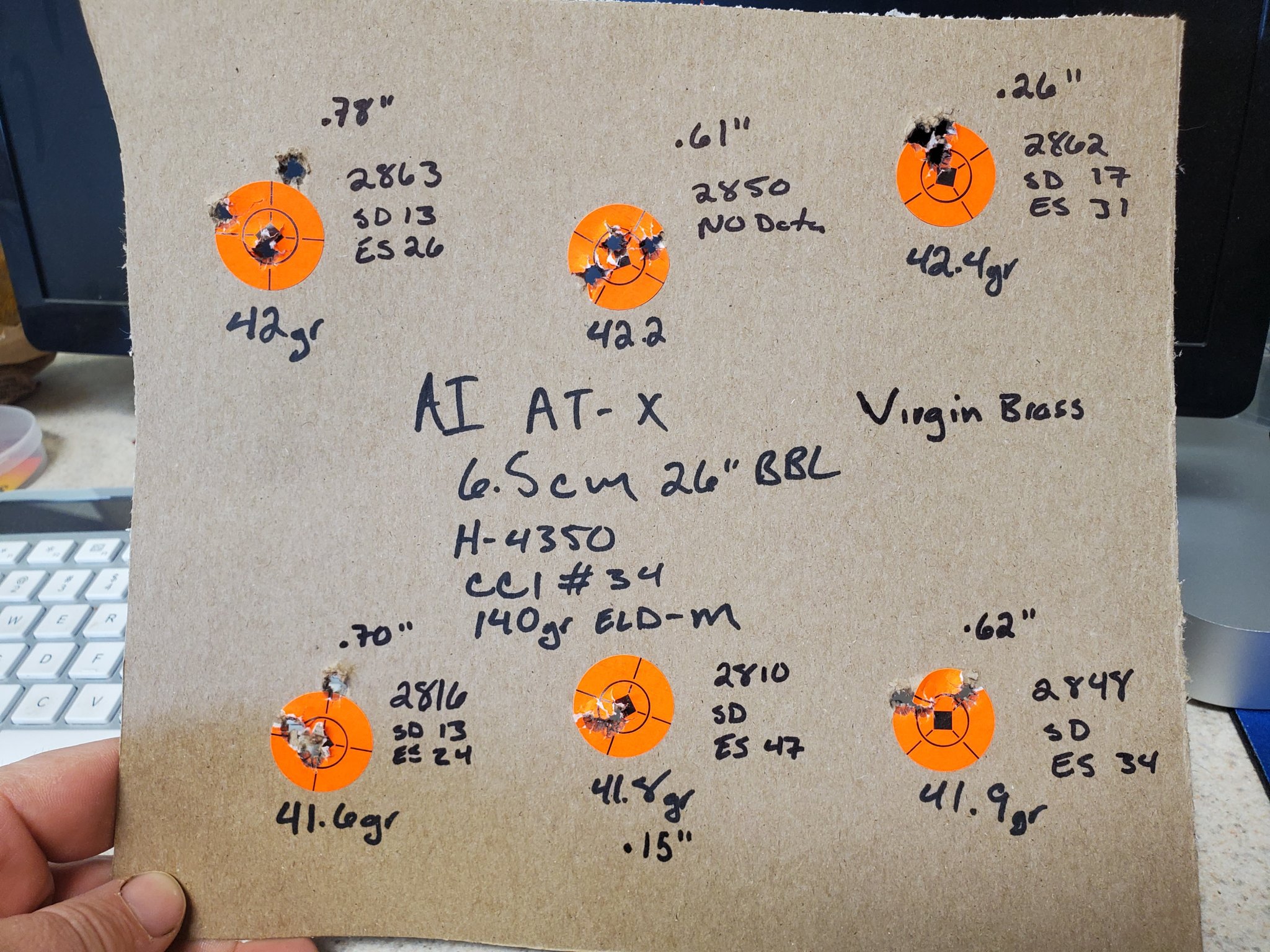

I bought a Tikka T3X Tact A1 6.5 Creedmoor but the weather has been so bad, I haven't shot it yet. I loaded up some 140 ELDM and 143 ELDX. This will primarily be a target rifle rather than hunting rig. Is there a clear choice between the two bullets I loaded up or is there something even better? My mission is to hit 1,000 yards this summer.
No problem. In the middle of doing a load development for a new barrel and between the rain and storms it's taking too long. Haven't been able to get my SD and ES numbers where I want with the CCI 34's but the accuracy is there. So going to play around one more time before I give up since I have a few bricks to get rid of.
Reactions: LanceHighcountry
Bergers tend to be the gold standard, but 140 ELDM are very good and used by top shooters.
I'm not a top shooter, but do weekly 1000 yard shoots. The bullet ain't the issue, that damn wind is! (Or my inability to read it)
Using 140 Eldms......
I have the same rifle. I had trouble getting bullets last year and ended up with Lapua Scenar-L 136. They have been consistent and shoot far better than I do, getting SD of around 6 with 40.9g H4350, but on the slow side at 2660fps. There were pressure signs as I moved into the 41.5 range without a significant gain in speed.
The 140 ELDM seems to be a faster bullet. Another shooter in my squad yesterday was using them and did very well. At 1,000 his adjustment was 1 mil less than mine.
