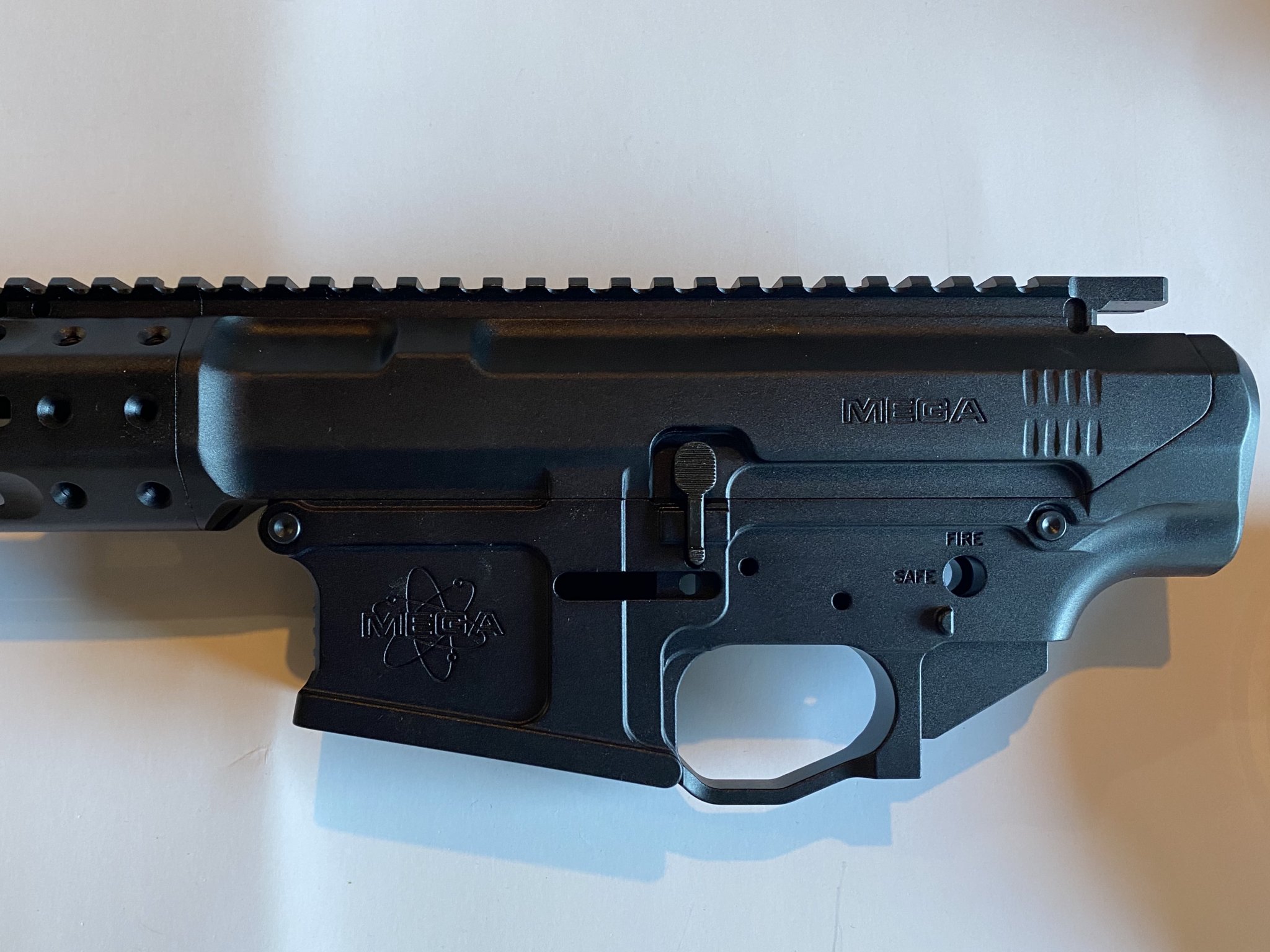

I could’ve sworn Noveske only sold their small frame receivers separate from full rifles. I was looking this up the other day but maybe I missed them. I’d be inclined to choose the Noveske given your two options. The Aero doesn’t suck. If you can find a Mega at a good deal, I would recommend picking it up.

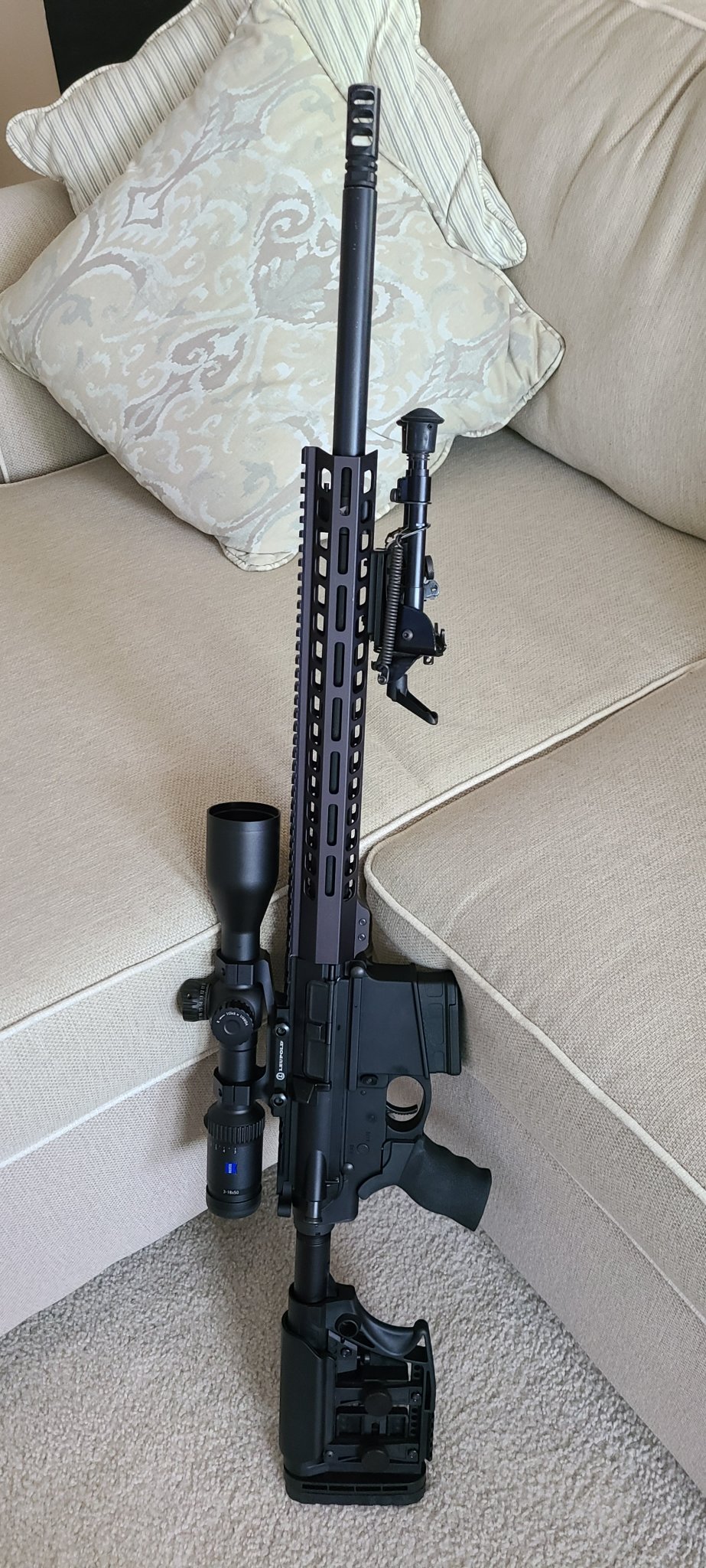

22" Aero barrel
Hypertouch trigger
44 drill bit,
SLR adjustable gas block
PSA upper / lower
Luth
Zeiss V6
Toolcraft bolt.
Runs like a Rolex
