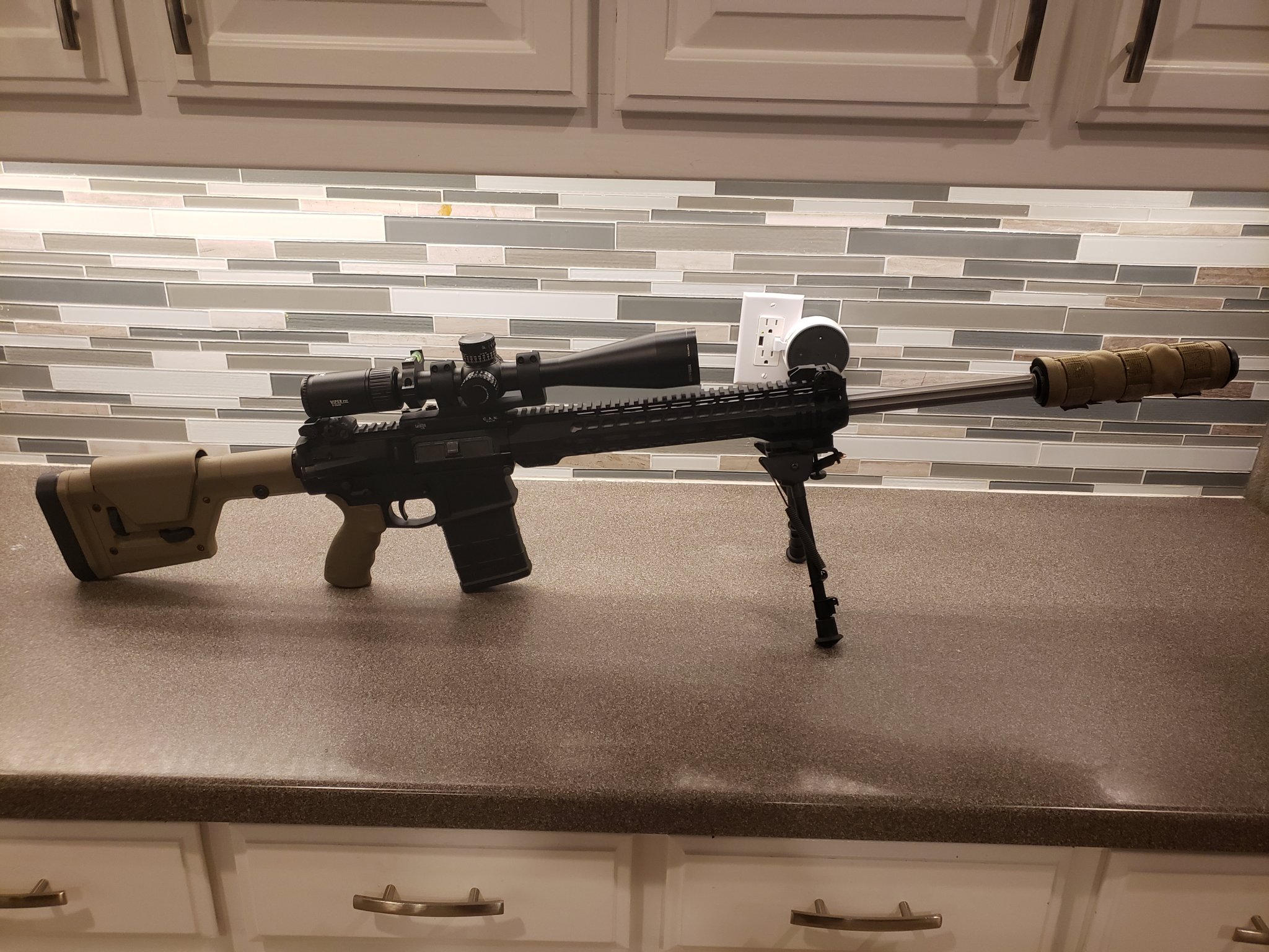

Well, that's a little difficult to assess. The 22 inch is a non-fluted, heavy barrel with a .936 gas block journal. The 18 inch fluted barrel is also considered a heavy profile, but with a .875 gas block journal. To complicate matters, the rifles I've got them mounted on are built quite different. The 22 inch is mounted in a Mega Arms MKM set with a mega extended rail and a Magpul PRS stock. The 18 inch is mounted in a Aero Precision receiver set with a 15 inch key mod enhanced rail using a Magpul UBR gen 2 stock. The 18 inch rifle is much more carry friendly without a doubt. I haven't shot much with the 18 inch to see how well it holds up to long strings of fire, but the 22 inch does really well with long strings and I don't see the groups opening up.
This pic is when I had the SLR handguard.

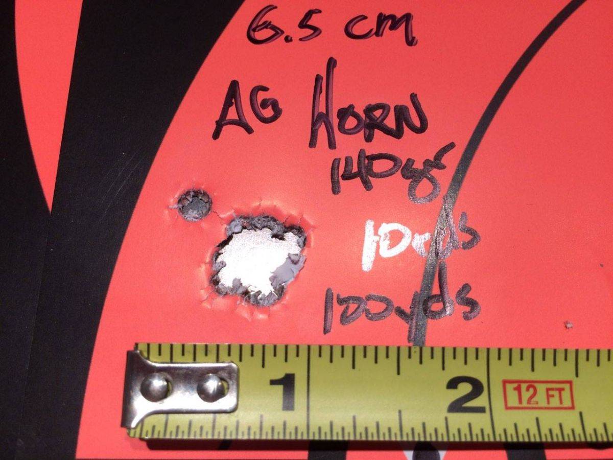

Criterion 22" Hybrid Nitrated SS... a little more then your budget, but... ( And I flubbed the flyer... rookie move. )
Full disclosure... upper receiver face lapped "true" , barrel Loctited in, Adj. GB ( SLR ) 9.3oz 308 rifle buffer, Tubbs 308 flatwire recoil spring, Lantac Muzzle Brake.
Fired off the bench, scoped , bagged front and rear

Have you had a chance to get behind the 18" gun? I plan on running a 18" gun. I am going a different route. I don't want a barrel over 20"
Yes, I've been extremely happy with the 18 inch barrel. It shoots about the same as my 22 inch barreled rifle. Note, I didn't do a dedicated load development for it, just shot the same load that I developed in the 22 inch. I haven't noticed any issues other than my ammo needs to be reloaded more often because I'm shooting more... lol

That’s cool can’t wait to get my setup going. What glass are you using? I saw your setup didn’t have a chance to look at everything though. Just curious what gr bullet are you shooting
I'm current'y using a Vortex PST Gen 2 3-15x44 FFP mrad on the 18 inch 6.5 CM rifle. Shooting the Hornady 140 BTHP using handloaded ammo.
