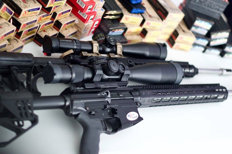

Shooting submoa in my gasser, 22" krieger/mega build
