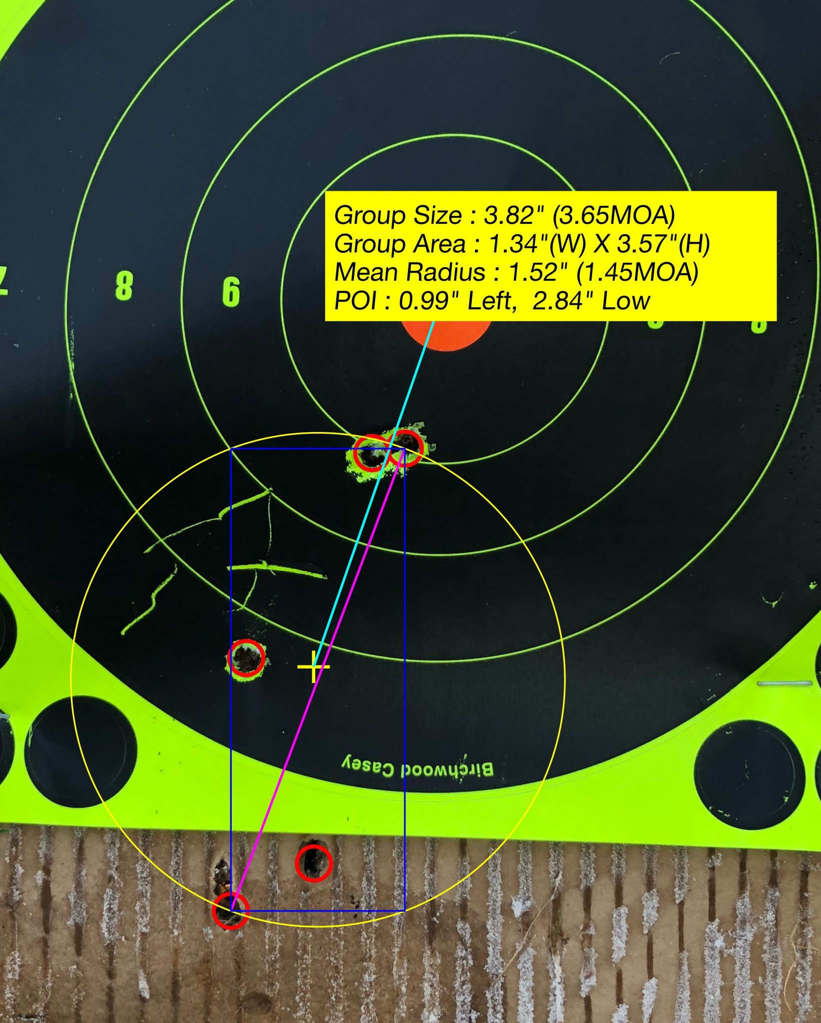

I've done some initial development with the Flatlines. Rifle is a stock Savage 10BA Stealth with AAC SDN-6 can. It shoots a solid 0.5 - 0.6moa with factory Hornady 140g ELD Match.
Here's my data so far on the Flatlines:
Ladder Test with H4895:
Lapua brass
CCI BR4 primers
Loaded .030 off lands
38.0 g - 2,960 fps
38.2 - 3,024
38.4 - 3,042
38.6 - 3,054
38.8 - 3,090
39.0 - 3,087
39.2 - 3,093
39.4 - 3,105
39.6 - 3,115
39.8 - 3,124
There was a node around 39.0g so that's where I loaded in order to play with seating depth. Things were looking good so far...
Warner recommends seating .025 max but based on my ladder test I loaded .030 and .020. Group results are below - shot at 200 yards.

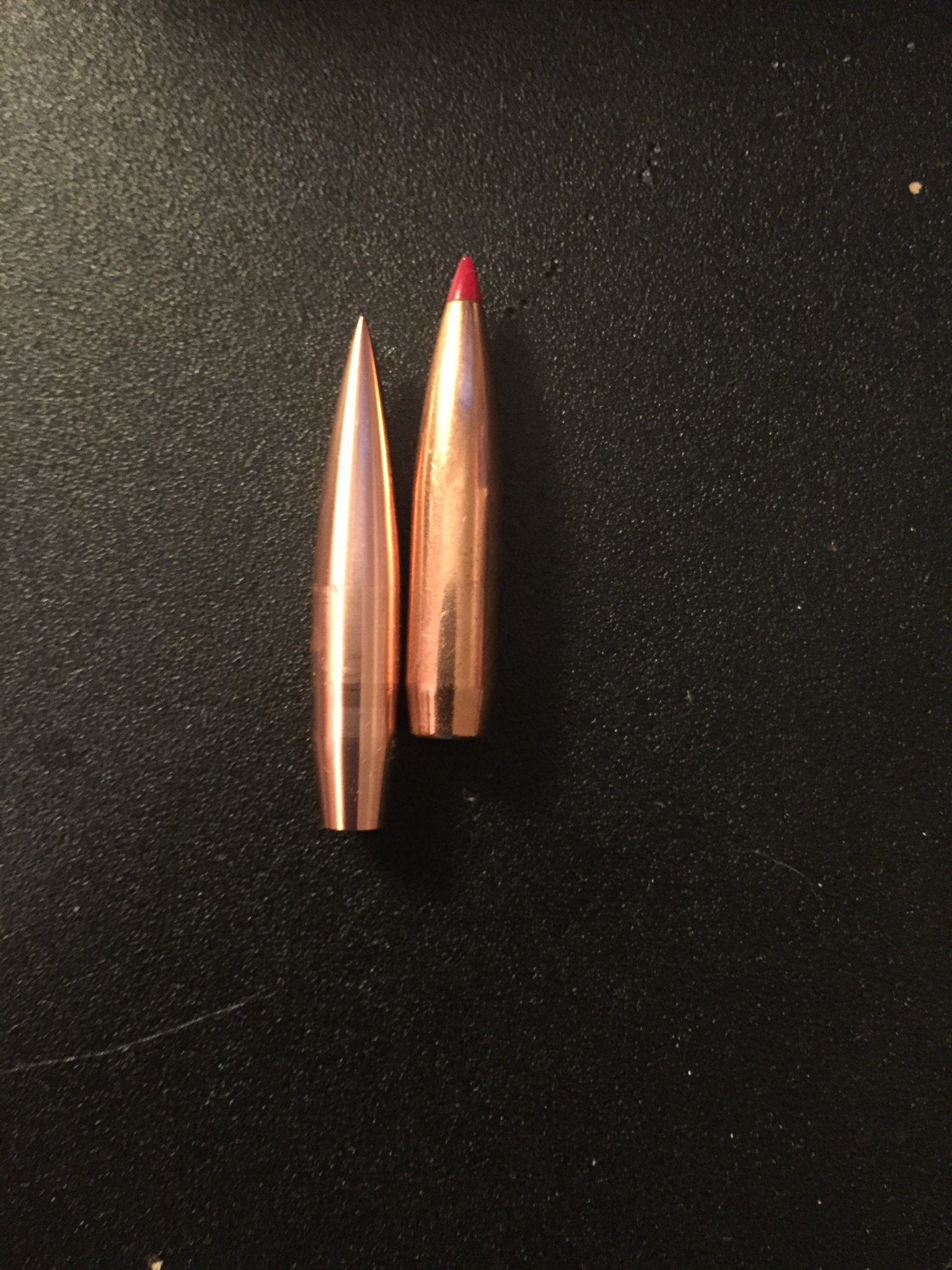

Mine are literally dropping .4” into the case before stopping. Is this normal for this bullet? Case size is fine.
Set your calipers to 0.263", run in the lock screw, and put the base of a bullet through the gap. That will be illuminating for you more than the internet can ever be.
Yes - normal. From my experience a factory rifle is going to have quite a bit of freebore, so I'm not surprised so little of the bearing surface is actually seated in the case in my instance. Part of why I'm curious to try jumping these a little more.
In any case, what I'm trying to do with these through a factory Savage is akin to putting race fuel in a Honda and expecting to get a race car out of it, but I thought it would be a fun experiment.
It still shows the bullet not reaching .264 until .4” from the base! I’m just looking to make sure this is the norm for these bullets and that I didn’t somehow get something out of spec!
I am pushing them through a criterion. Not super high end but not a Honda!!

A huge step up in barrel quality (this was still a prefit barrel), but shot like crap. Based on some of the recent feedback in this thread we'll try seating deeper and see what happens.
So everything I tried shot like crap. I got pissed and decided to get creative and loaded a few to single feed and sit .020 off. Mind you they were only seated about .005 into the case. I put a small crimp on them just to secure them a bit more. Well they didn’t shoot great but .9” was much better than the 2.5” I was getting. This was with 45gr of RL17. It was def hot at 3185fps and a little heavy bolt so I’d advise to test your own and work up. I think I’ll make another tweak and hope these will get me to a mile next month when I get the chance. Do we think I should try seated .005 in the case without the crimp or am I asking for dented brass?
Mine shot like crap in 3 different barrels, one being a cut barrel. best repeatable groups was .75 at .060” off the lands. but groups went to crap at long range. I plan on building a 6.5s.s., So I’ll keep the rest of mine to see if they have to run 3300-3400 to work in my setups. This is with a creedmoor running speeds inline with Warner’s loads. G/L with the 121. I’ve shot the 180g 30 cal and 256 338 with excellent results.
