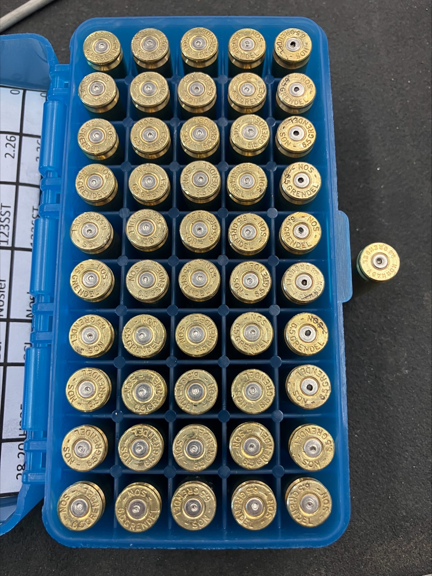

I have a load that I've been using for over a year. Hornady 123g SST, Nosler, CCI 400 primers and 28.2g of H335 at 2.255 COAL. Last time I used the chronograph was in January about 50f and they averaged 2455. Primers were flat but no piercing. Ran the chrono again to verify and build data but out of 60 fired cartridges I had 11 pierced primers and an starting to get extractor imprints on the cases. Yesterday was about 87f. Velocities in Jan averaged 2424 and yesterday average was 2510. Disassembled the gun and started checking things. BCG and 20" fluted barrel are Faxon. Found the firing pin stick out was .046" and it seems the spec is .028" to .036". Also, measured the bolt face setback and found its .140" for which the usual measurement is .136". I don't see how wear would change that measurement, probably machined that way. I removed the firing pin, took .011" off and reprofiled the ball end on the lathe. Ended up with .0345" of stick out and fired a primed case with no powder or projectile and it fires no problem. Ordering a new firing pin but need it to work for now. So, a lot going on there but what's the opinion on the change? I know I was up there on pressure but Am I just passing the pressure limit due to the temperature? I have no reference how temperature stable H335 is. Should I just lower the charge to where its back to 2425 or so average?

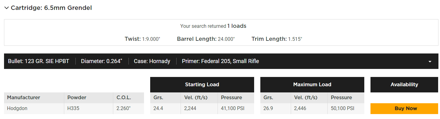

The H335 book maximum from Hodgdon is 26.9 gr with a 123 gr bullet.
Like @6.5SH said, the Hodgdon site with a Sierra 123 grain shows a max of 26.9 grains.
The Hornady 11th shows the 123 SST at a max of 26.4 and only doing 2300 fps out of an 18" bbl.
By all accounts, I would re-think your 28.2 since you are roughly 2 grains over book max territory.

I had two different range trips in the warmer months with only flatter primers. This trip was the first with primer piercing.

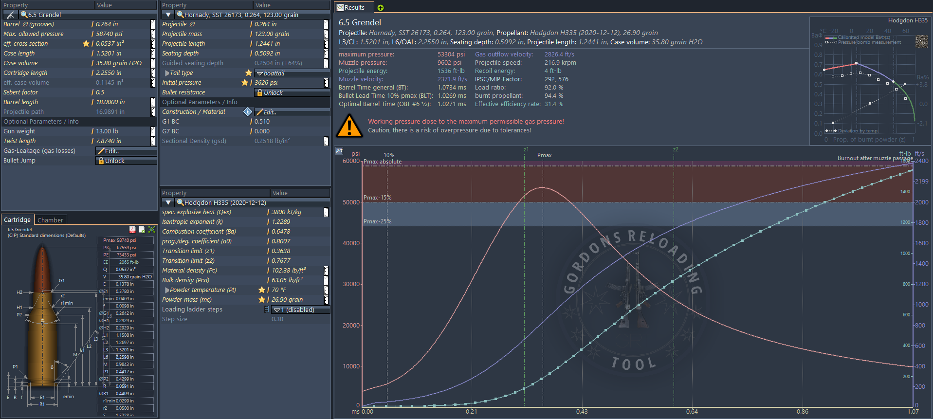

Here is a generic 18in 6.5 Grendel with the Hodgdon web site max load. Estimates about 53.3 ksi going about 2372 fps.

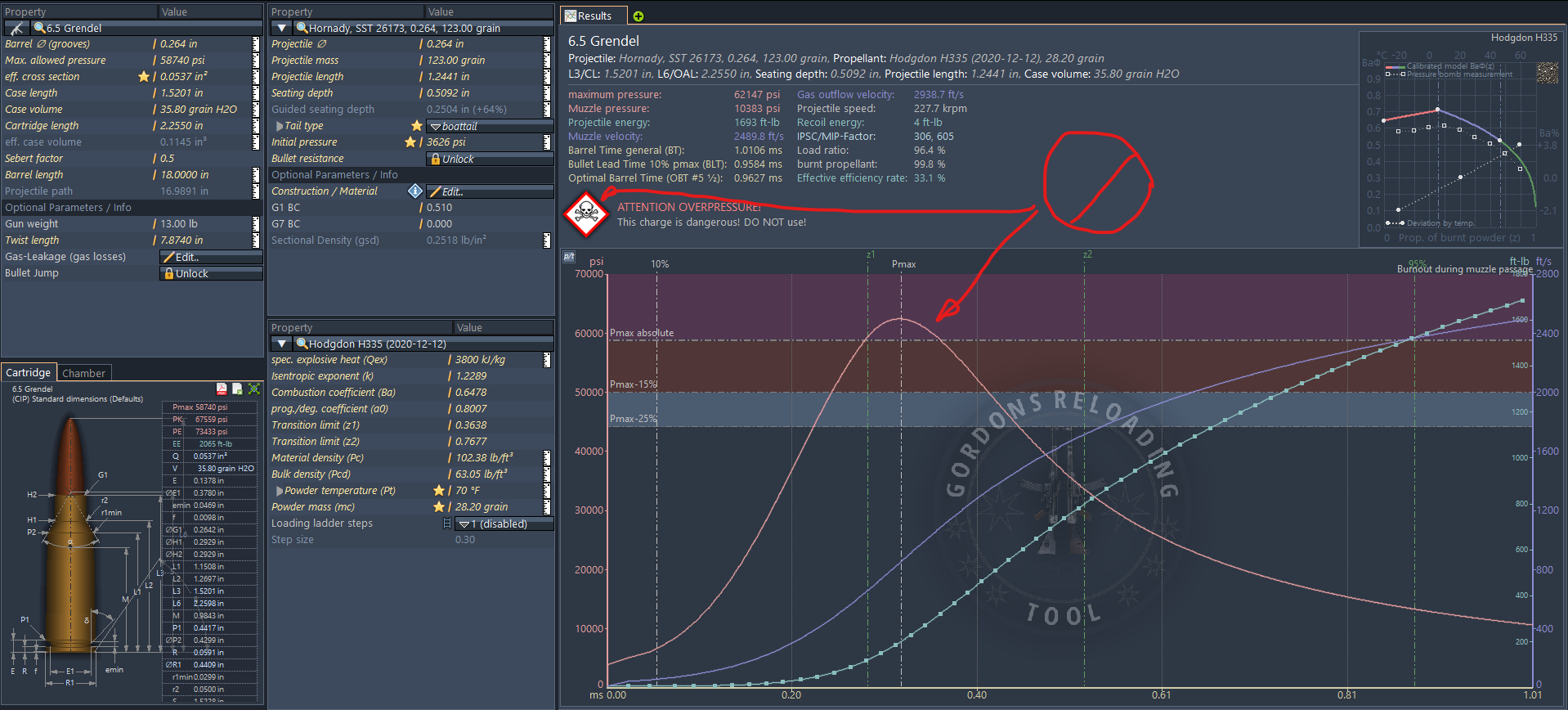

Here is the above but with your 28.2 grains H335. Estimates 62.1 ksi going about 2500 fps.

That program is amazingly detailed! The velocities are awfully close to what the chrono says for 28.2. My last velocity string showed lower velocities than your program does though. I have a 20" barrel and I was getting 2352 avg for 27.1 of H335. I'm going to have to back it down to safe levels to get me through the next few weeks and hope that will give me decent accuracy and a velocity I can deal with. After that I may consider working up the Sierra 107 MK's as Hornady jumps from 100 grain to 120. Thanks for some great input.
