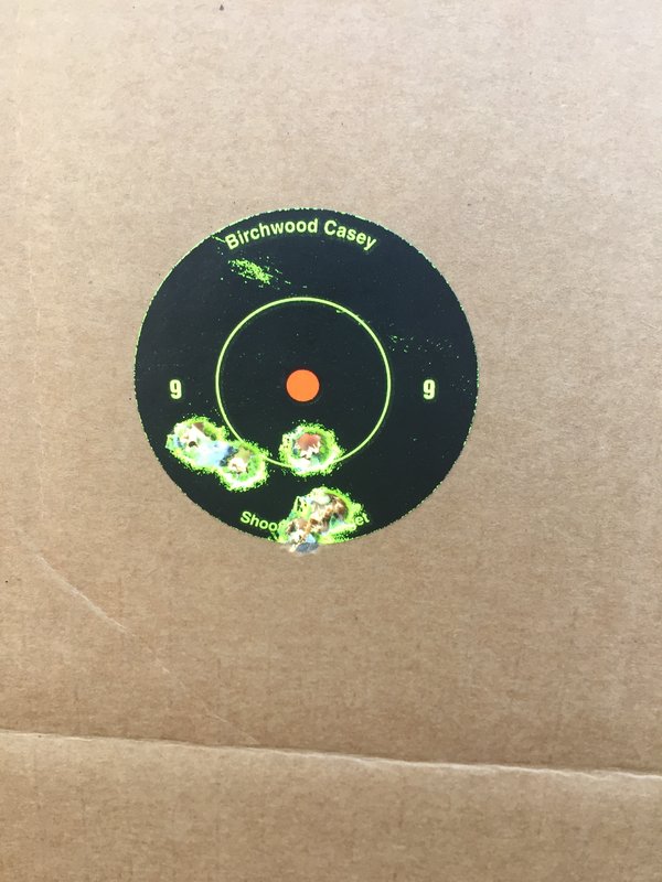

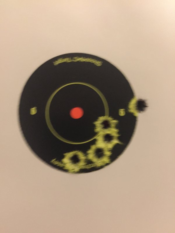

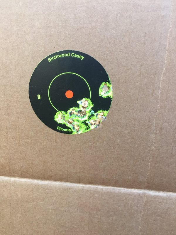

This was with a 20” Faxon. I’m still trying to learn how to drive a gas gun.
